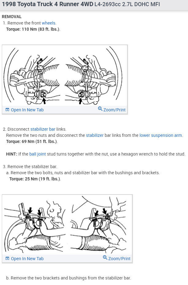

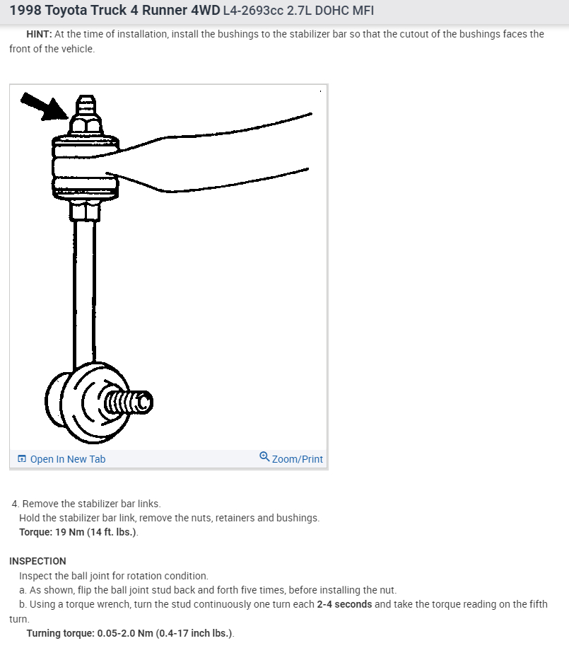

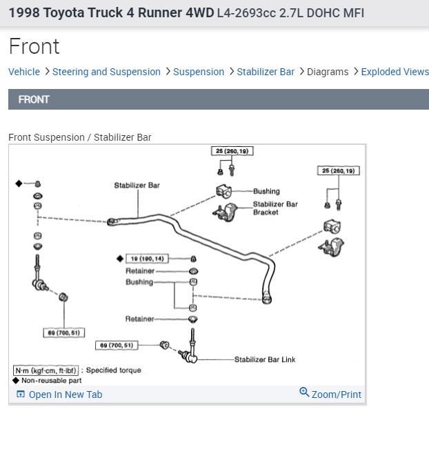

It sounds like you have worn or broken suspension component(s). Which is triggering this issue.
It could be due to broken sway bar link(s).
Do an inspection of the suspension. Look for any damaged components. You can also use a pry bar to check for excessive movement on any of the bushings.
Thank you.
https://www.2carpros.com/articles/popping-noise
