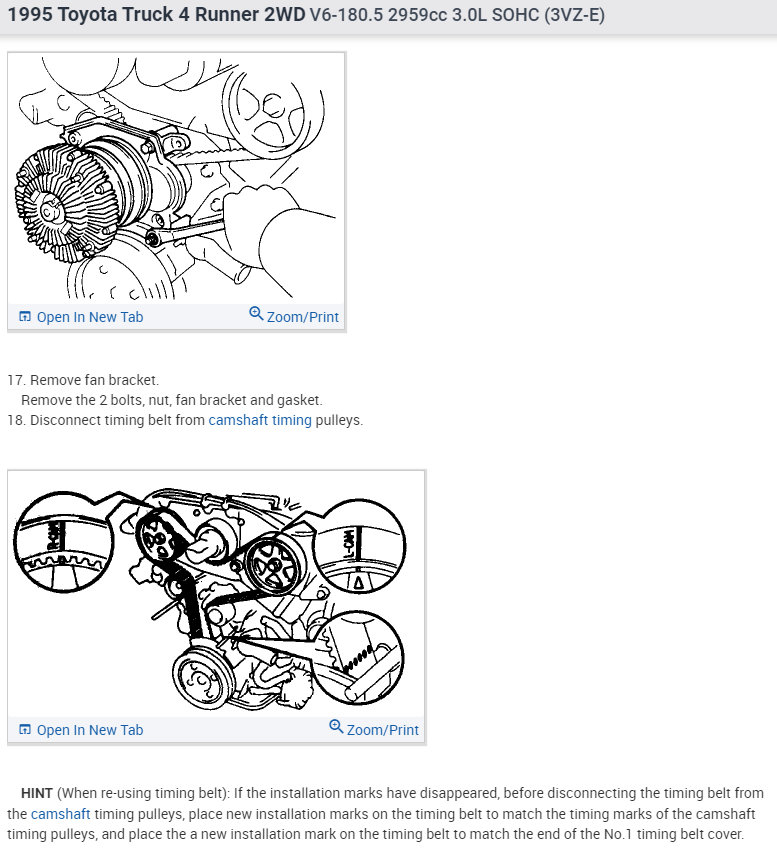

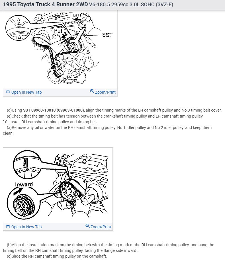

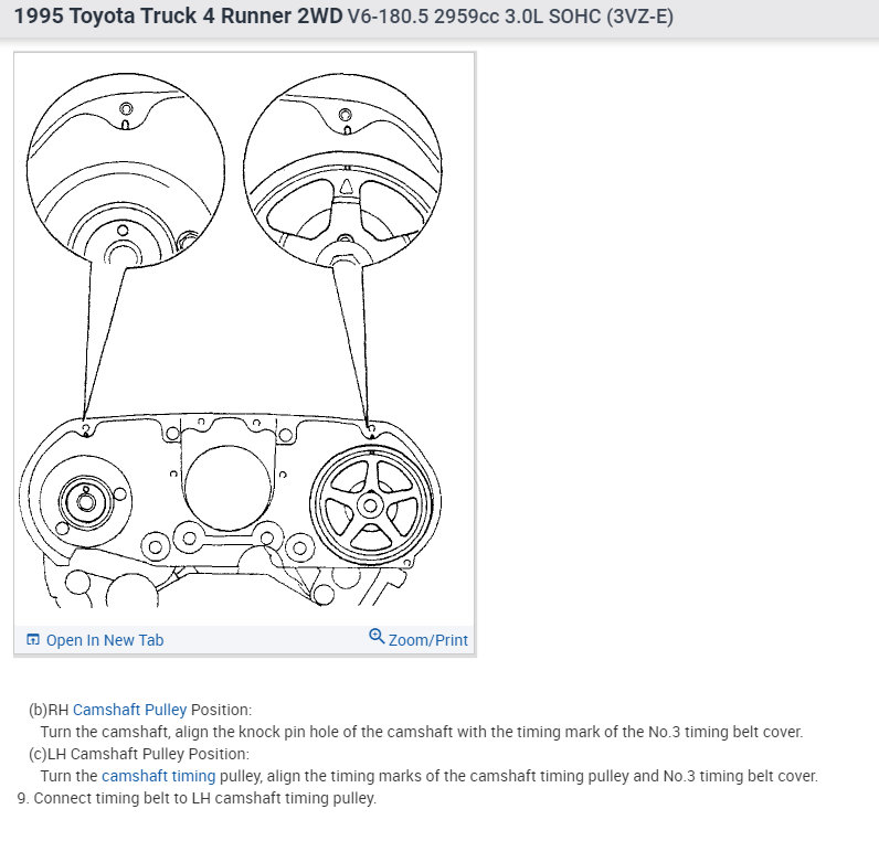

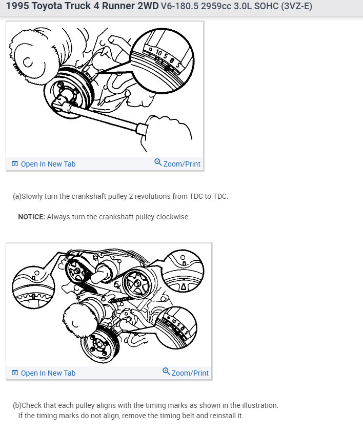

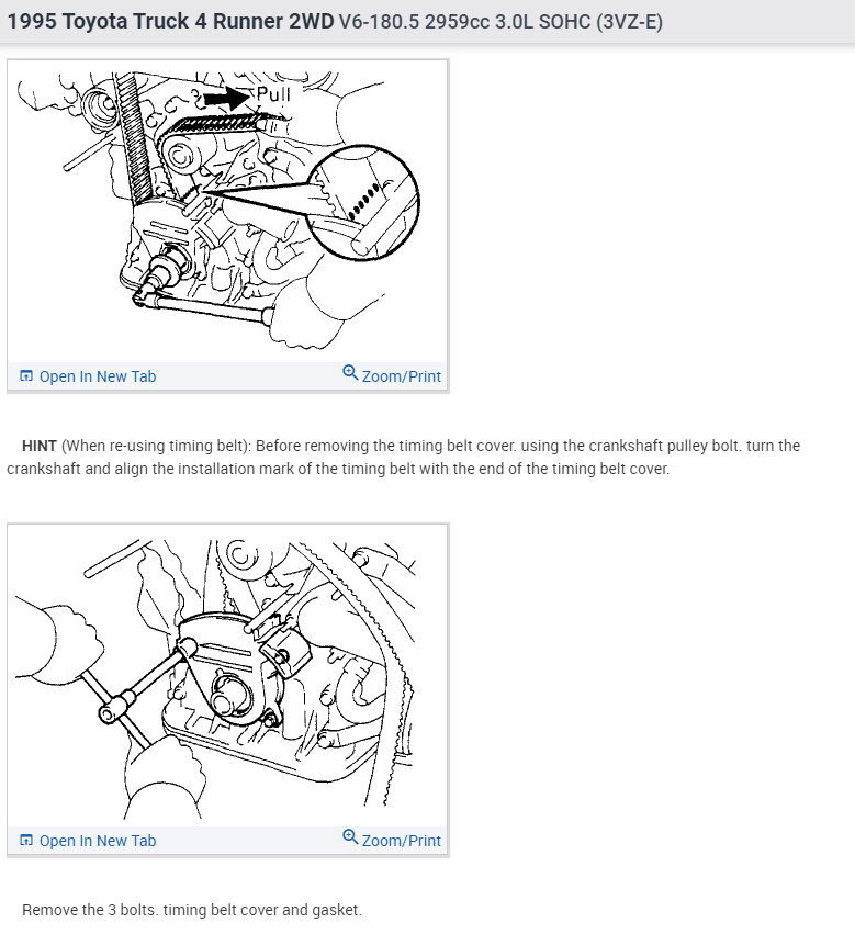

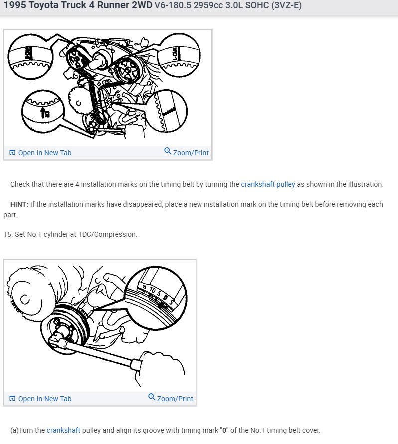

Most of the time the reason for the belt to come off the pulley is due to misalignment.
It can also come lose if there is insufficient tension on the belt.
Even it was checked, I think it would be a good idea to inspect the alignment of the pulleys as well as the tension.
Keep in mind that if there was a step that got skipped during the installation it can also have issues like this.

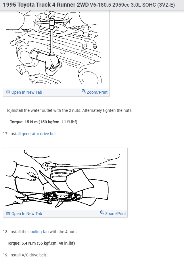

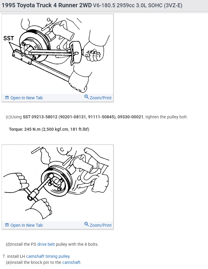

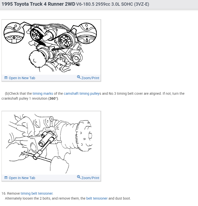

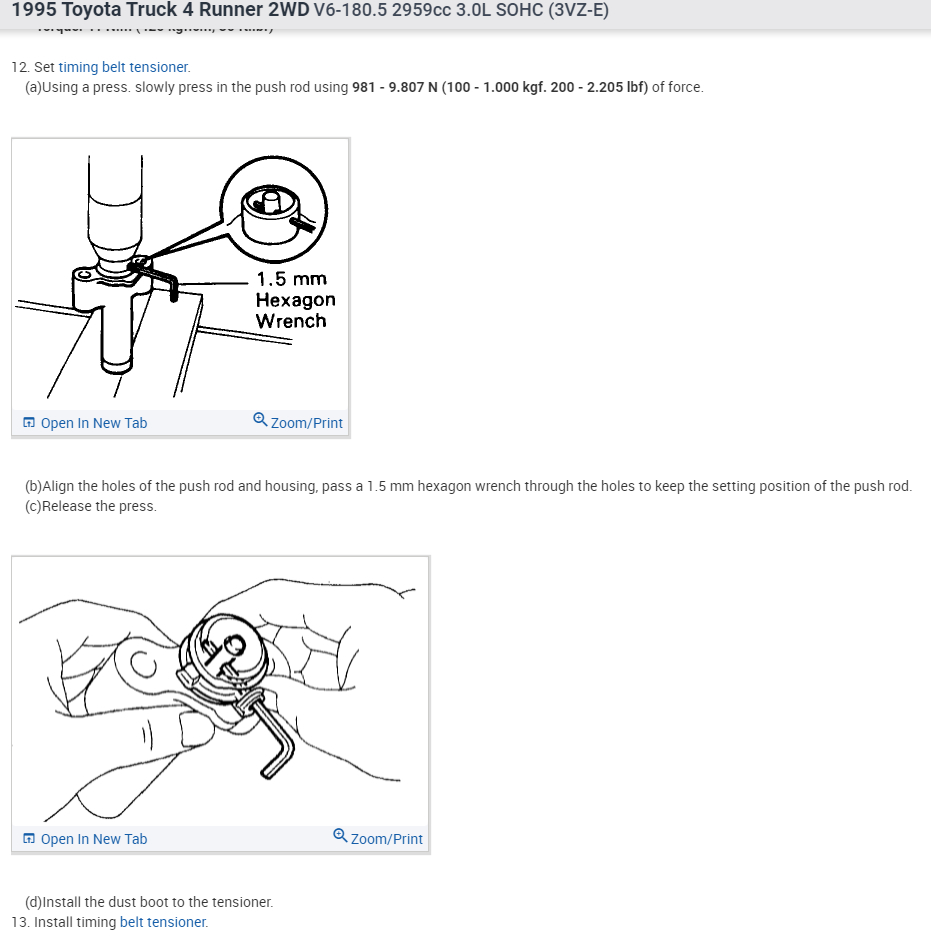

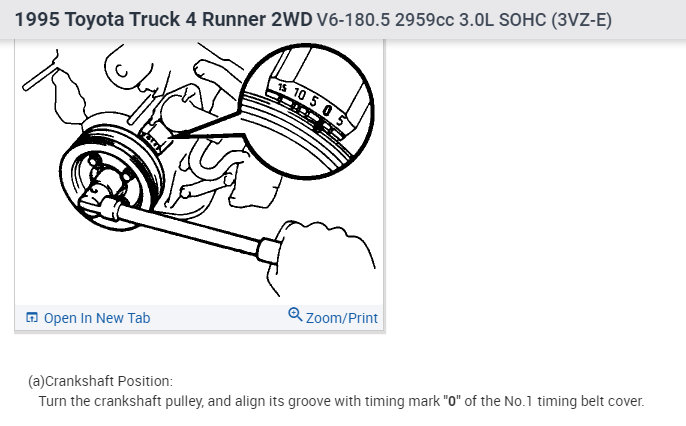

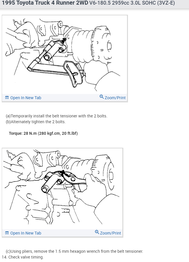

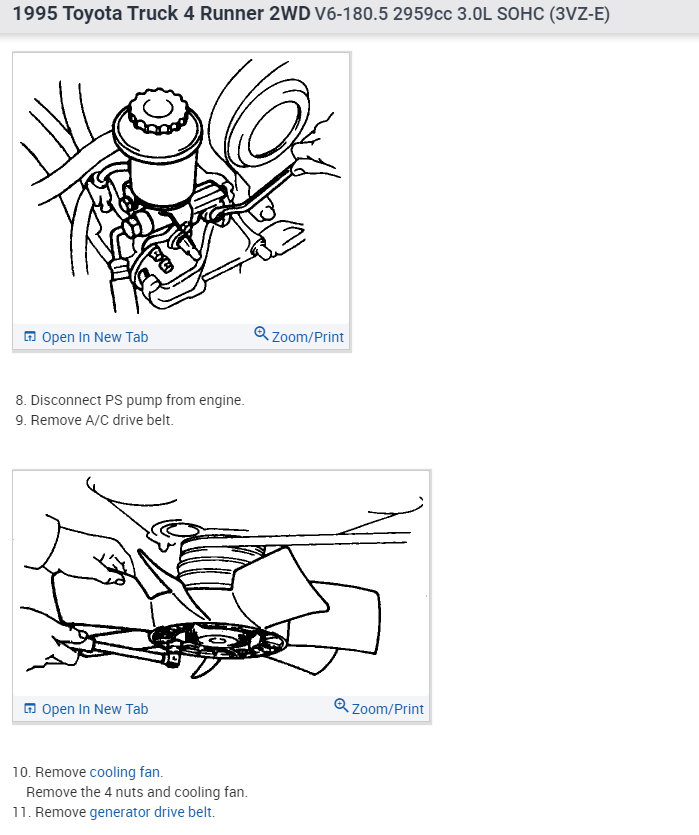

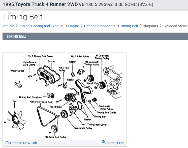

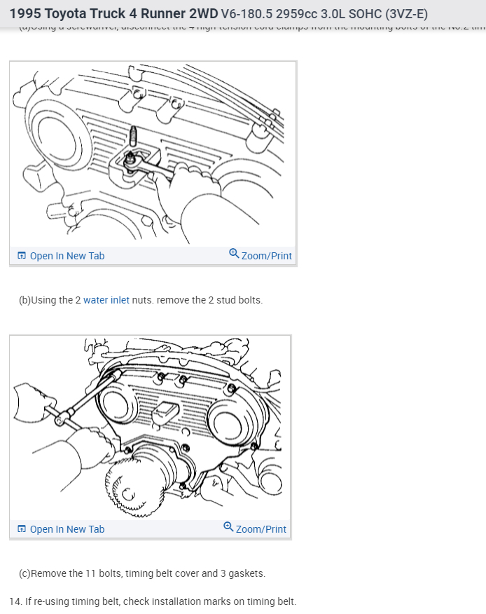

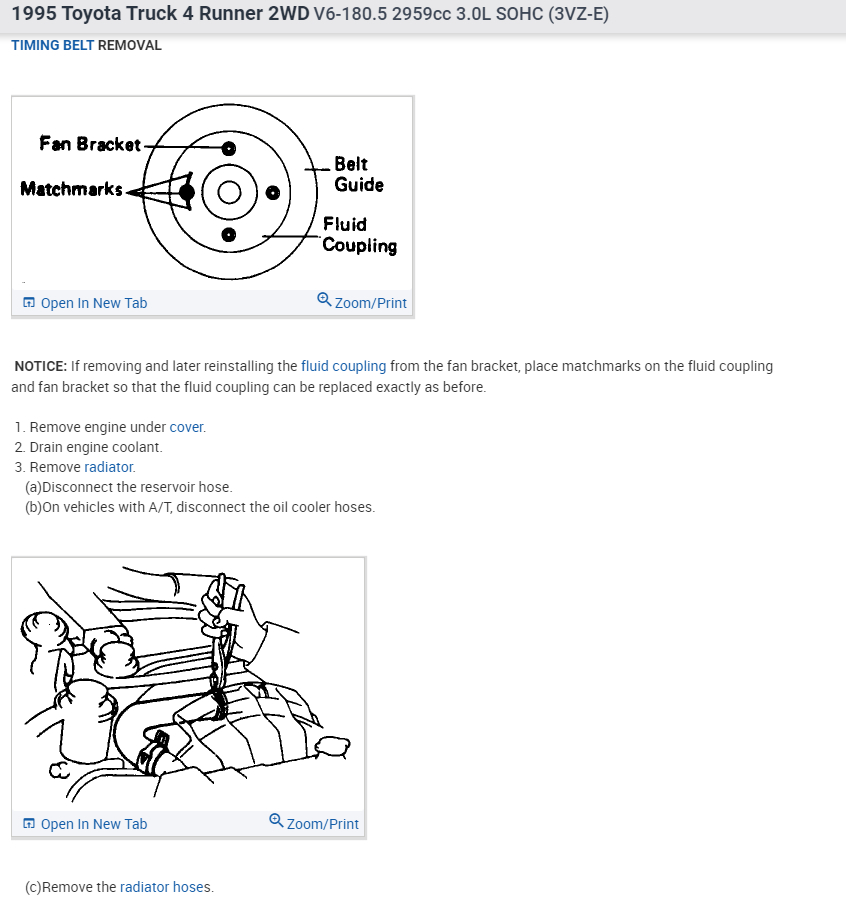

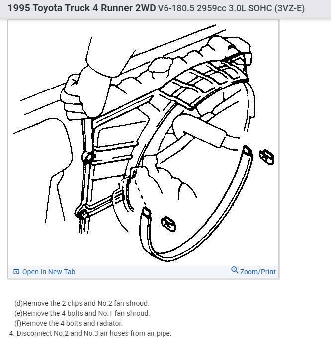

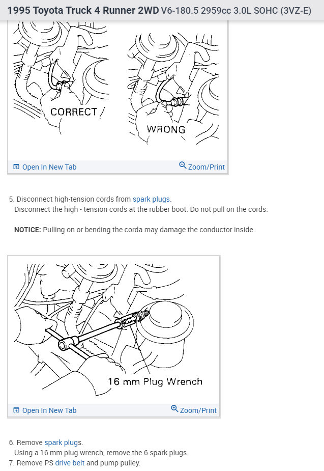

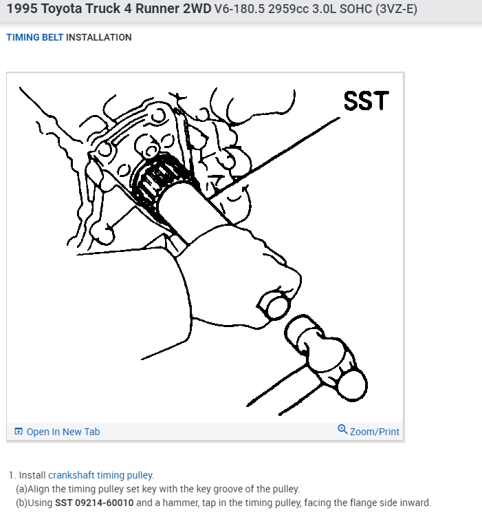

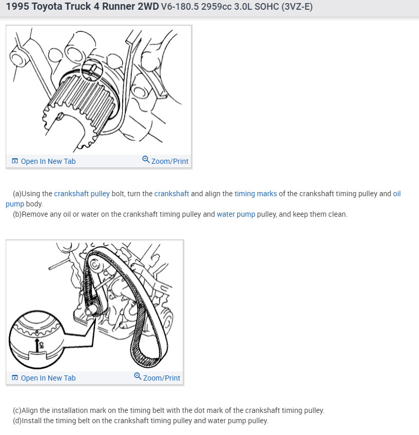

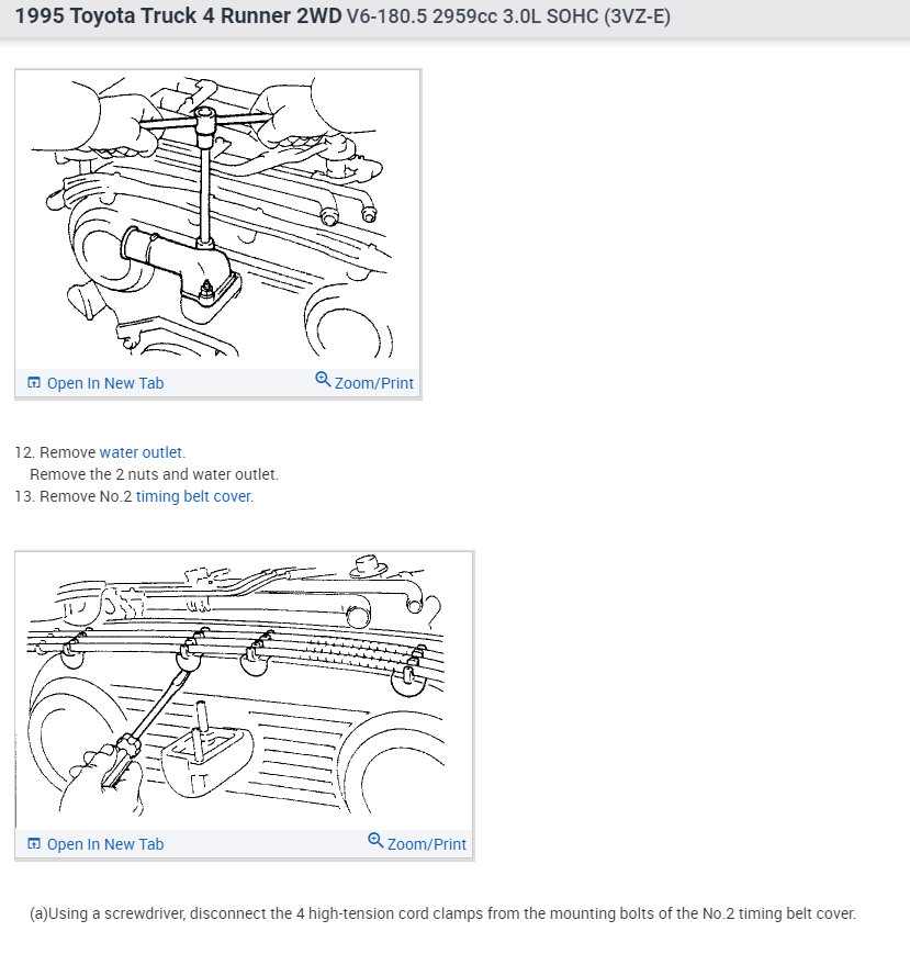

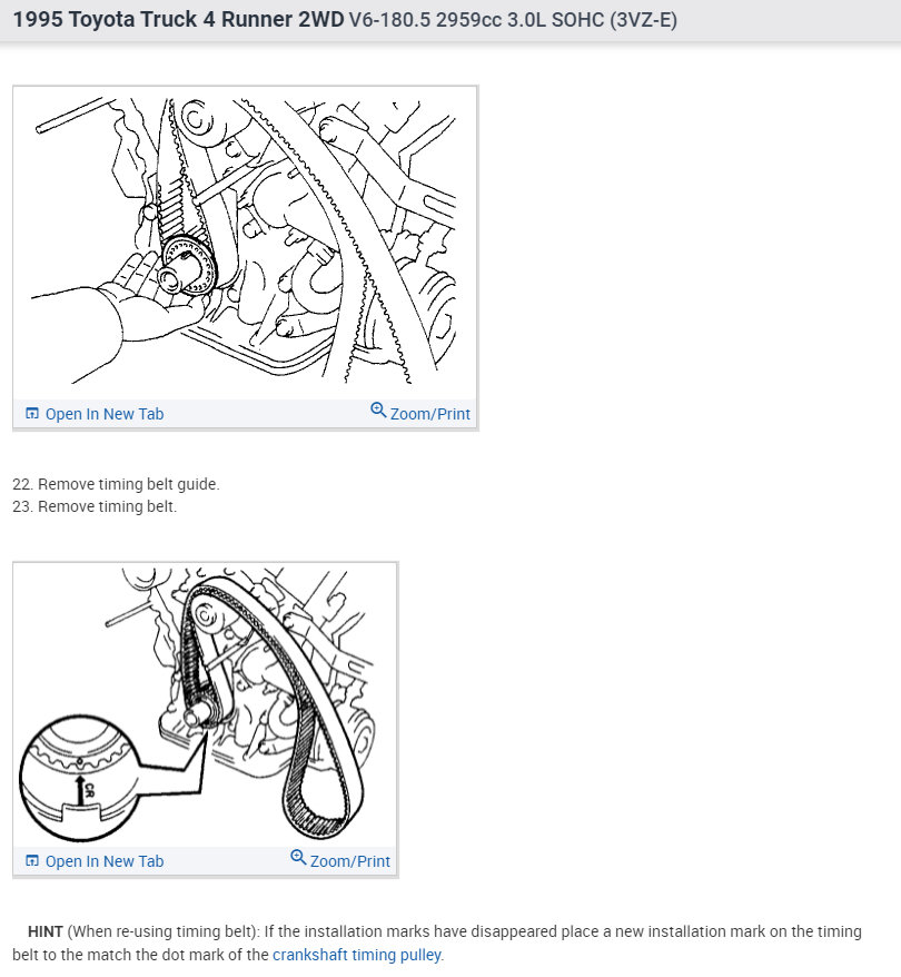

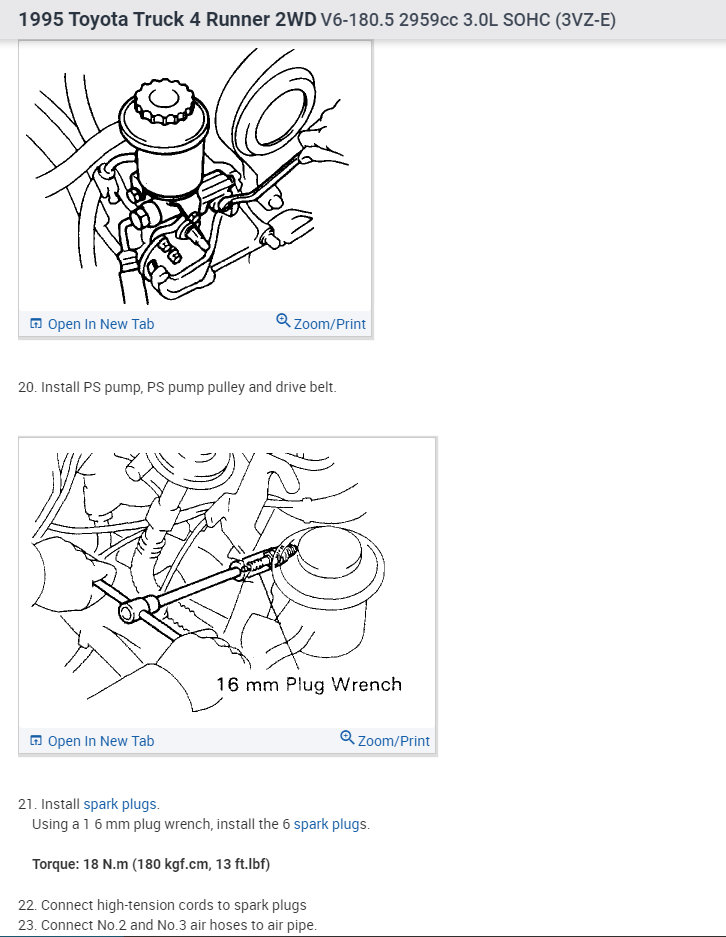

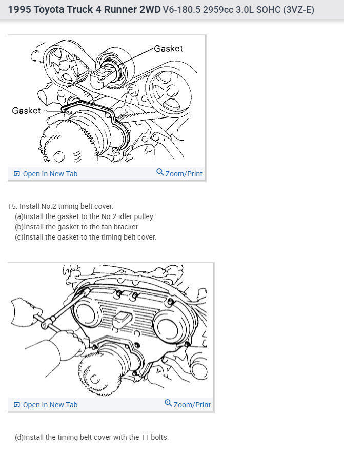

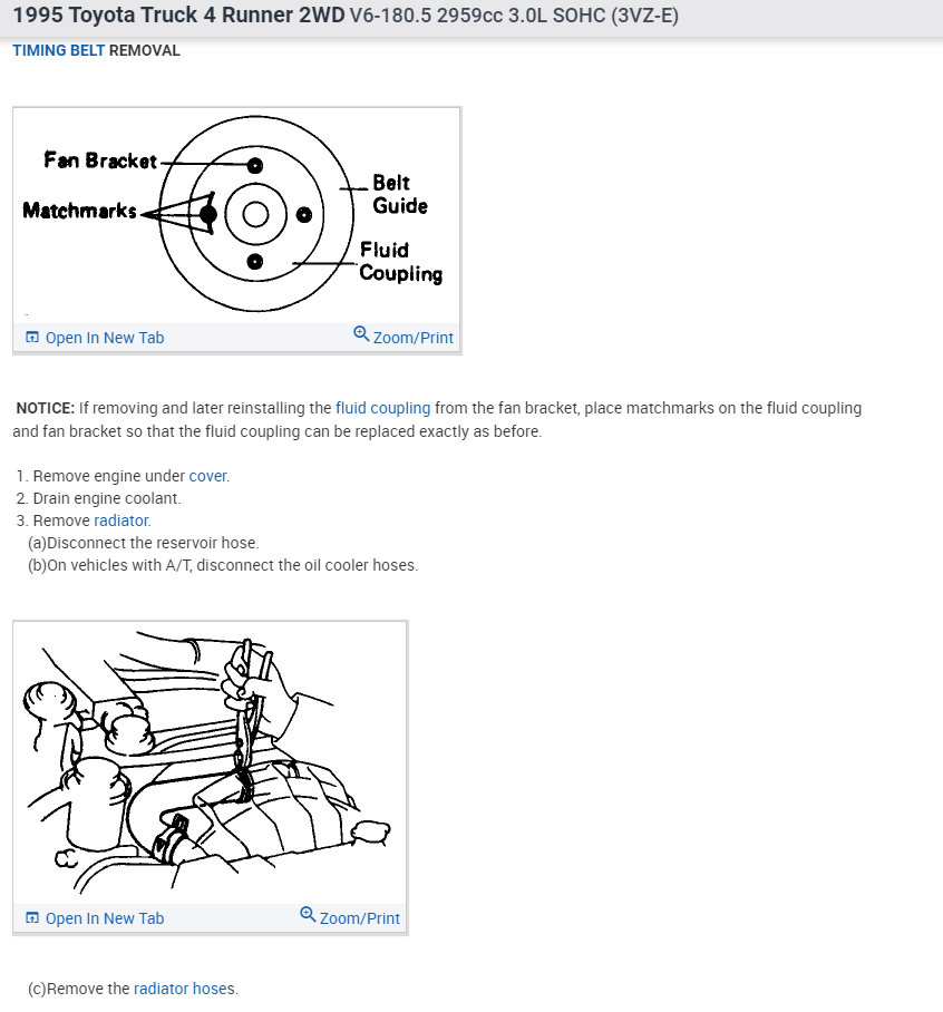

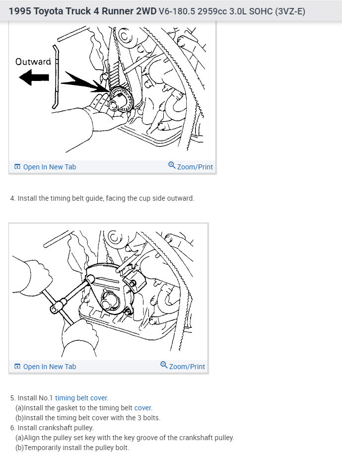

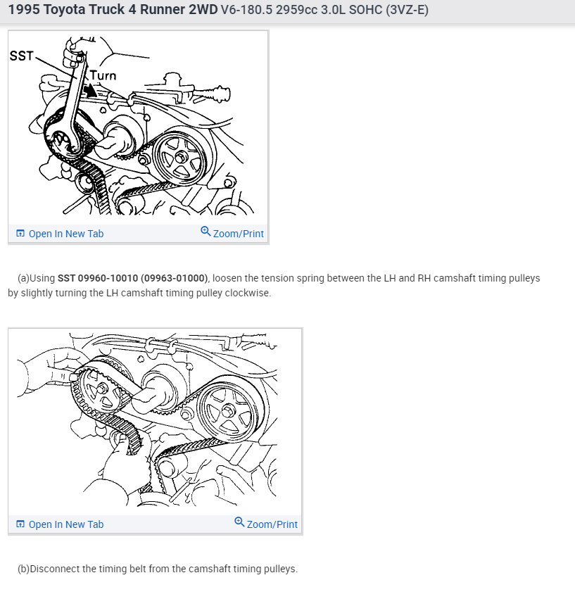

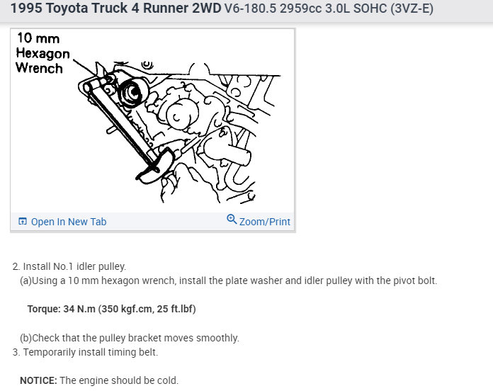

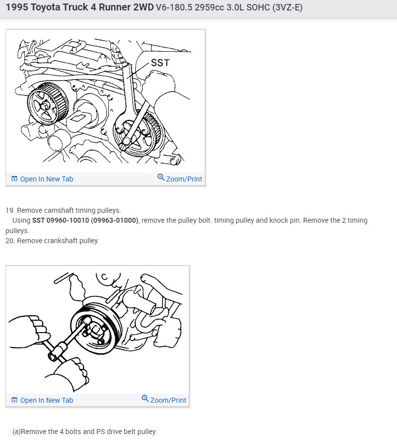

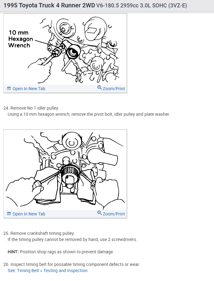

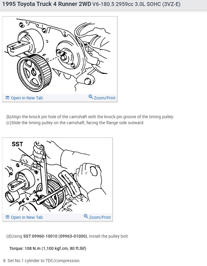

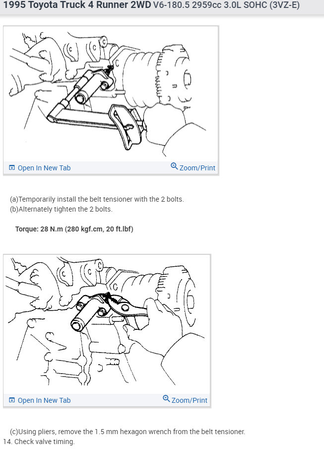

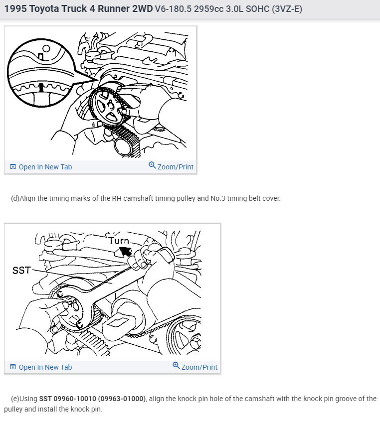

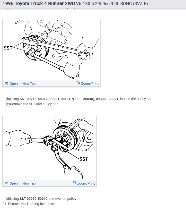

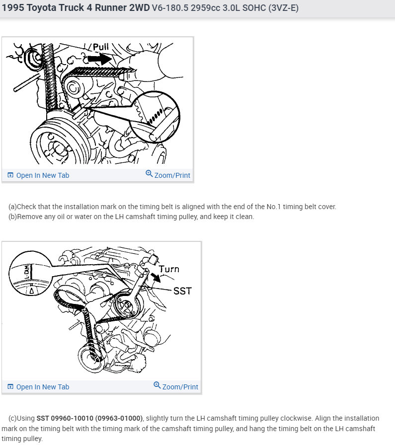

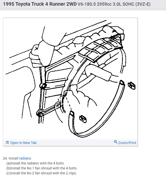

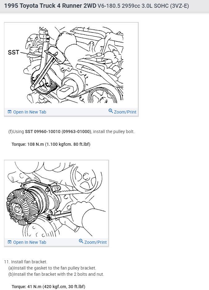

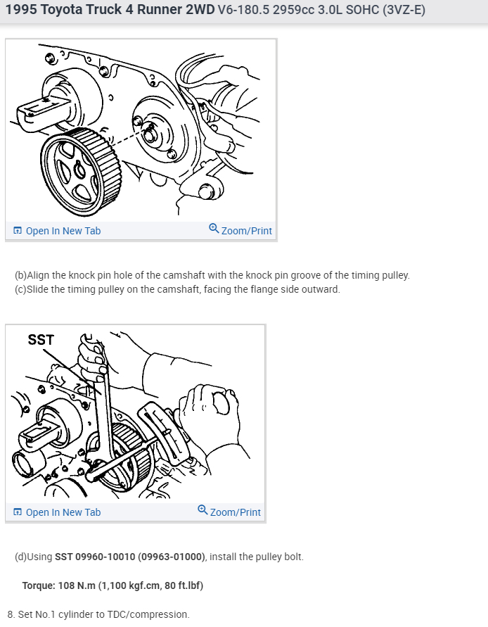

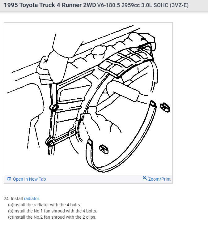

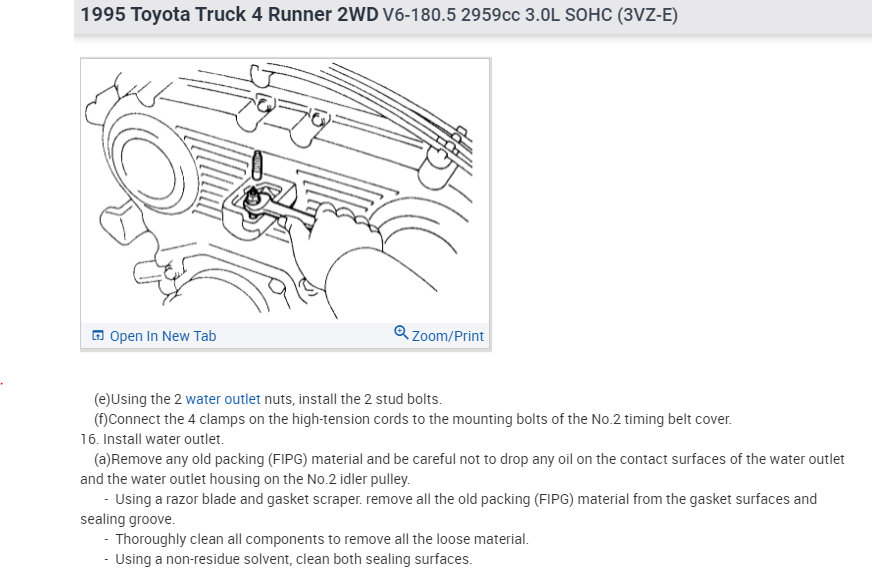

I have attached the replacement procedure for the timing belt below. Look through and see if something was missed.
Thank you.
