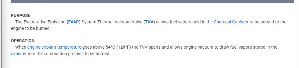

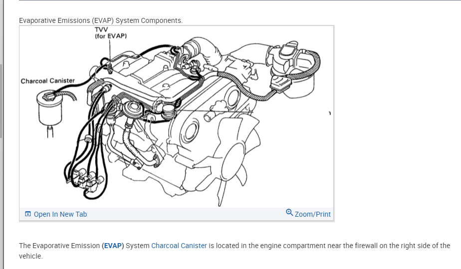

There are a couple of things we need to start with when checking for this issue. First and foremost is a vacuum leak.
Here is a guide that will help with this:

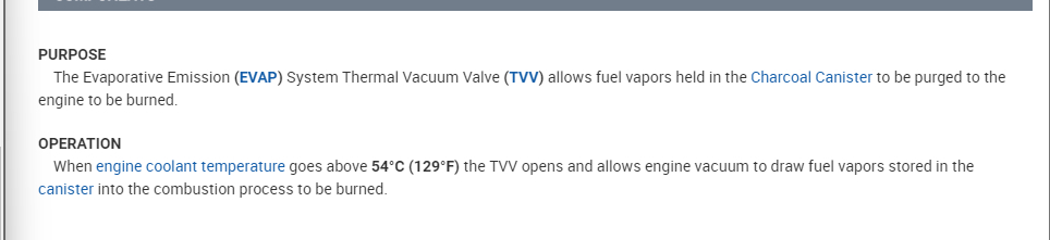

If there are no leaks, then we need to test the EVAP system for the TVV being clogged or stuck open. This is a thermal vacuum valve and if they stick open then they are allowing vapor from the canister to come into the engine when they should not.
Please see the info below for detail on this. Please run through this info and let us know what you find.
