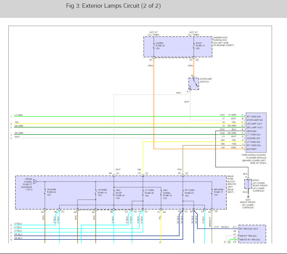

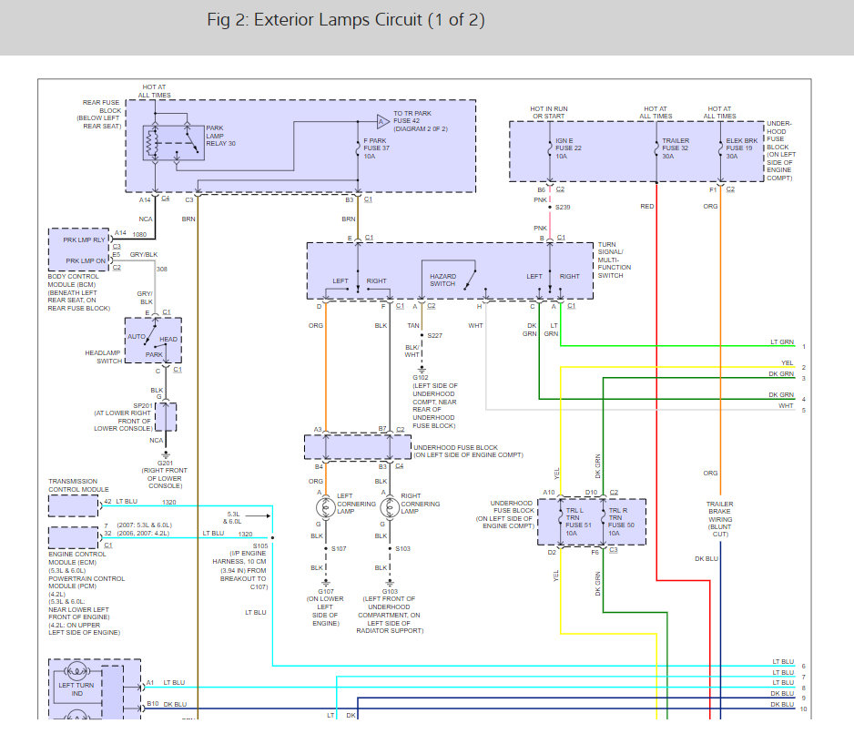

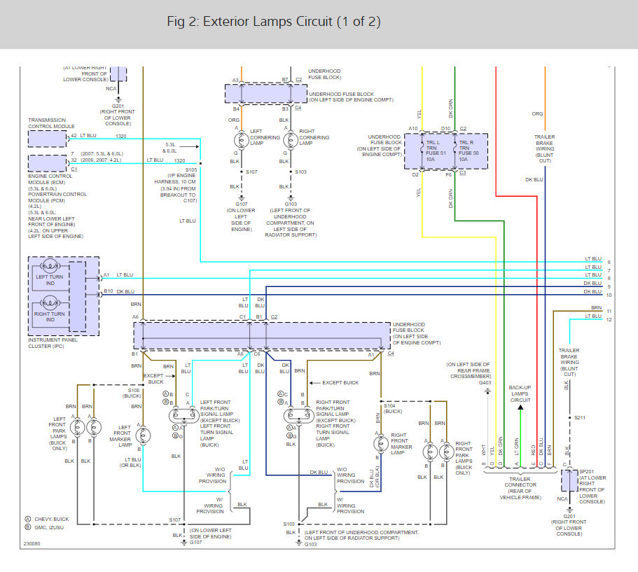

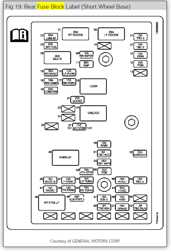

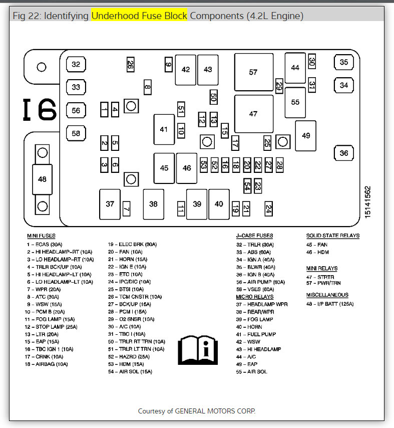

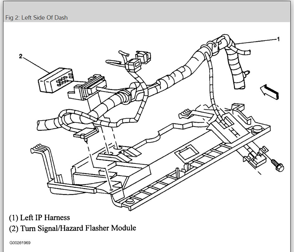

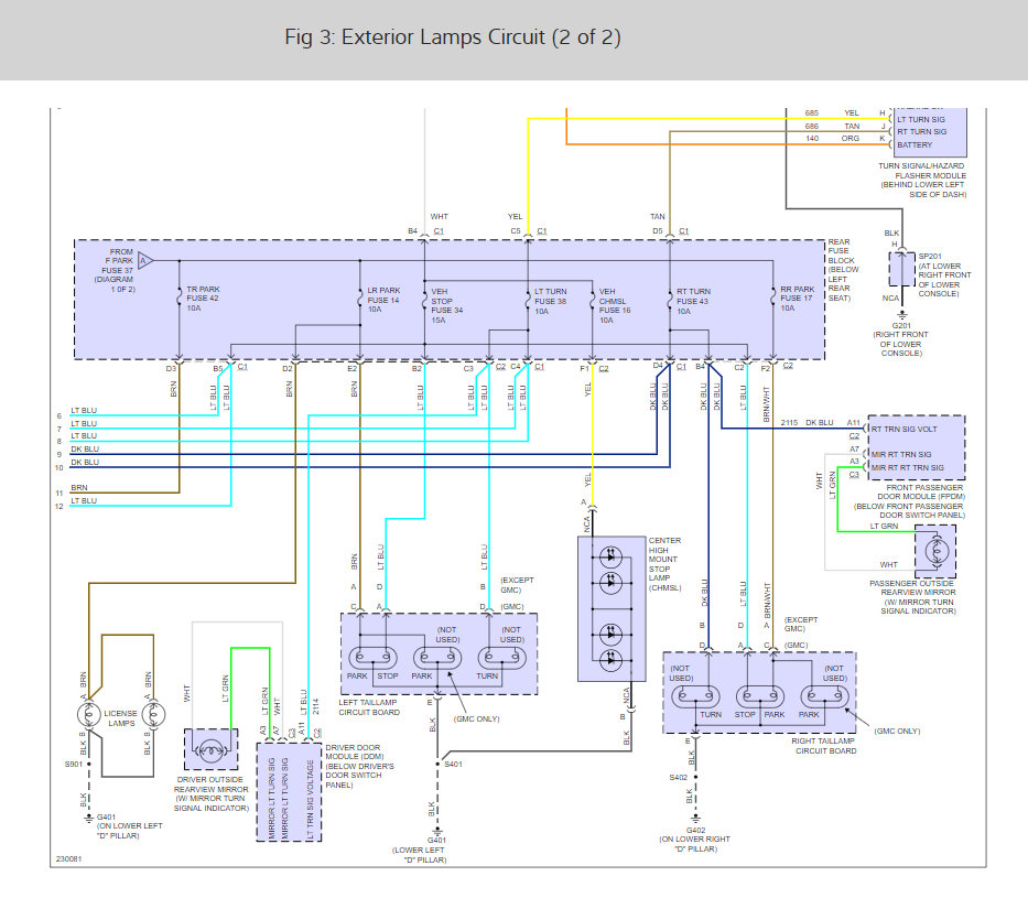

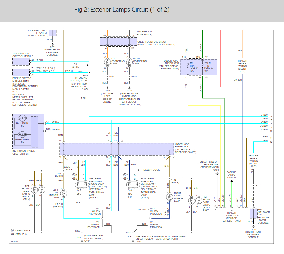

Right turn signal works running lights work both sides brake light on right on right side works left side does not flash. checked fuse and ground put meter on it and i have power but the power does not beak.
