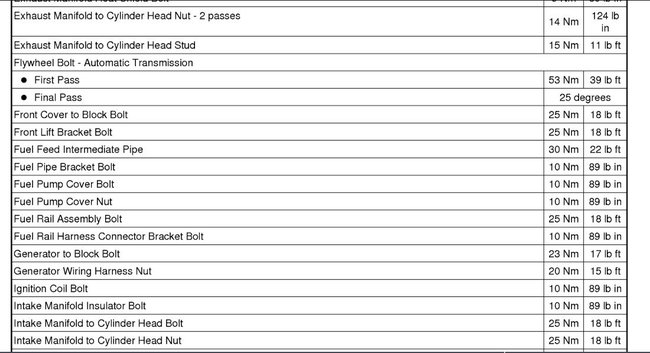

what are the torque specs for intake and exhaust manifold?

Good morning,
I attached the torque specs for you.

There is no order of torque sequence.
Nov 4, 2019 at 5:22 PM
Center out.
