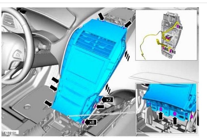

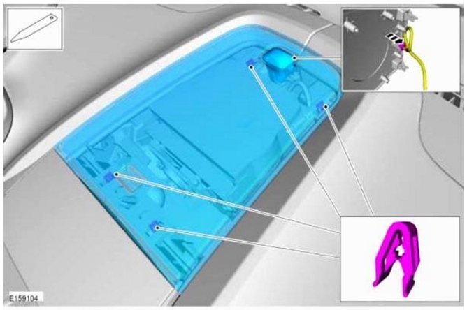

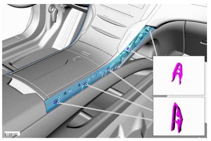

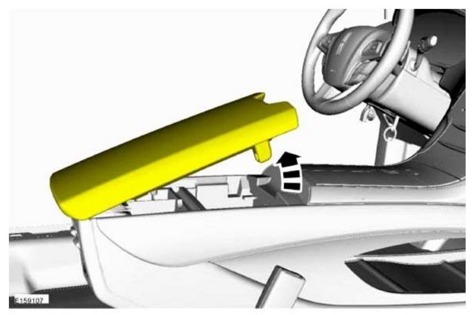

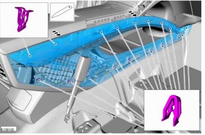

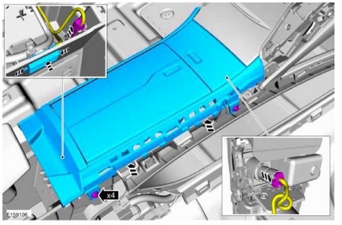

Hey HPATELW5,
Start by disconnecting the battery, there are a series of plastic clips and torx screws. here are some diagrams that will help you remove the touchscreen.
Please let us know happens so it will help others.
