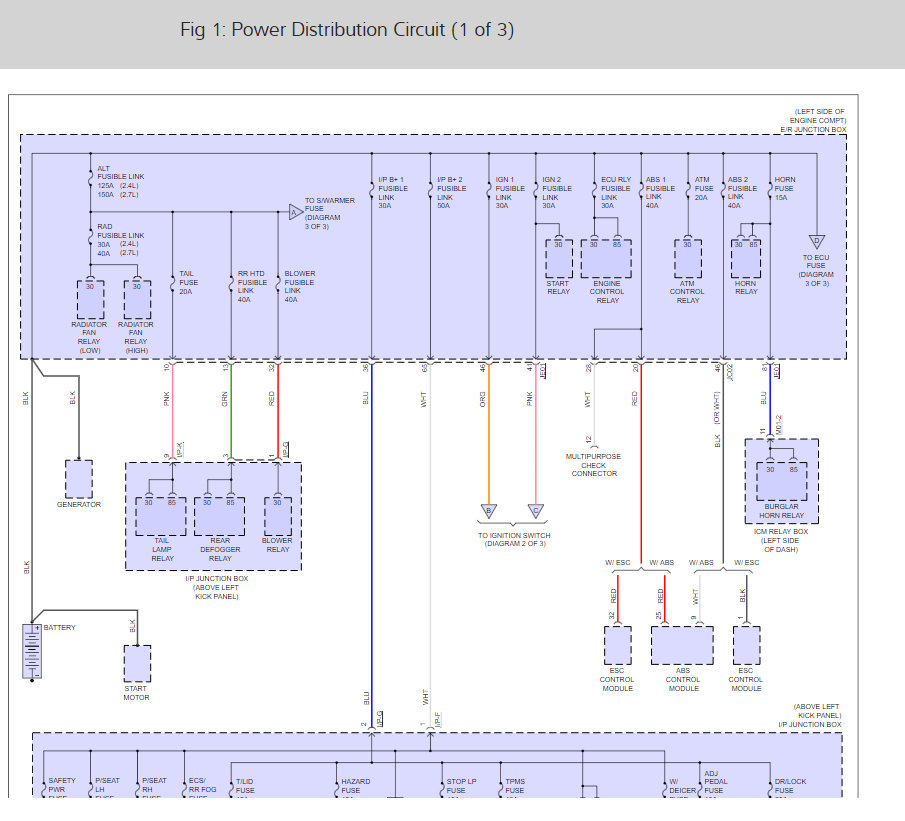

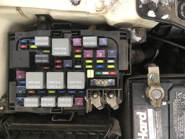

Car is completely dead:
-The battery is good (battery tested, freshly charged over night, 12.7 volts on multi-meter, and just to check, nothing changes when jumpers from a running car are attached). Connections are good and clean.
- no hazards, no headlights, no dash lights, no "click", no nothing.
I have a power probe and have tested all blade type fuses (inside and engine bay fuse boxes). I cannot see a way to test the square fuses with the plastic hoods. I have never seen a 150 amp "fuse" like the one in this box, but I did a continuity test across it.
I have verified voltage at the ignition (heavy gauge incoming red wire).
What happened: My daughter drove home, no symptoms; turned off the engine, and couldn't extract the key. Attempted to restart the car to adjust the steering wheel thinking it was locking the key. Totally dead.
