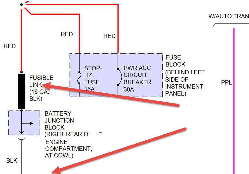

there are fusible links on both sides of block at junction block rear of engine compartment. also, check breaker see picture.

the fusible links are wire and when you see the picture I sent it says black going to a red wire you have to use the same gauge for it. headlights can run through ignition switch but if the link is burnt no power. it states in reply right hand side of truck which is always passenger side.

Hey brother . Thank you very much! I found the fuseable link and that was it ! I'm rolling again . JT
