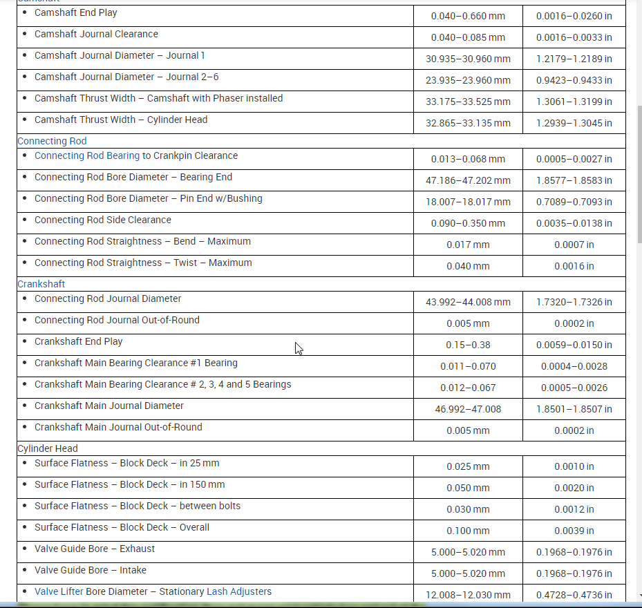

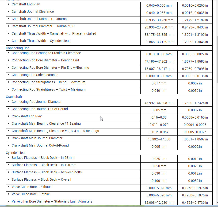

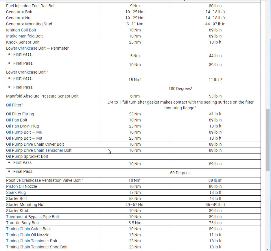

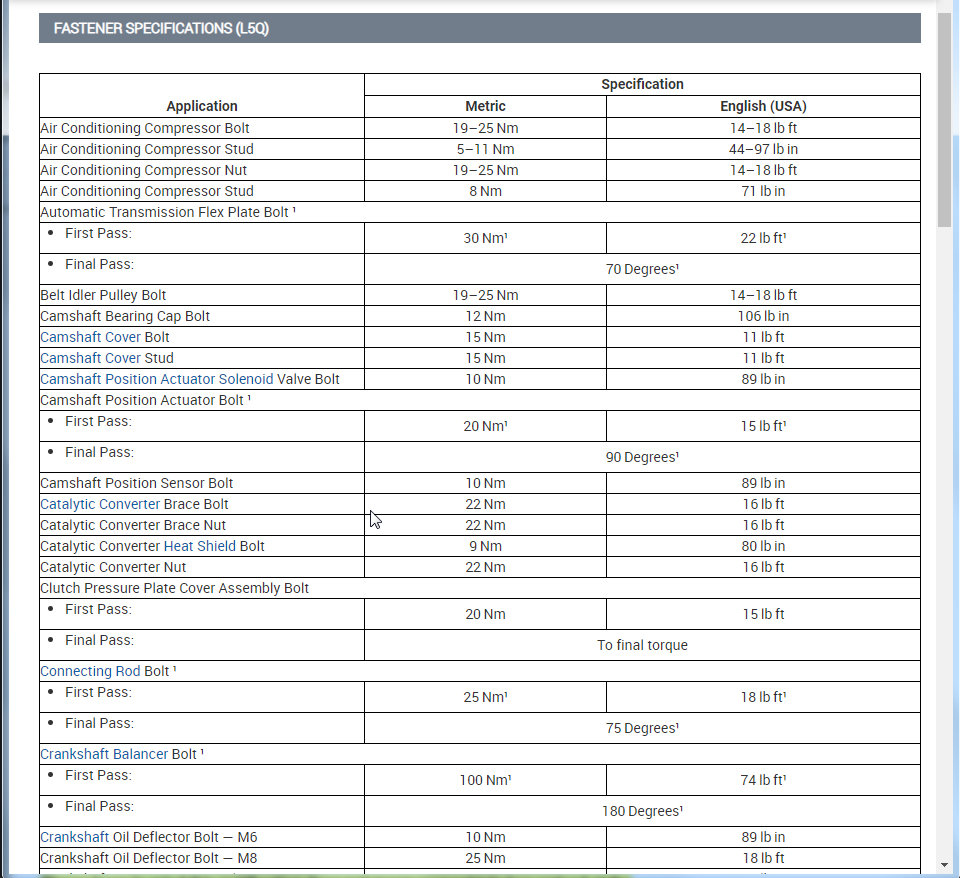

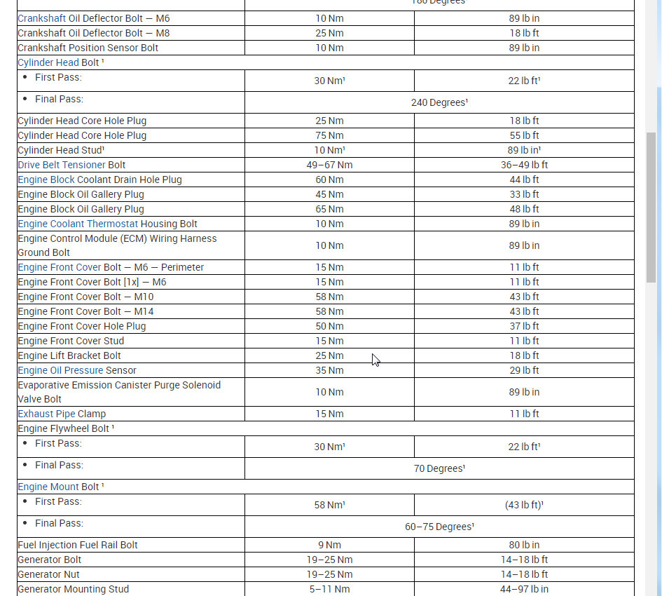

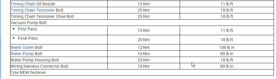

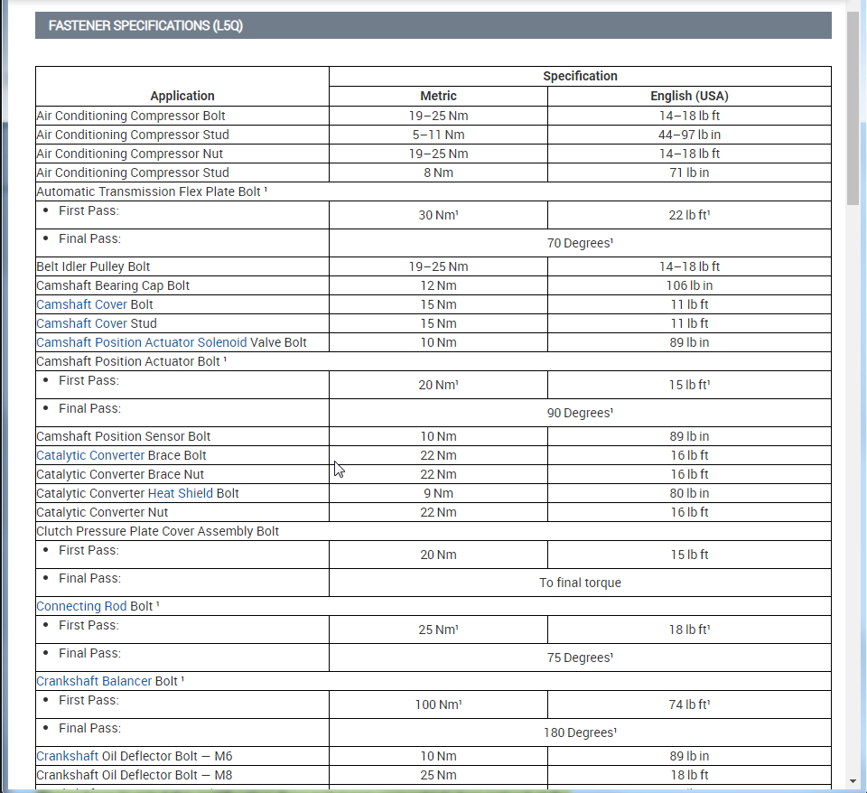

hi, i need the torque setting for the main and big end bearings and also the head bolds and camshafts torque settings.

I am attaching most all the specs for this engine in case you need something else. Please let us know if you have other questions. Check out the diagrams (Below). Please let us know if you need anything else to get the problem fixed. Thanks
