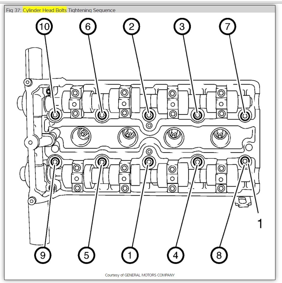

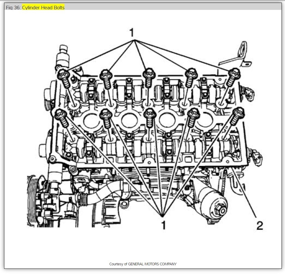

This is straight from the repair manual. (DIAGRAMS BELOW)
Head Torque specs
Tighten the bolts (1) in 5 passes. Use the EN-45059 sensor kit :
First pass to 25 N.m (18 lb ft).
Second pass to 90°.
Third pass to 90°.
Fourth pass to 90°.
Final pass to 45°.
Camshaft Caps
Install the camshaft bearing caps in sequence (2, 3, 1, 4) Tighten the camshaft bearing cap bolts to 8 N.m (71 lb in).
