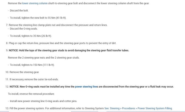

installed a rebuilt rack and pinion saw on websites for the 2 bolts attaching it to the frame.
110 ft/pounds to 325 ft/pds.
I don't have a 3/4'' air impact wrench or a torque wrench for 325 ft/pds.
I have pulled it with a ratchet and a 2' pipe and 2
15/16 '' wrenches making it 24''.
I'm still looking to find a rental torque wrench.

Good evening,

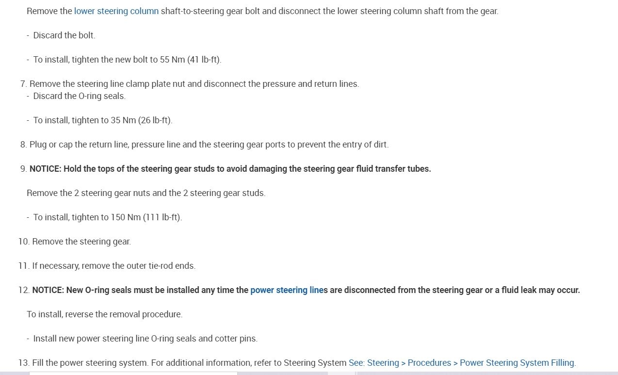

I attached the torque specs for you below.
I don't know where you got those specs, but the nuts are 110 pounds. That is all.
The steering shaft bolt is also attached for you as well.
Jan 4, 2022 at 4:41 PM
