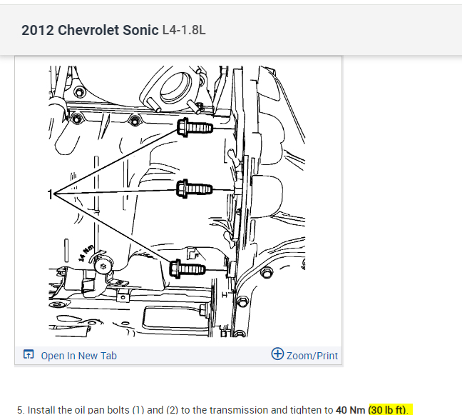

There are two different specs for the oil pan. The ones that go to the trans are 30 t/lb.

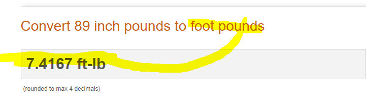

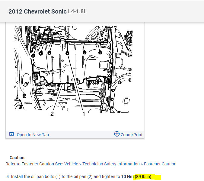

The ones along the bottom of the pan are 89-inch pounds which works out to 7.5 ft/lb. See attached below.
Let me know if this helps.
See pics below.
