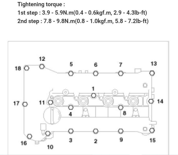

I need to know the torque specs for the valve cover gasket replacement on the vehicle listed above EX model.

If you look at the attached picture below, it provides the torque specifications and the tightening sequence.
When you tighten these, it is a two-step process. First, you will tighten them to approximately 3.5 ft/lbs and then a second pass to approximately 7 ft/lbs.
Let me know if this helps.
See pic below.
