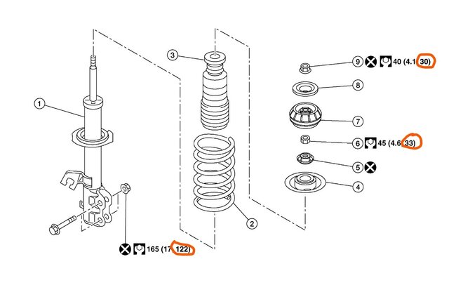

Hello, I need to replace the front struts on my vehicle listed above. I was hoping you could share the torque specs for the top and bottom mounting bolts. Thank you so much for your help.

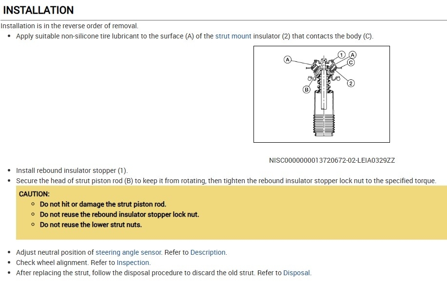

These should be correct for that vehicle. The red circled numbers are the lb ft. The first number is newton meters. The second image are the OE instructions for replacement.

Awesome, thank you so much. The only shop manual I had was for the 2024 Nissan Kicks. Glad I asked you though. Looks like the 2018 uses a little less torque.
