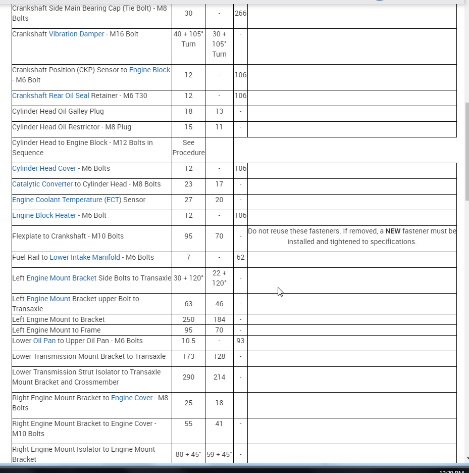

replaced rocker arm.

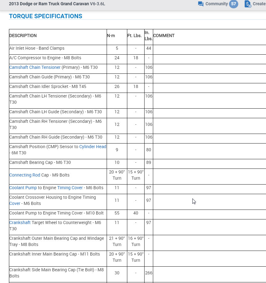

Good morning,
I attached all the camshaft torque specs for you below.
The spec is in inch pounds and nm.
89 inch pounds is the spec you need.

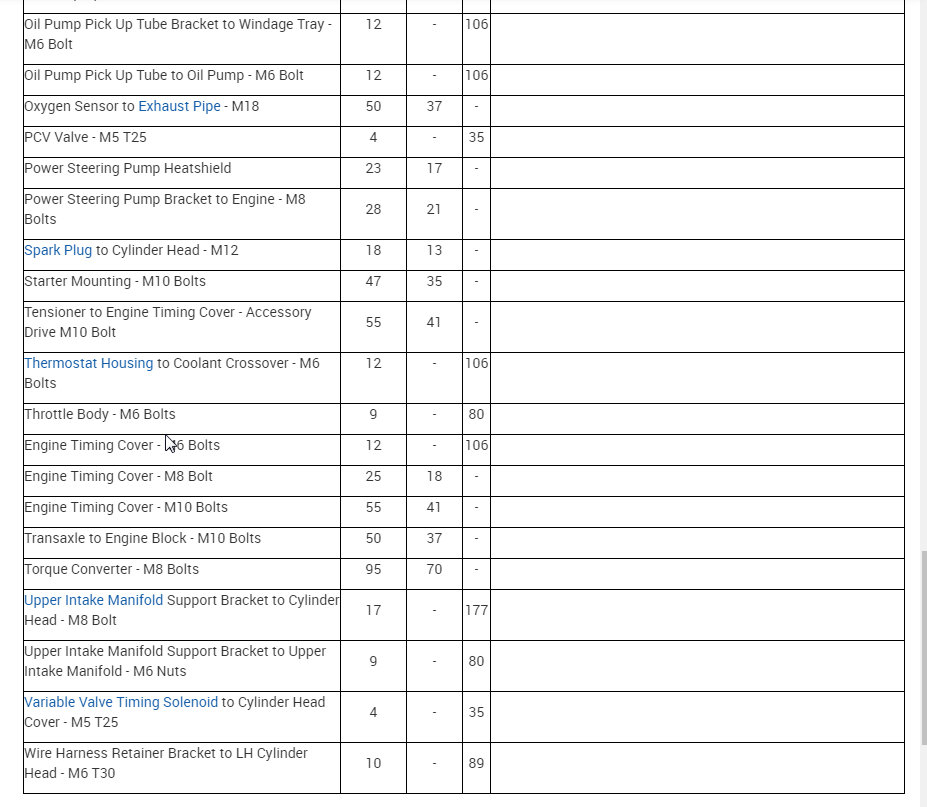

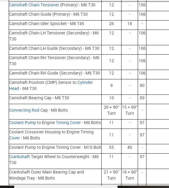

CERTIFIED EXPERT
18,907 POSTS
I attached all the engine specs but the Camshaft Bearing Caps are 10 Nm or 89 In Lbs.
Let me know if you need more of these. Thanks
