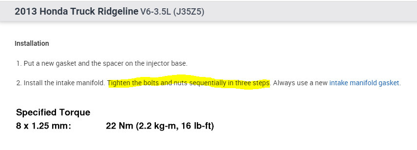

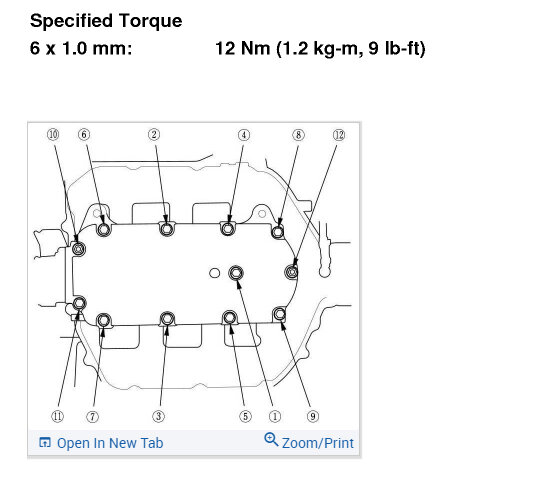

I attached the torque specs and sequence for the intake manifold. Is that what you need or was there anything other?
Take a look at the pics and let me know if they help or if you have other questions.
See pics below.

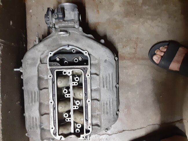

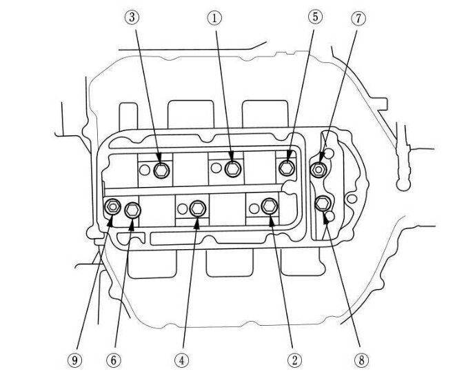

This is the part that needs torque and tightening specs on, and the part on top. Here are some photos, thank you. This part which I think is called a Fuel Injection Plenum that bolts to the top of engine and the little part that bolts on top of this.

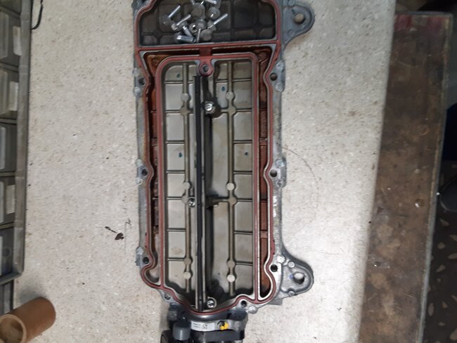

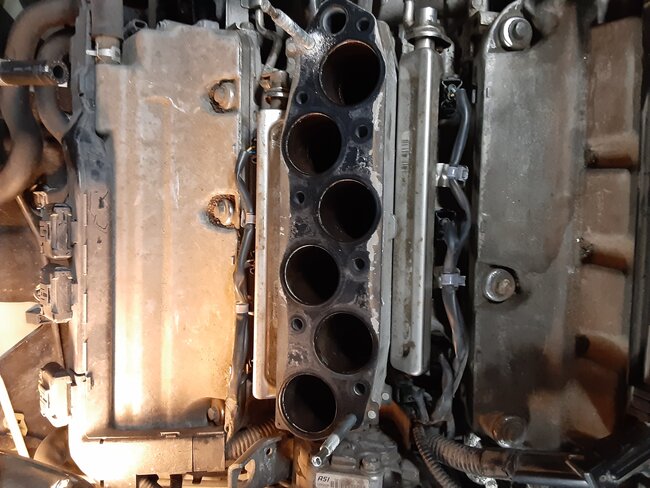

here are more photos.

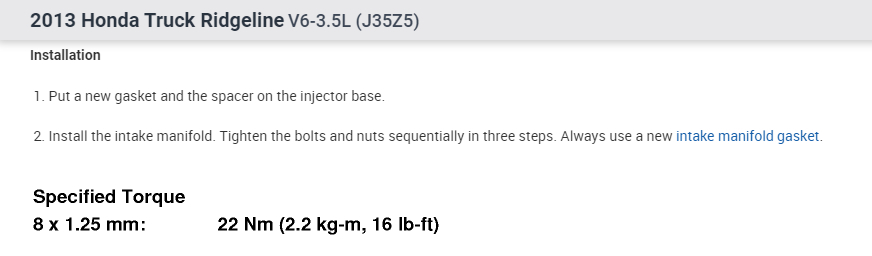

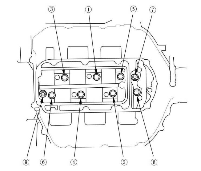

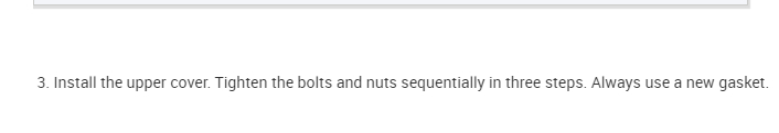

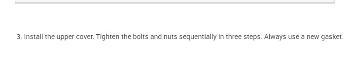

Take a look at the pics below. I attached the installation directions for the two components you mentioned. Let me know if that is what you needed.
See pics below.

Thank you so much, this is what I needed.
