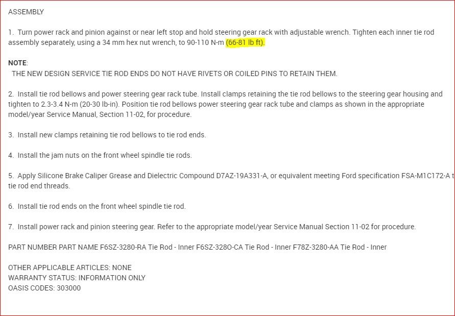

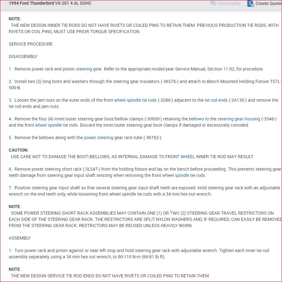

Hey, I'm replacing my Inner tie rods. I have a manual and everything that lists almost every torque spec except the inner tie rods. Please help me out.
May 11, 2019 at 2:43 PM
Hi Yungdrab,

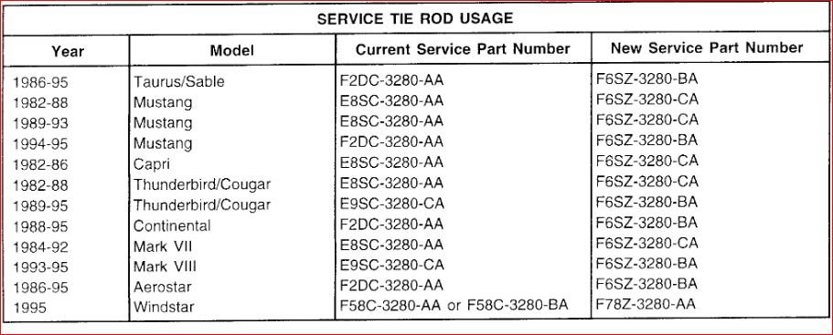

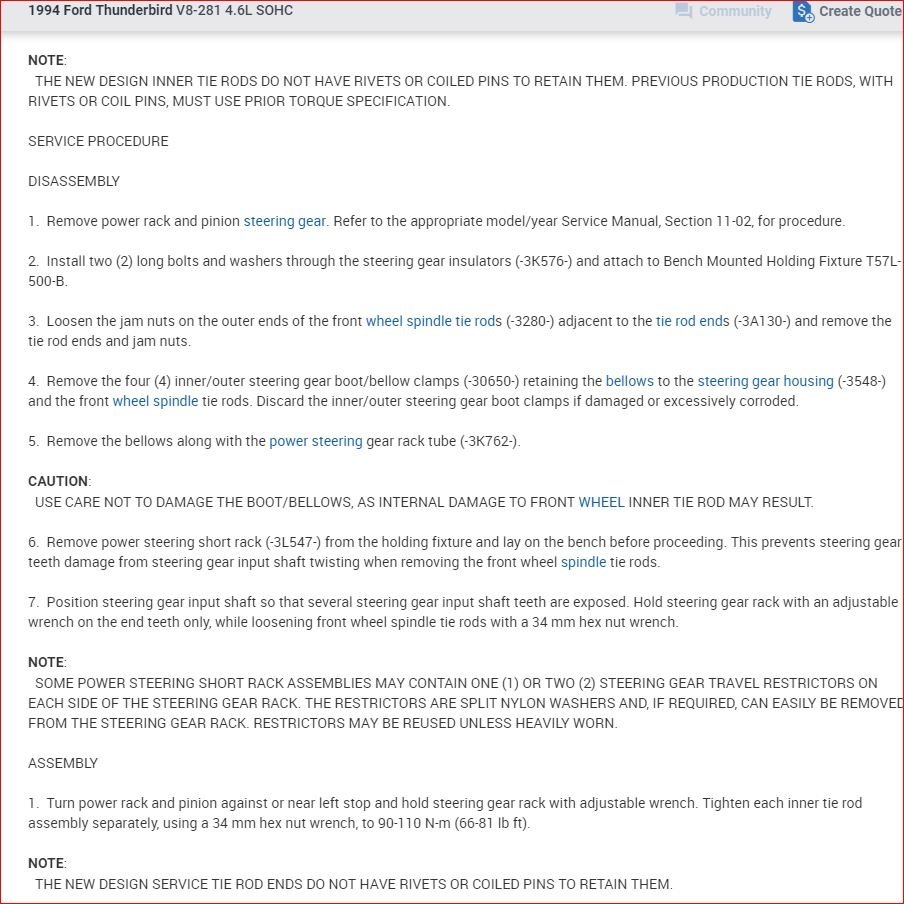

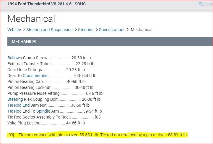

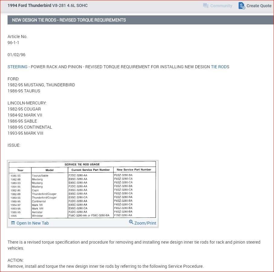

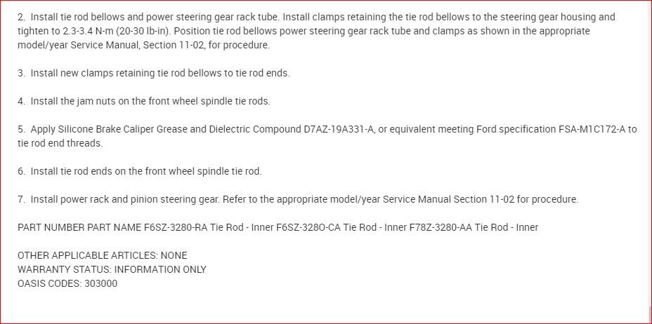

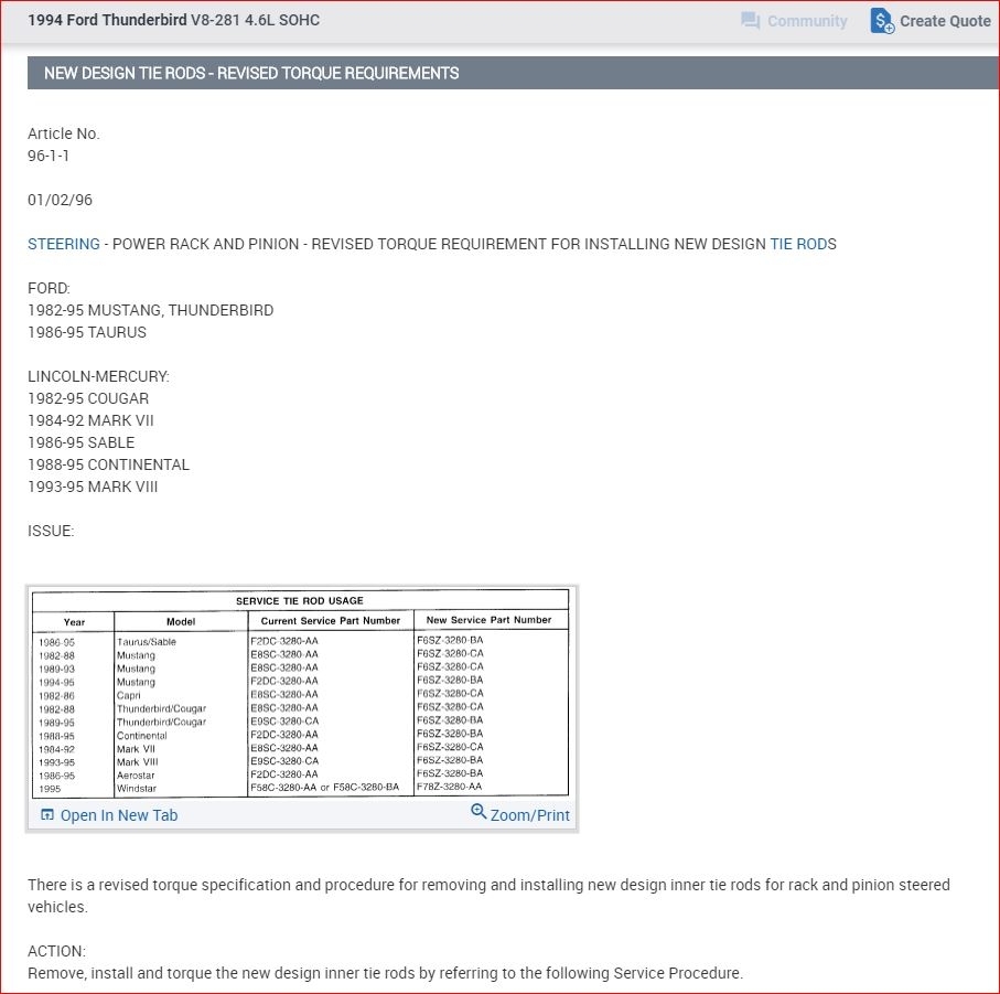

Looks like you have a couple options. There is a TSB that shows the new design part. If you are using the old one with a pin to hold it in place you have a lower torque spec. If the newer design, then it is higher.
Let me know if you need anything else. Thanks
May 12, 2019 at 3:17 PM
