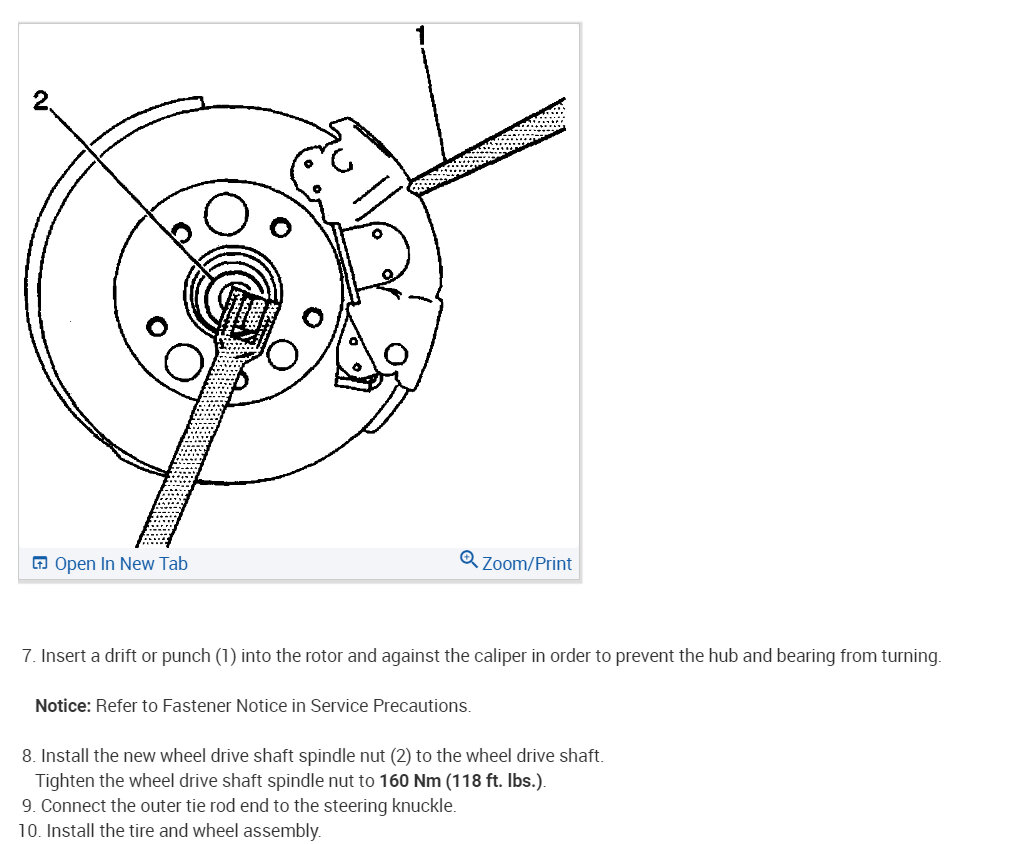

What are the torque specs for the front wheel (axle nut/wheel bearing hub to knuckle/caliper mounting bolt and tie rod end bolt)? In ft/lbs.
Jul 23, 2023 at 12:37 PM
CERTIFIED EXPERT
53,854 POSTS
Sure, here is the information you have requested:
Tighten the wheel drive shaft spindle nut to 160 Nm (118 ft. lbs.).
Tie Rod to Knuckle Nut 55 ft. lbs.
Tie Rod Lock Nut 47 ft. lbs.
Check out the images (below). Please let us know if you need anything else to get the problem fixed.
