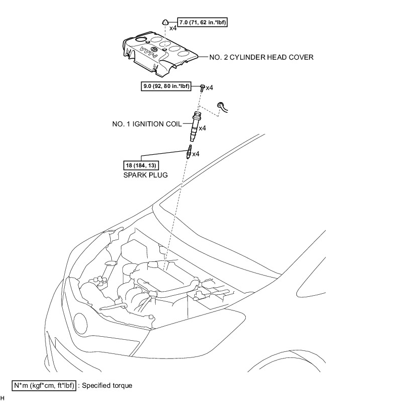

I need the procedure and torque specs for the spark plugs and ignition coil and cover the car listed above.

Hello.
Hope the following link and diagram help in your repairs, Please keep us up to date on your repair.
https://www.2carpros.com/articles/how-to-change-spark-plugs
Thanks for using 2CarPros.
Dave H
