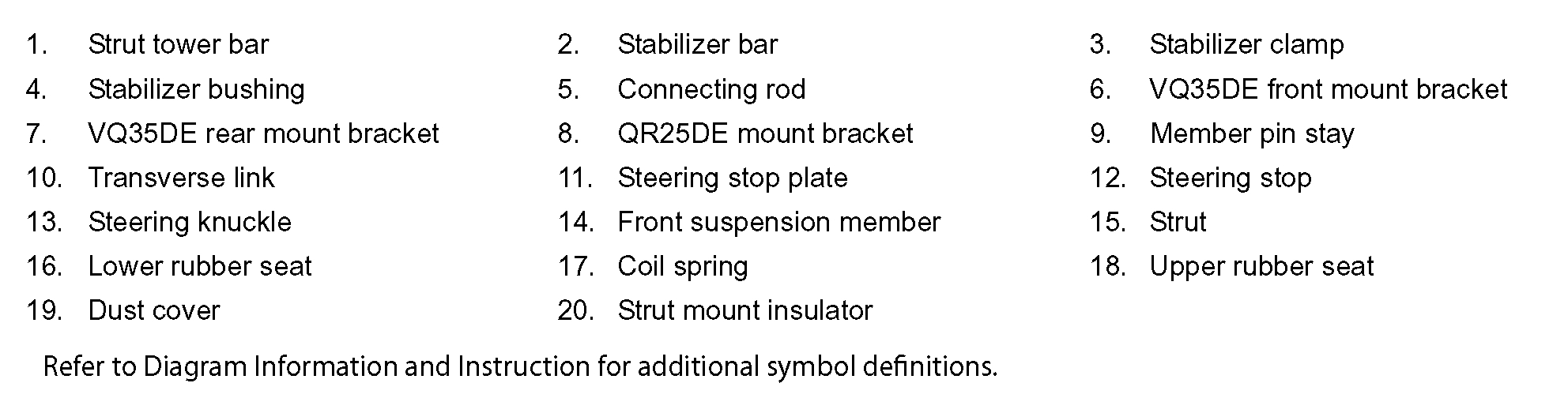

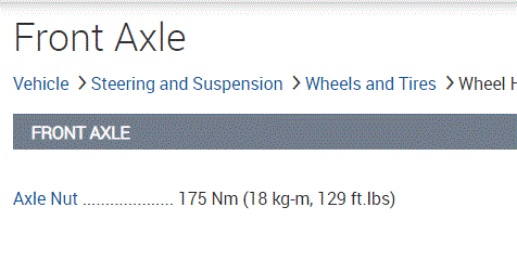

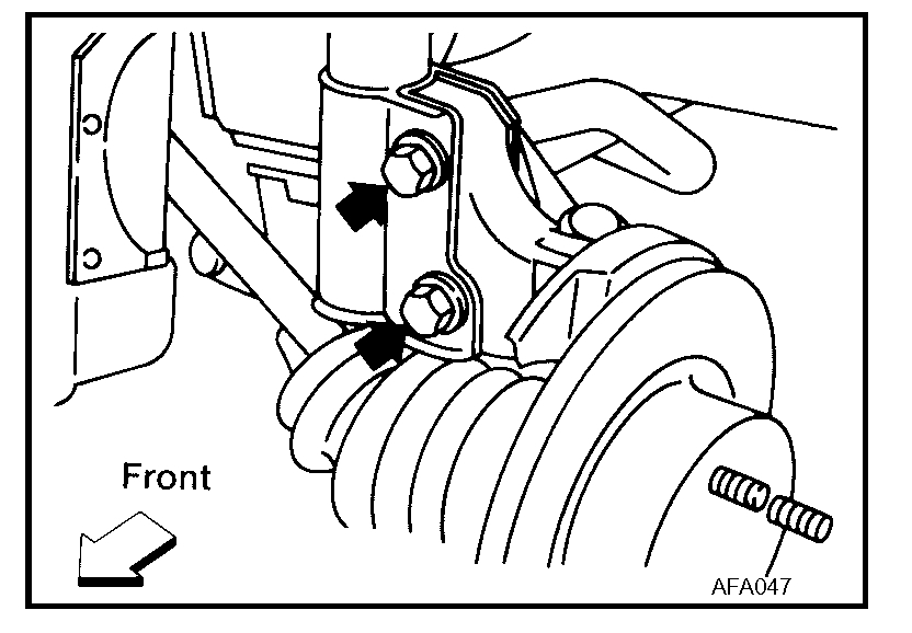

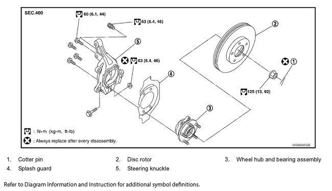

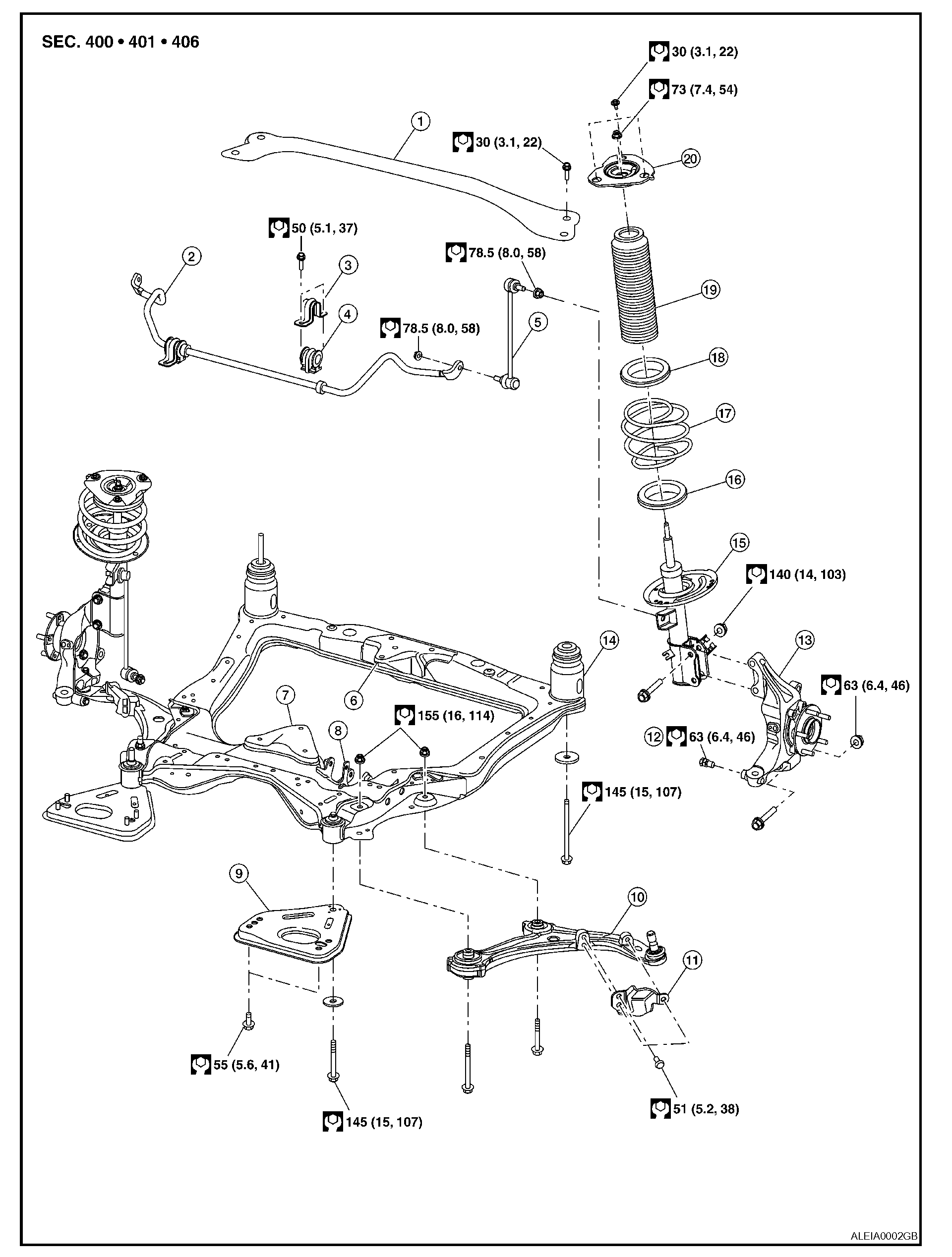

Pics 1 and 2 show the torque specs. Pic 1 is the axle nut and pic 2 is for the ball joints which I believe what you are referring to when you say steering knuckle.
_________________
I don't know if you need it, but here are the directions for replacing the axle. The remaining pictures correlate with the directions.

Exploded View FSU-13 (Part 1)
pic 3

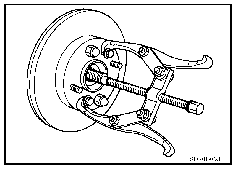

Exploded View FSU-13 (Part 2)
pic 4

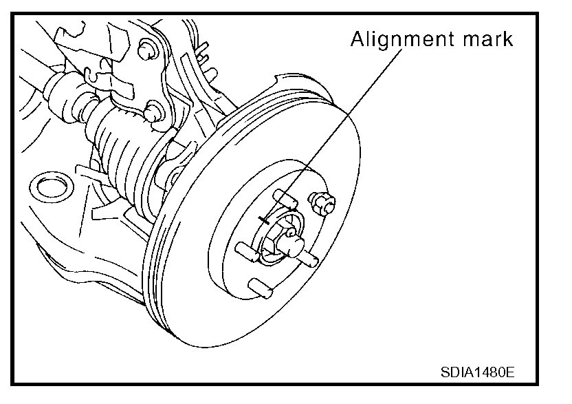

Exploded View FAX-7
pic 5

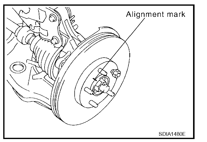

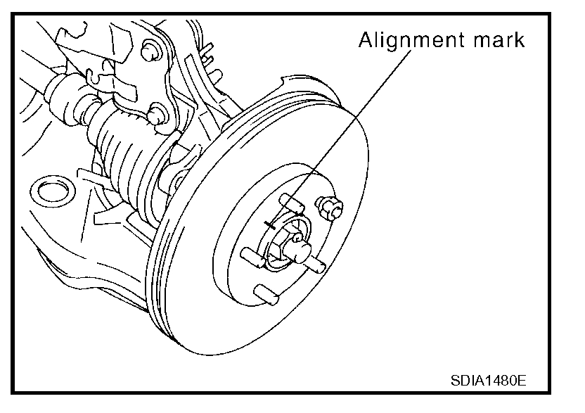

3. Put alignment marks on disc rotor and wheel hub and bearing assembly, then remove disc rotor.

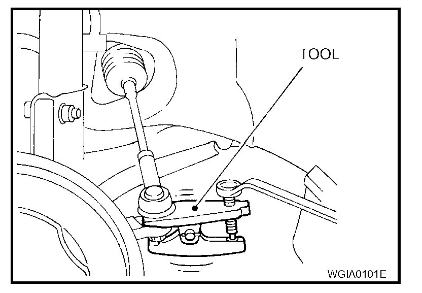

Pic 7
7. Disconnect the outer tie-rod end from steering knuckle using Tool. Be careful not to damage ball joint boot.

9. Remove wheel hub and bearing assembly from drive shaft using a puller or suitable tool.
CAUTION:
^ When removing wheel hub and bearing assembly, do not apply an excessive angle to drive shaft joint. Also be careful not to excessively extend slide joint.
^ Support drive shaft when removing.

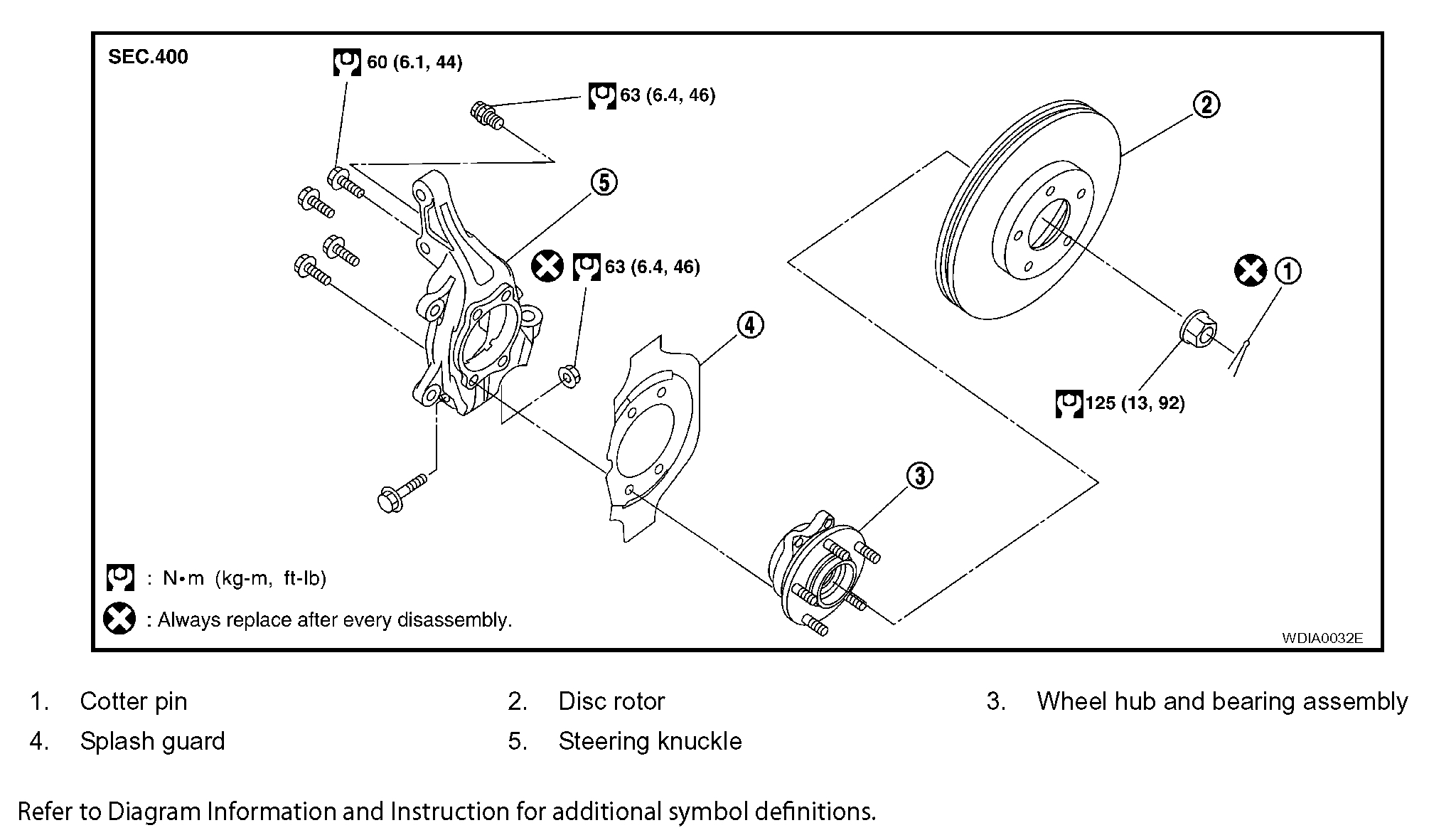

pic 4
