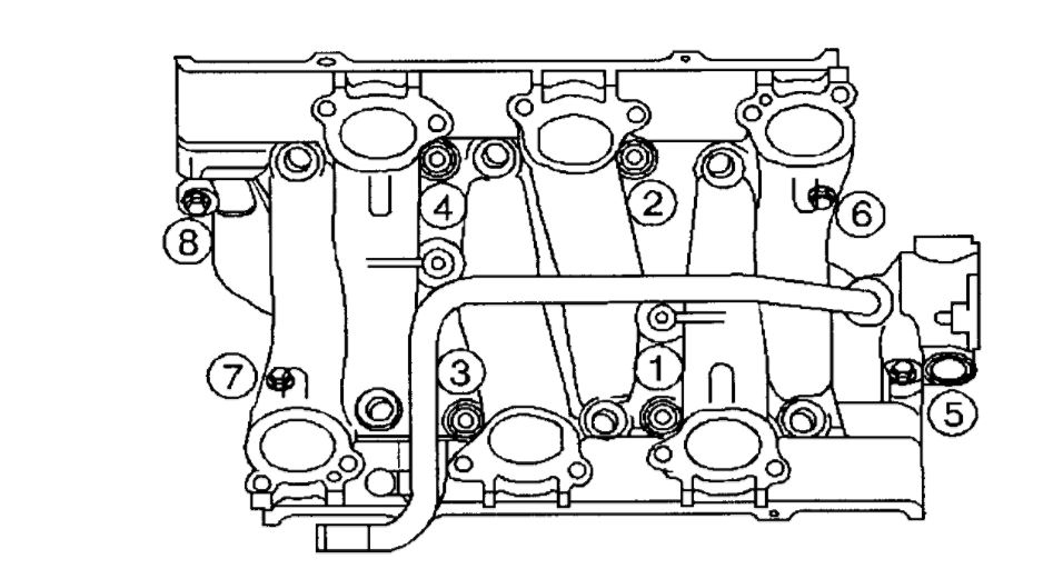

I need the torque specs for the intake manifold on my car listed above.

Attached is the sequence for tightening the bolts and specs.
Install new lower intake manifold bolts.
The torque specification is a two step process; tighten the vertical lower intake manifold bolts (the four middle ones) to 7 Nm (62 lb in). Tighten the diagonal lower intake manifold bolts (two on each end) to 7 Nm (62 lb in). Tighten the vertical lower intake manifold bolts (the four middle ones) to 13 Nm (115 lb in). Tighten the diagonal lower intake manifold bolts (two on each end) to 25 Nm (18 lb ft).
Upper intake manifold.
Tighten bolt/stud, 25 Nm (18 ft. lbs).
