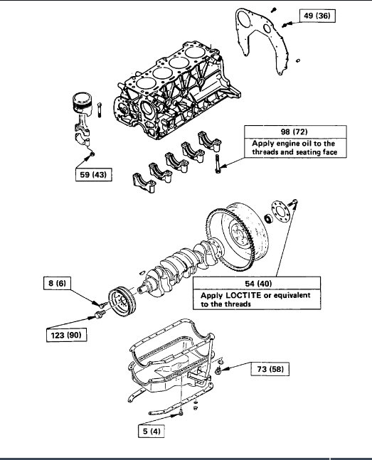

main bearing cap torque, rod torque.

I've attached a picture below of the specifications you're asking for.The first number is Newton Meters and the number in parentheses is Lb Ft. Hope this helps and thanks for using 2CarPros.
