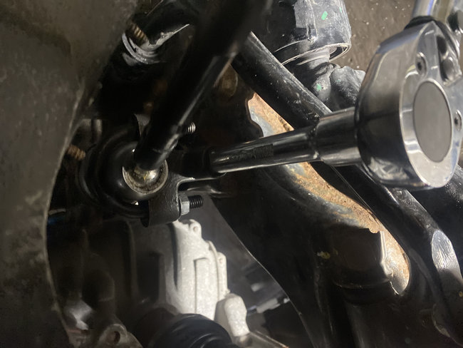

Inner tie rod to rack opinion.

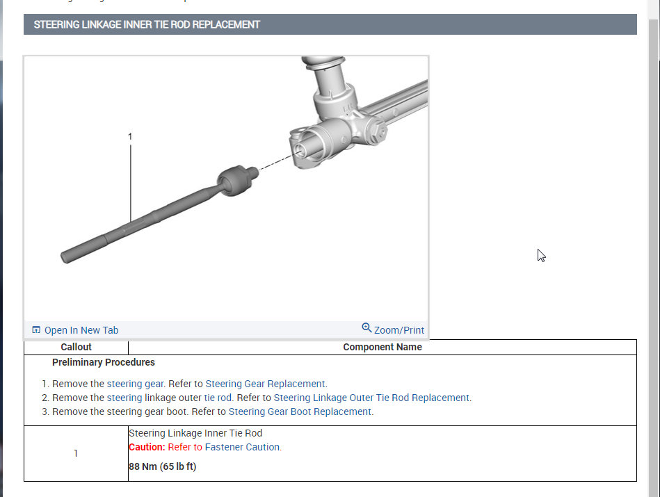

I attached the process and it includes the torque spec. Let us know if you need more info. Check out the diagrams (Below). Please let us know if you need anything else to get the problem fixed. Thanks
