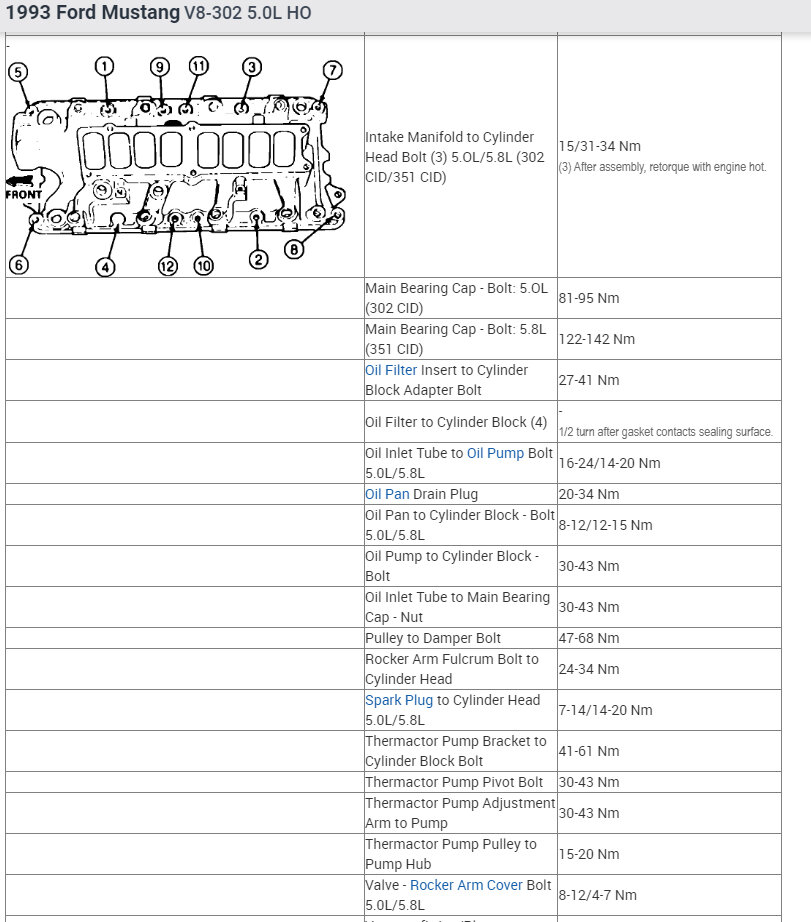

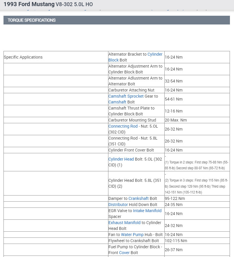

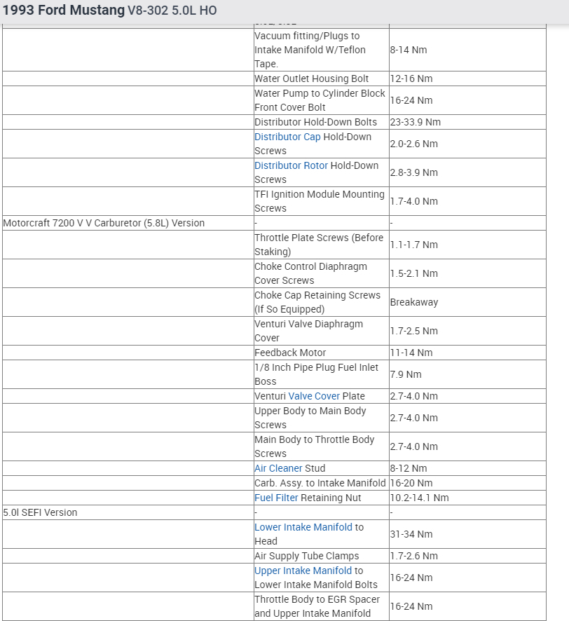

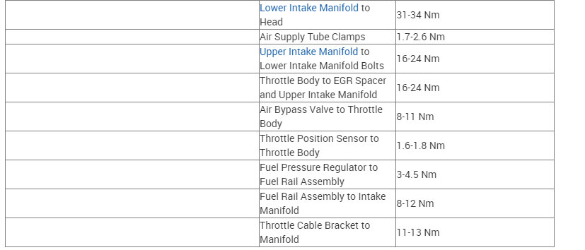

Hello, my name is Jr. I am currently building my 302-engine going mostly stock, trick and flow pistons, b303 cam, Edlebrock lower and upper manifold. I was wondering if you guys have a book or a website with a complete torque specs to tight down all my bolts to specs.

Please see attached for the factory torque specifications chart for the 5.0L engine.
Let me know of any questions.
Thank you.
