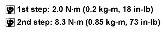

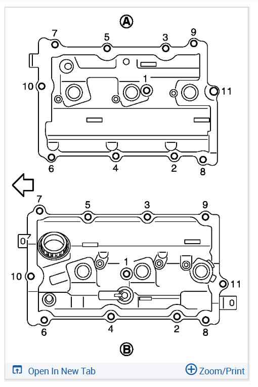

This has the 3.7l not the 4 cylinder. Need the torque spec for the valve cover gasket bolts please.
May 19, 2025 at 1:05 PM
CERTIFIED EXPERT
53,854 POSTS
Sure, here are the valve cover torque specs and the tightening sequence. Check out the images (below). Let us know if you need anything else.
