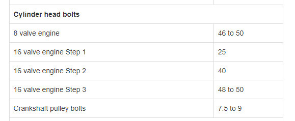

Unfortunately we don't have a manual on this vehicle as it is not offered here in the USA. Normally we provide the info from a vehicle that is the USA version or even a different vehicle with the same engine. However, we don't have anything similar to this.

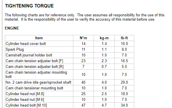

Which means I am left with trying to find specifics on the internet. I have found a couple sources that provide torque specs for different engines that apply to the size of the head bolt or style of head. They do not list the engines that this applies to so I am not confident that this will apply to your engine.
Please let us know if there are other ways we can assist and sorry we don't have a manual on this engine.
