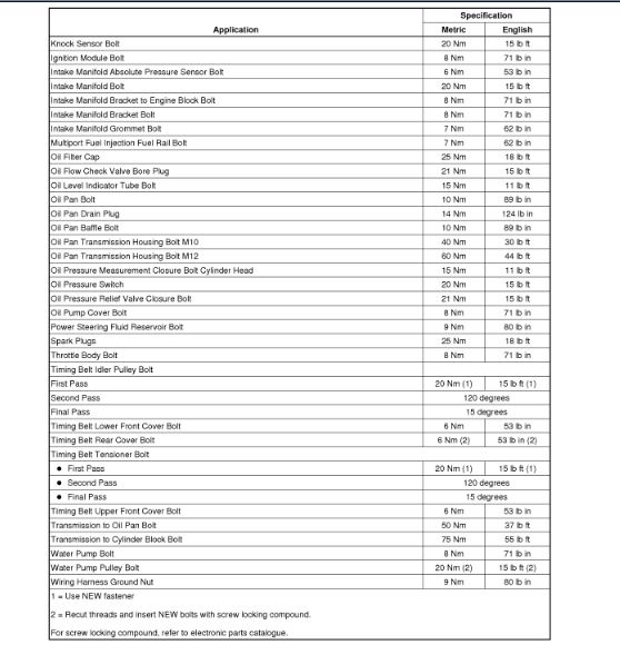

Hi, I need torque settings for my car listed above LS model.

What do you need the torque specs for? What operation as there are many areas of the car?

I need torque settings for big ends and mains.

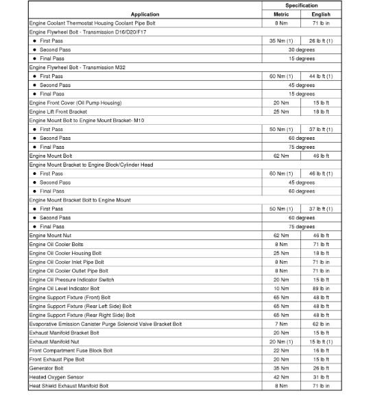

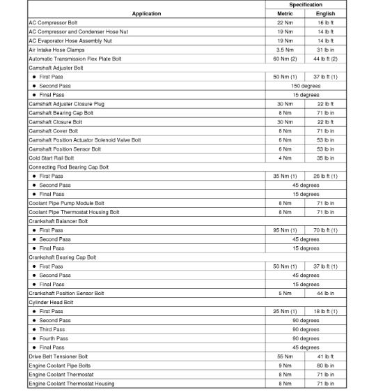

Got it.
Those specs are in the sheets I sent you. That is the specs for all the engines bolts.
