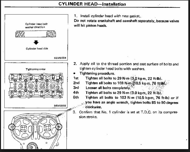

Head bolt torque setting.
May 23, 2017 at 4:26 AM
CERTIFIED EXPERT
53,854 POSTS
Here is a guide on the head bolt torque setting and how you should tighten them.
Image (Click to enlarge)
