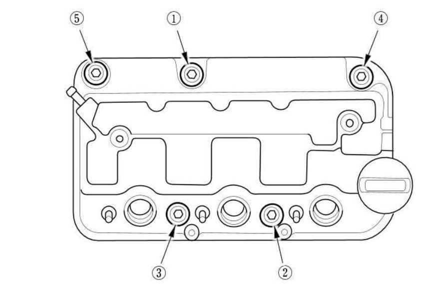

Good morning,
The specs are below for all the intake and the valve covers.
The valve covers are only 9 ft lbs.
Tighten the bolts and nuts sequentially in three steps. Always use a new intake manifold gasket.

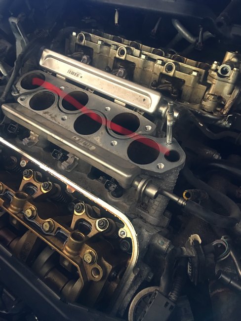

Thank you for the help. I need the torque specs for what I call the lower intake not sure what the proper name is. I’m including a photo I have drawn a line through part I’m talking about .

Those bolts were part of the spec I sent to you.

The specs you sent are for the plenum, plenum cover and valve covers, I want to change the gasket that is under the part with the red line on it attaches to the heads, again thank you for your help,
Jun 18, 2019 at 11:32 AM
CERTIFIED EXPERT
52,796 POSTS
Got it. Sorry, 21 ft lbs are the spec for the torque for those bolts.

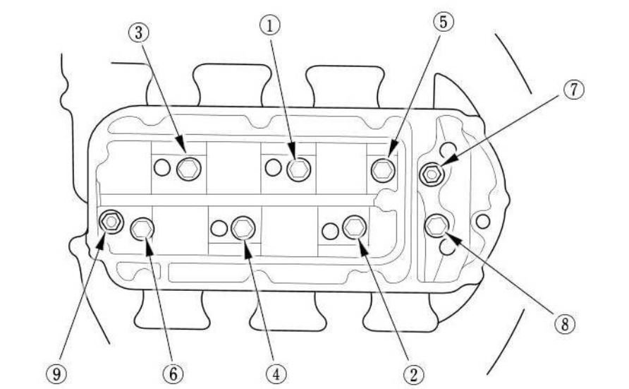

Would you happen to have torque sequence?
Jun 18, 2019 at 11:57 AM
CERTIFIED EXPERT
52,796 POSTS
It did not show me the sequence but center out is the sequence.

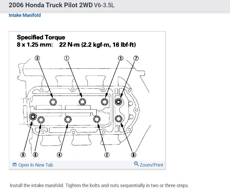

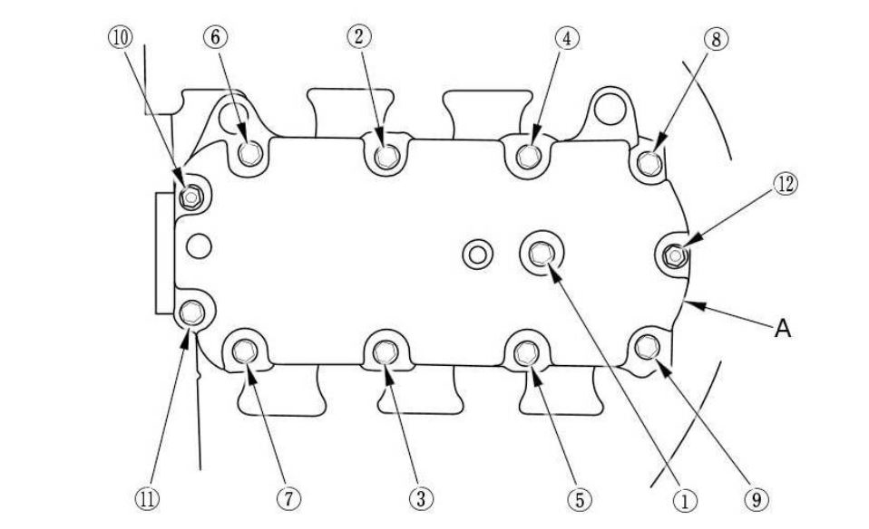

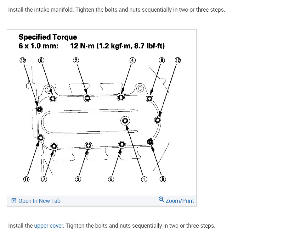

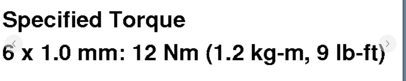

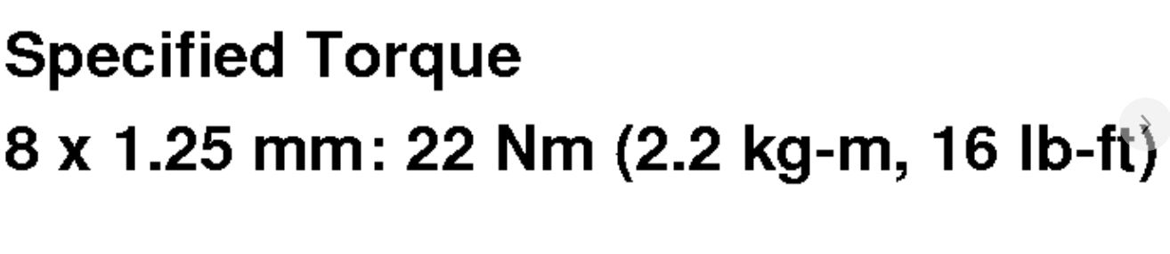

Does this apply for the J35A9 Engine in the 2006 Honda Pilot EX-L ?
May 14, 2023 at 11:54 PM
CERTIFIED EXPERT
53,854 POSTS
Here are the torque specs for the intake manifold which might be similar. Check out the images (below). Please let us know if you need anything else to get the problem fixed.
