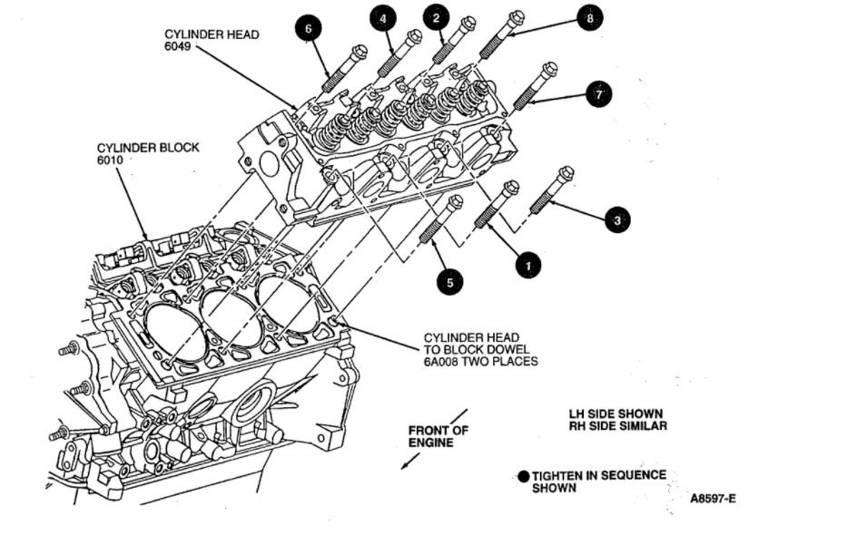

I am in desperate need of the car listed above ohv torque sequence for head bolts and intake.
Mar 22, 2018 at 12:48 PM
Good afternoon. the torque is below and the torque sequence is attached.
. Install new cylinder head retaining bolts:
- Tighten retaining bolts in sequence shown to 80 Nm (59 ft. lbs.).
- Then back off bolts 360°.
Caution: Always use new cylinder head bolts when installing cylinder head or damage to engine may occur.
5. Tighten the cylinder head retaining bolts in two final tightening steps in sequence shown in the following illustration:
- 50 Nm (37 ft. lbs.)
- 92 Nm (68 ft. lbs.)
Note: When cylinder head retaining bolts have been tightened, it is not necessary to re-tighten the bolts after extended engine operation.

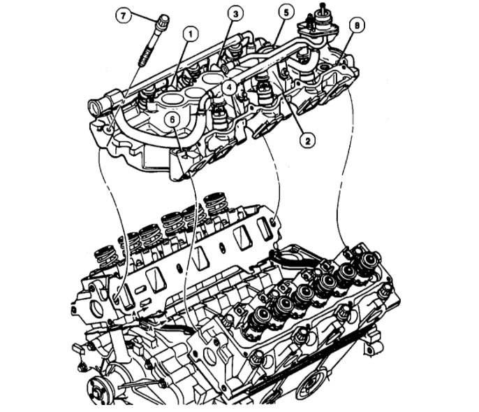

Intake manifold.
Torque intake manifold bolts in sequence shown in two steps: first to 15-22 ft lb, then to 20-24 ft lb.

Torque sequences are always the same. You start in the middle and work toward the ends while alternating sides.

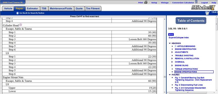

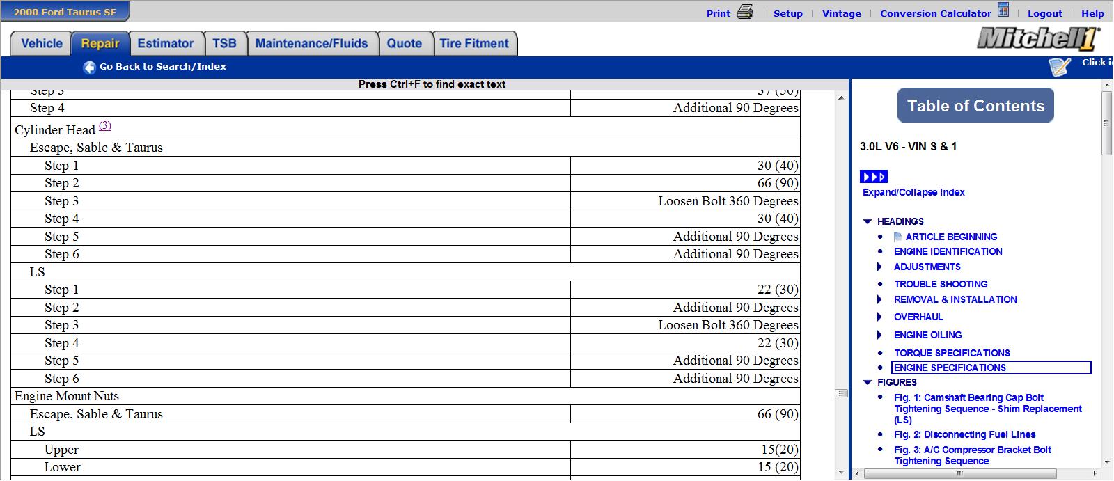

I need torque specs for 2000 taurus 3.0 liter v6 on head bolts. Thanks
Apr 17, 2019 at 6:42 PM (Merged)
RASMATAZ
  • 75,992 POSTS
3)Tighten bolts to specification, in reverse order of removal sequence.

PHOLLI
Could not read chart was blurry
