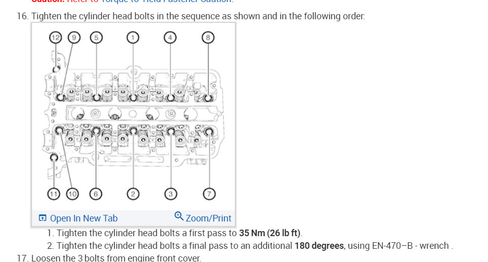

Hi, what is the torque pattern sequence on the cylinder head?
Mar 20, 2023 at 10:17 AM

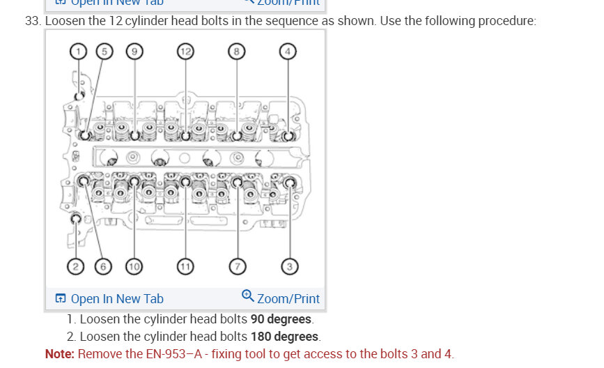

Here is how to loosen and tighten the cylinder head and be sure to check the sequence in the images below.
