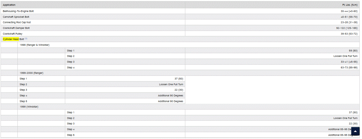

don't know ft lbs on bolts.

Check out the image below. This is the information, as provided by Ford to Prodemand. Hope it's clear enough for you. Let me know if there's anything else that you need, and feel free to come back to 2carpros anytime.
