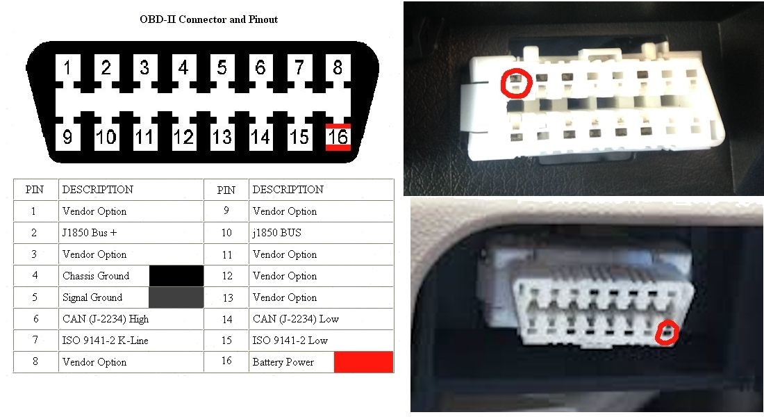

First, find the DLC connector, it will be under the dash with a cover over it and look like the first image below. It can mounted right side up (wide section up) or upside down as it likely is in your truck.
Take the piece of wire, strip the ends and twist them tight. (or cheat and use a small paperclip bent into a U shape) You want to connect the number 8 pin (transfer case module) and the number 4 pin (ground).
Number 8 is the pin directly opposite the pin with the red circle. Pin 4 is in the same row just count backwards from pin 8.
