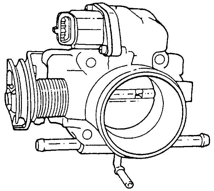

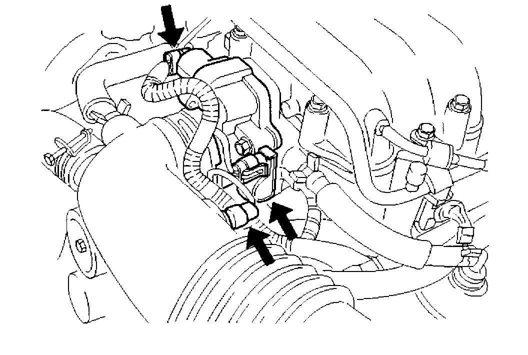

Anytime there is an idle issue, the first suspect is the idle air control valve (IAC). I would suggest removing it and inspecting if for carbon build up causing it to stick open. The component is located on the throttle body. I have attached two pictures for you so you can see where it is located. The second picture shows the IAC.
