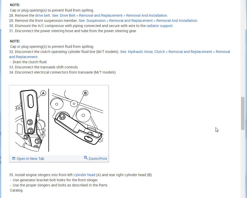

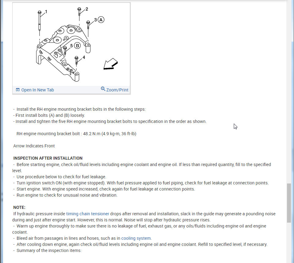

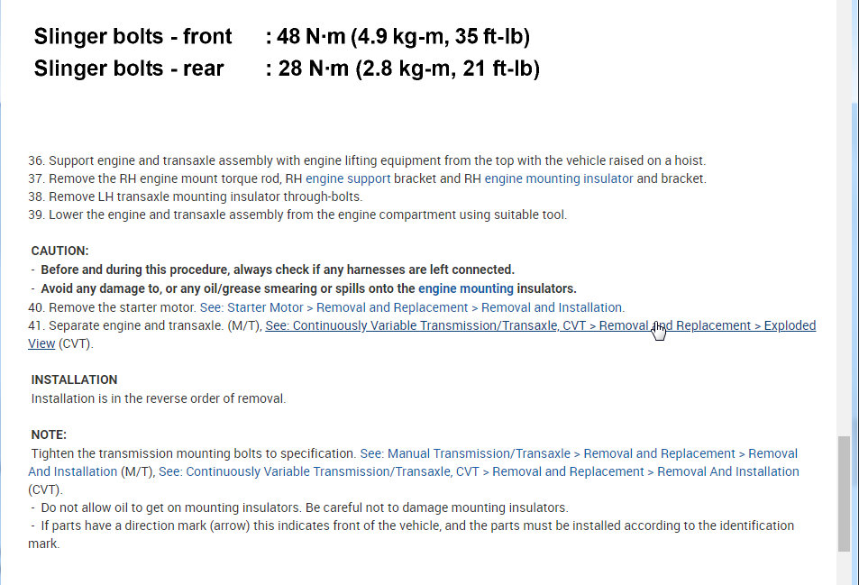

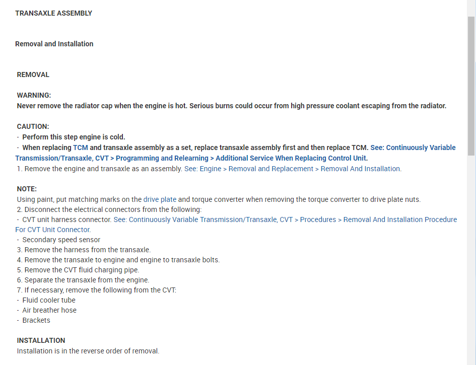

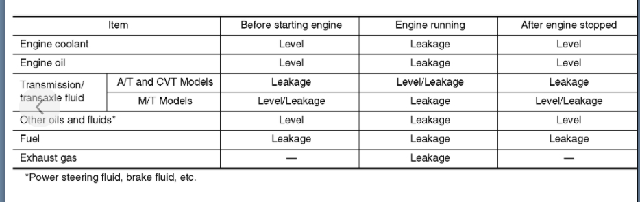

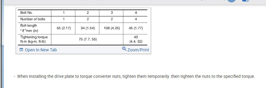

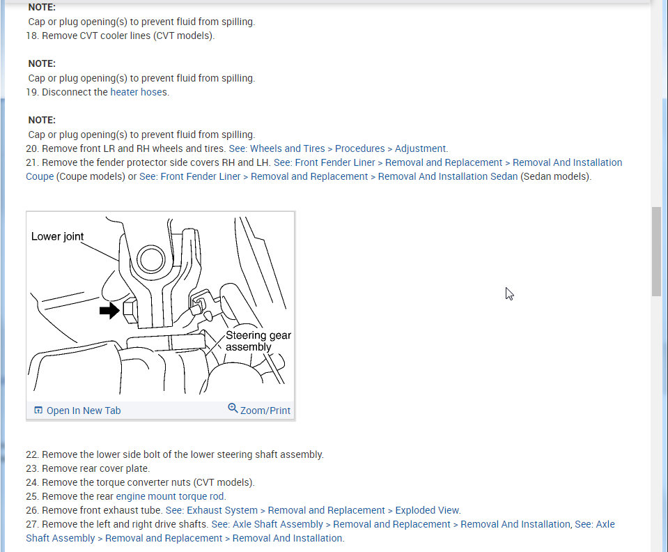

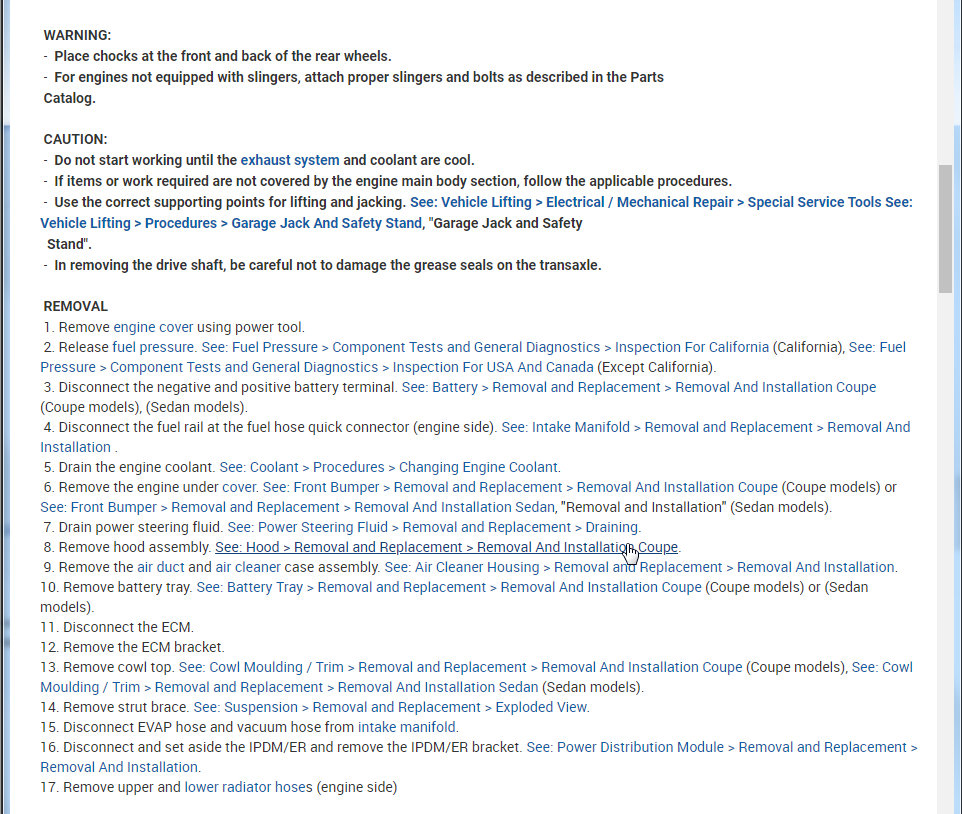

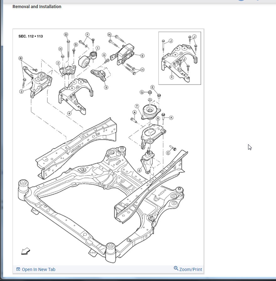

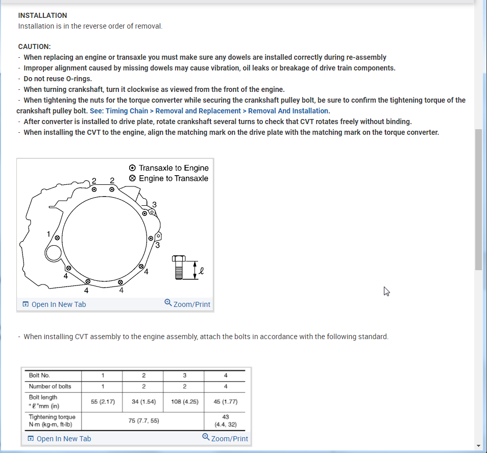

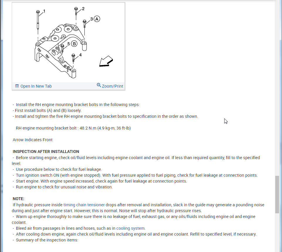

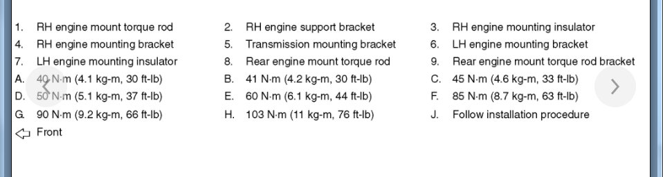

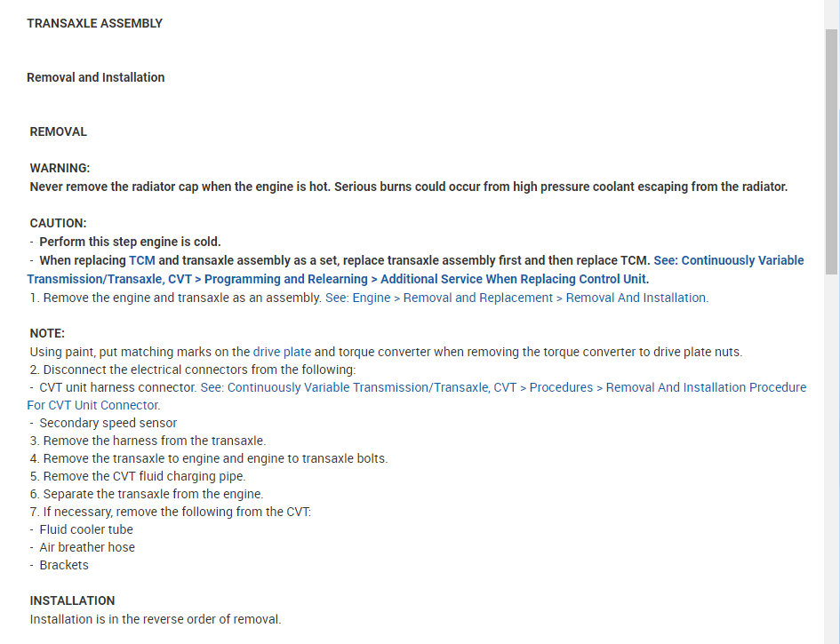

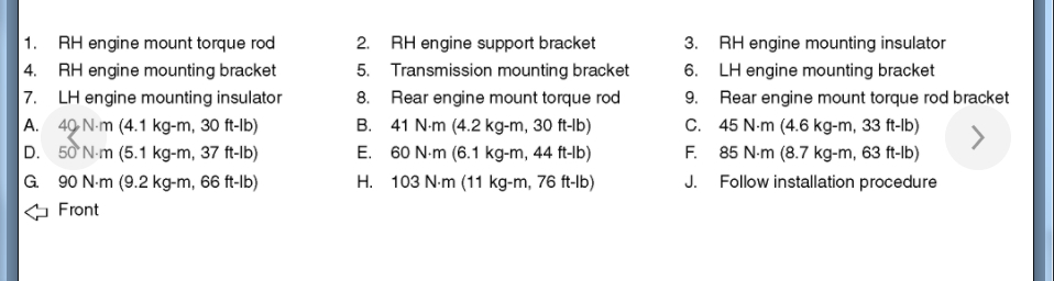

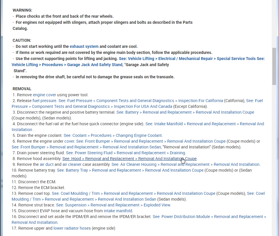

Here is the process on how to replace this from the manual.
Let us know if you have other questions. Thanks
