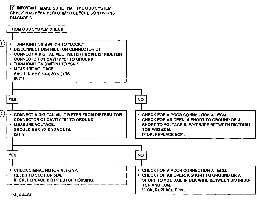

Got code 13 says no crank angle. But I replaced distributor and timing belt. All OME parts.
Aug 15, 2016 at 8:45 AM
HMAC300
  • 48,601 POSTS
check for a cracked distributor or rotor cap and connections at ECM then follow checks on chart. that code means there is no rpm signal so it may be a bad ECM.
