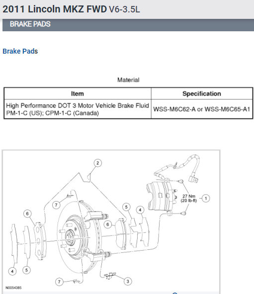

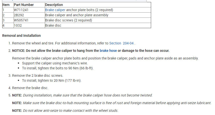

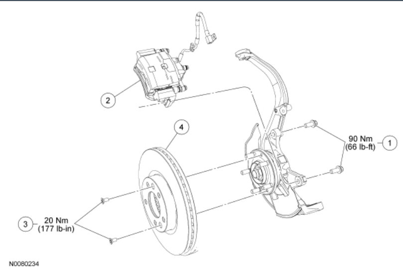

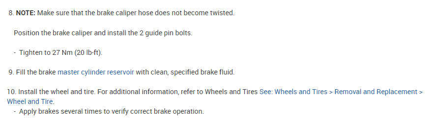

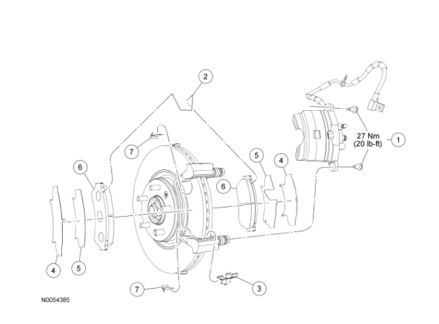

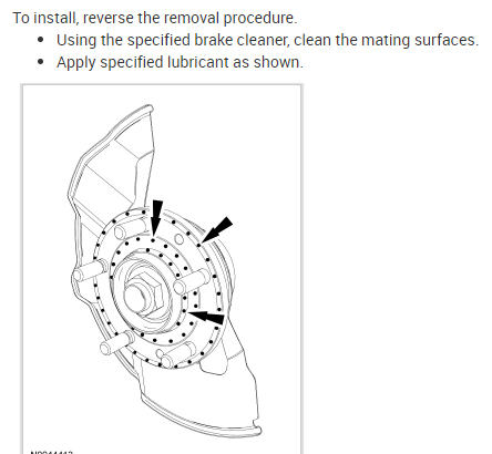

Can you tell me at what torque is used to tighten the caliber bolts for the rotor on my car listed above, plus I need to do brakes?
Apr 24, 2017 at 11:23 AM
DANNY L
CERTIFIED EXPERT
5,648 POSTS
Hello, I'm Danny.

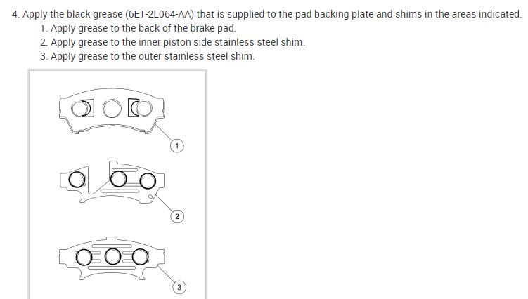

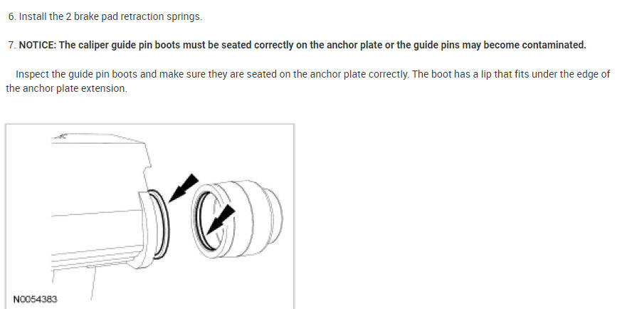

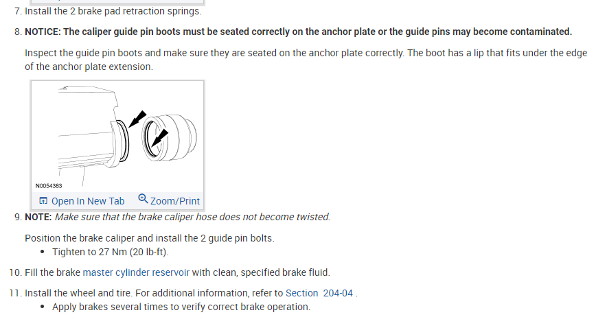

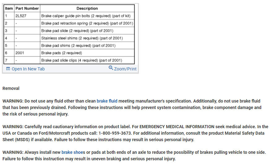

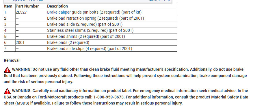

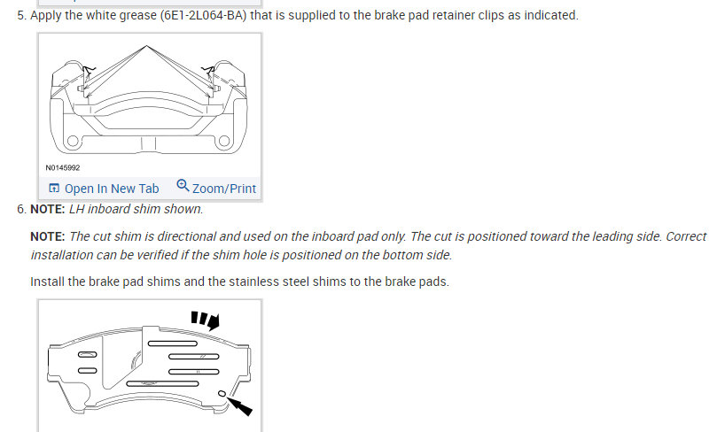

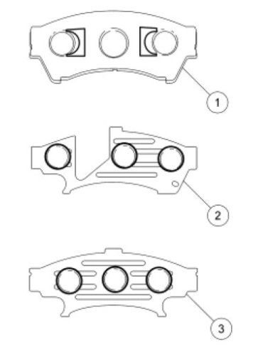

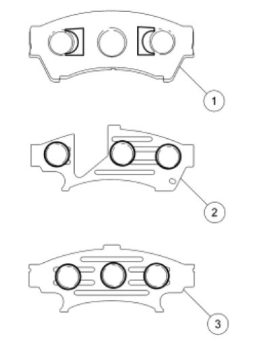

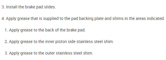

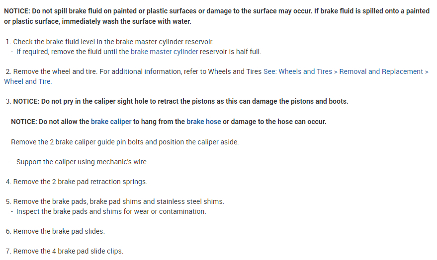

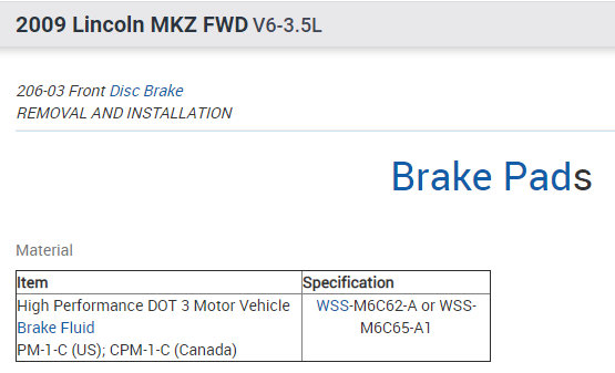

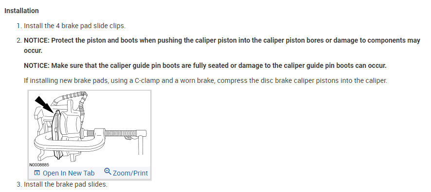

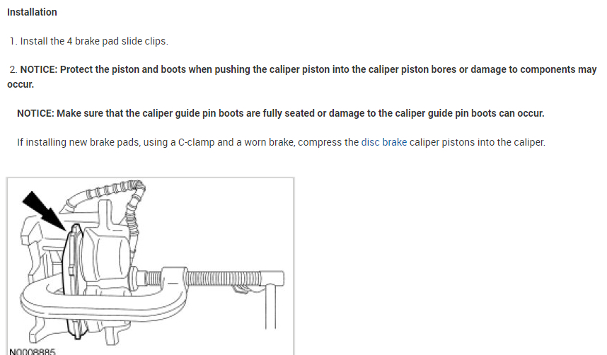

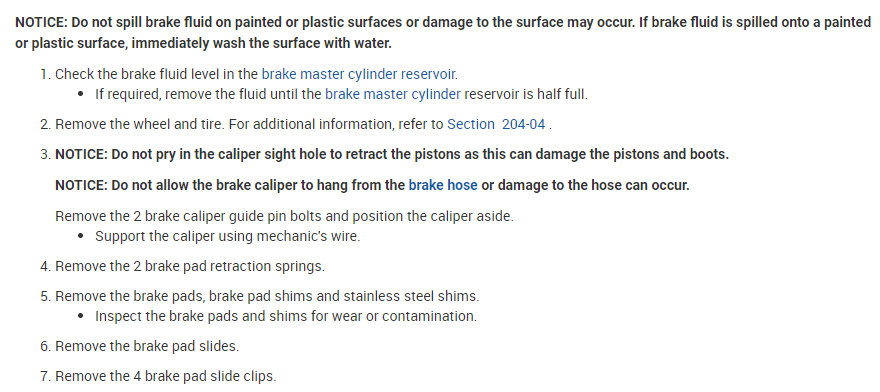

Here is the information you requested and the caliper bolt torque is on the picture. This is a tutorial showing what is involved on how to change front brake pads and brake rotors:
