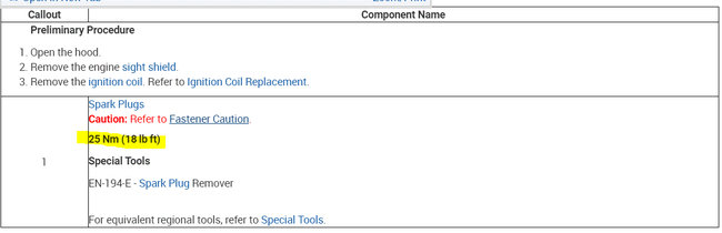

what the foot pounds on spark plugs?

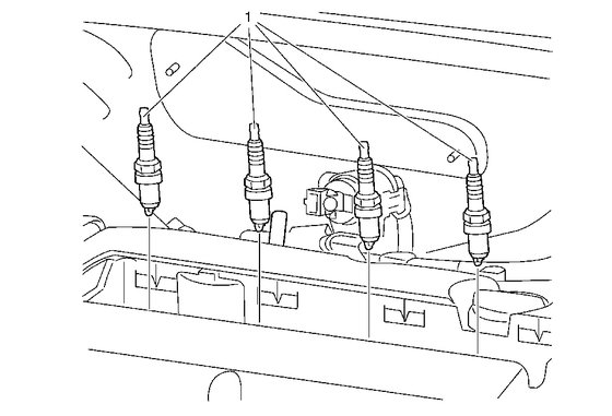

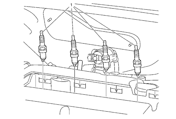

If you look at the two pictures below, it's right from the manual for this vehicle. Let me know if it helps. Check out the diagrams (Below). Please let us know if you need anything else to get the problem fixed.
