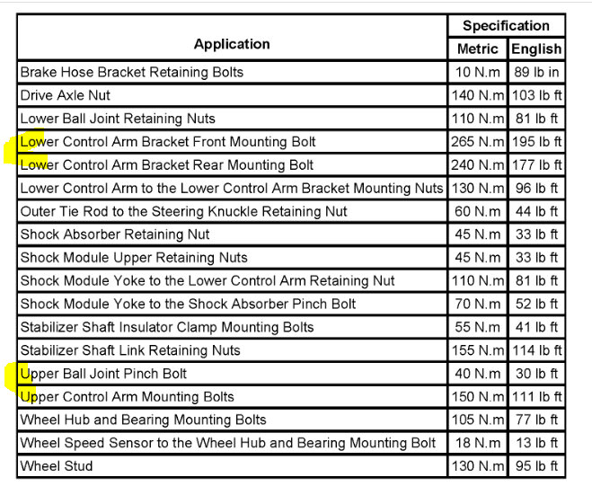

What is the torque for upper and lower arm bushings?
2006 GMC ENVOY
200,000 MILES • 6 CYL • 4WD • AUTOMATIC
ANGEL VAZQUEZ
Jul 31, 2024 at 4:26 PM
I attached the torque specifications for the entire front end. Note there are different specifications based on if the bolt is forward or rearward facing.
See pic below.
