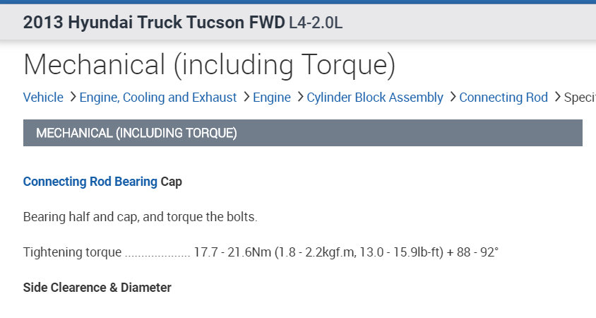

What is the torque specification for the connecting rod caps?
Nov 14, 2019 at 9:39 PM
SCGRANTURISMO
CERTIFIED EXPERT
4,897 POSTS

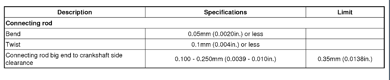

I have included the information that you requested in the diagrams down below. please get back to us with how everything turns out. I hope this helps.
