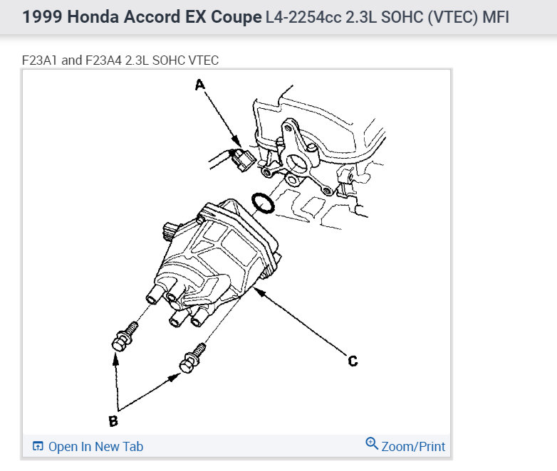

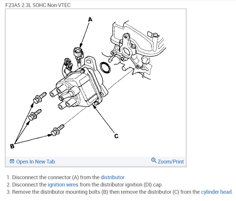

The cars not starting at all just sits cranking! There’s no spark at all so I’m thinking maybe it’s the distributor cap so I’ve ordered a new one but if it’s not that then I don’t know what it’s going to be
May 14, 2019 at 12:03 PM
Yep this is a common problem, remove the distributor cap and look for rust colored dust inside which is a clear indication it has gone bad. Can you please shoot a quick video with your phone so we can see what's going on? that would be great. You can upload it here with your response. Here are instructions to change out the distributor. Check out the diagrams (below). Please let us know what you find.
