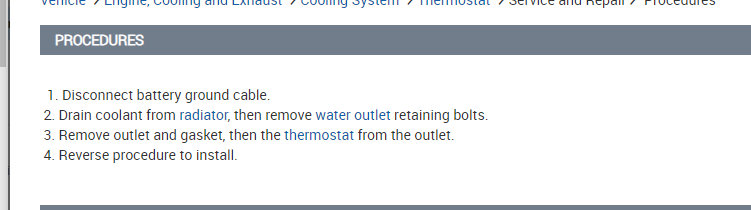

Plus here is a guide that will help with replacing this as well:
Below is the process from the manual. Please run through this material and let us know if you have other questions. Thanks
