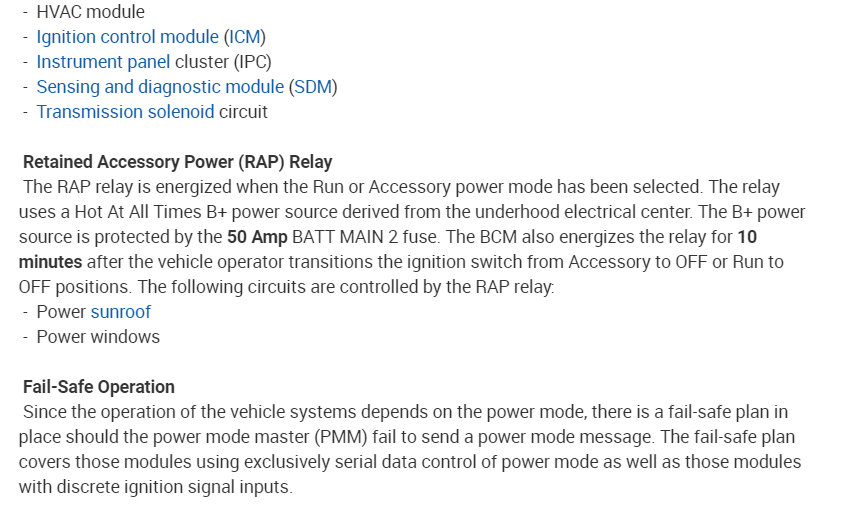

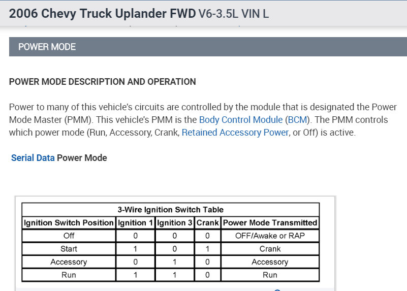

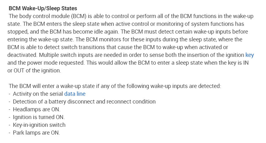

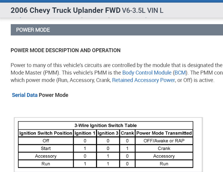

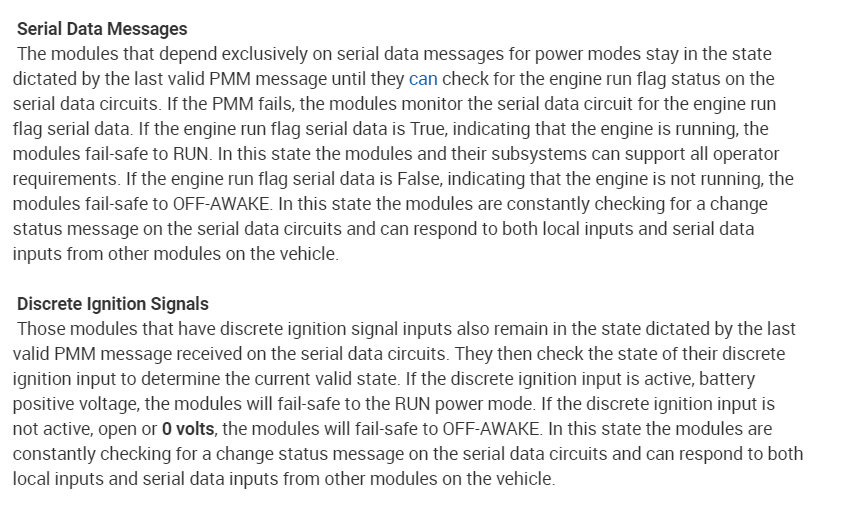

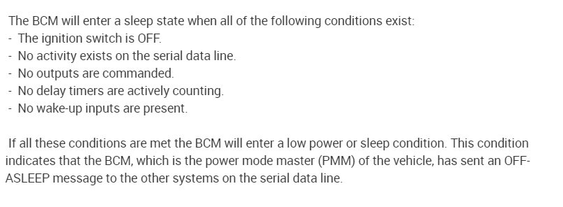

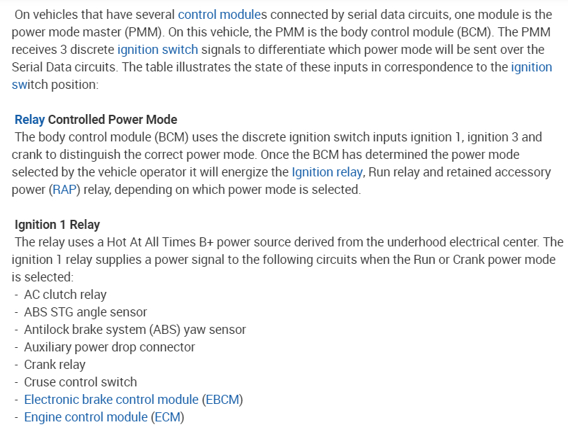

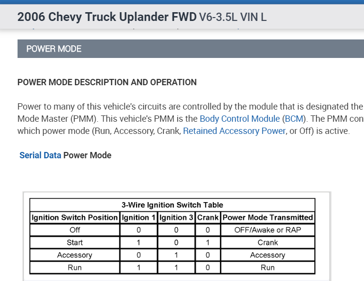

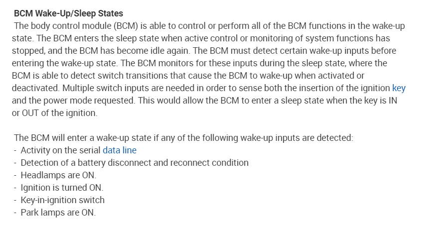

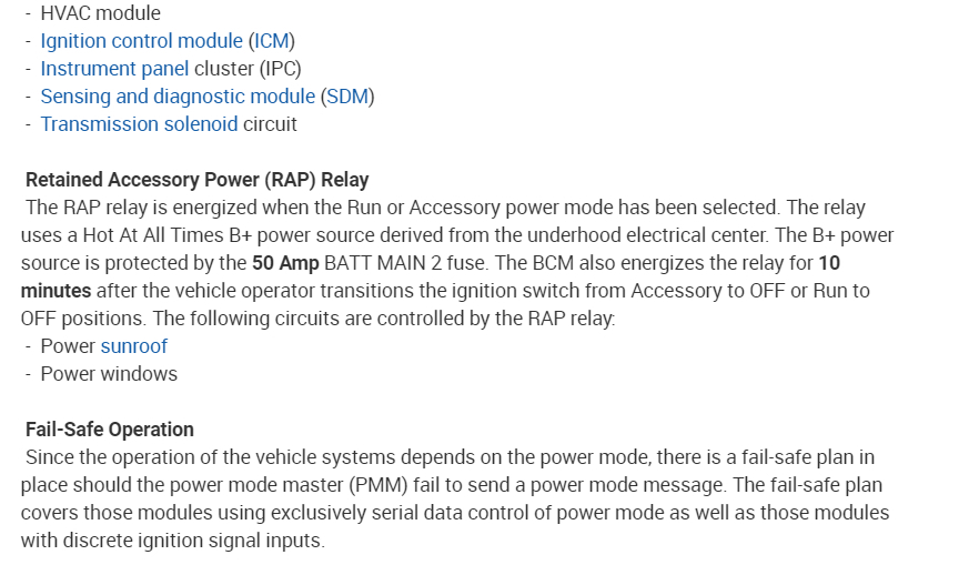

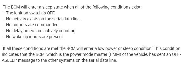

I have included everything I could find on "limp mode" for your vehicle in the diagrams down below. Please go through this material and get back to us with what you are able to find out please.
Thanks,
Alex
2CarPros
