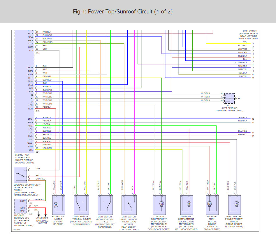

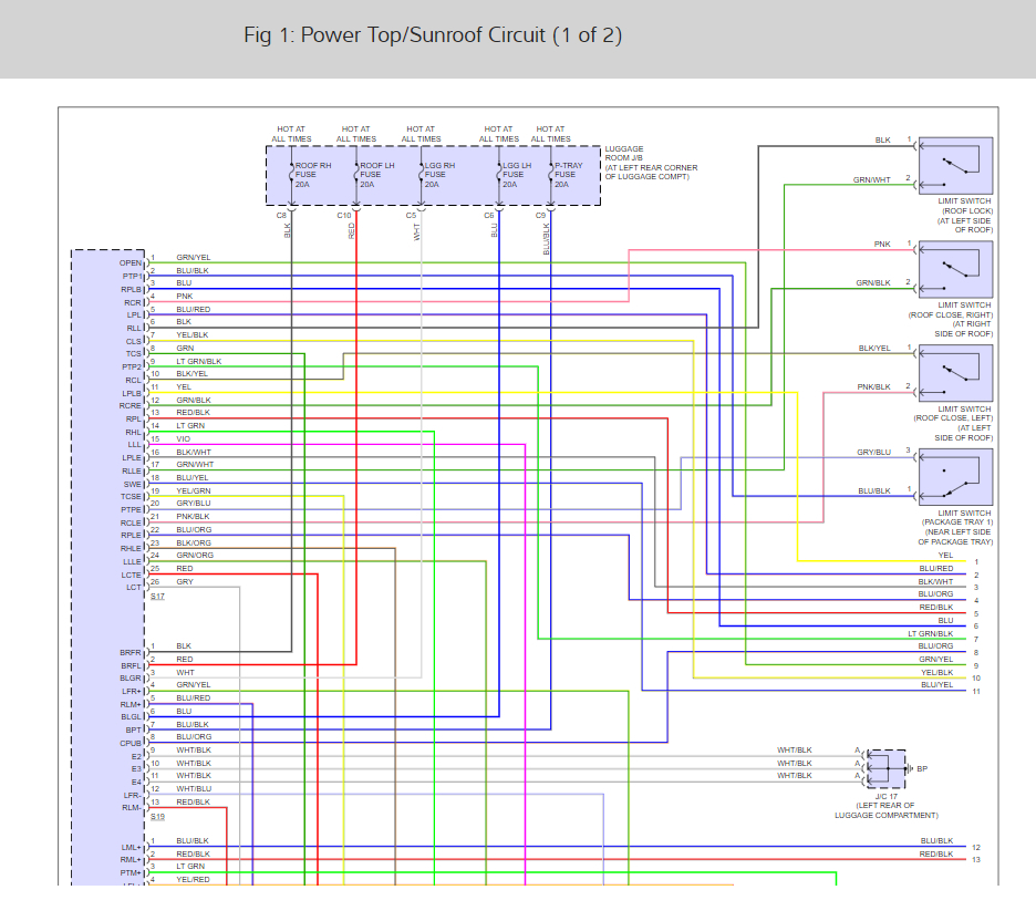

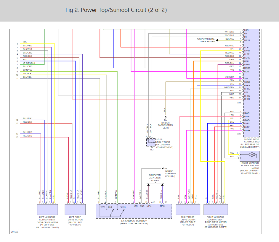

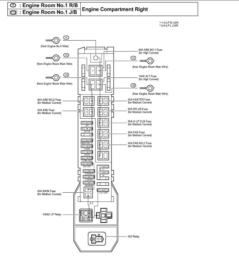

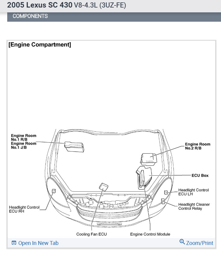

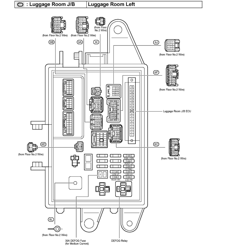

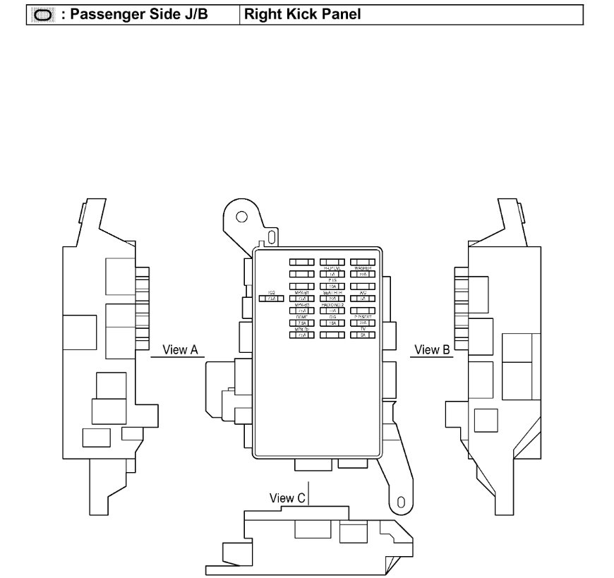

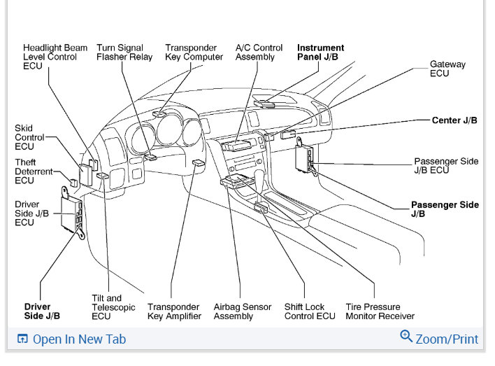

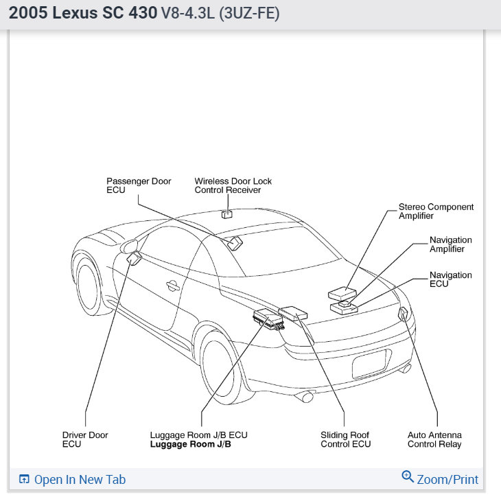

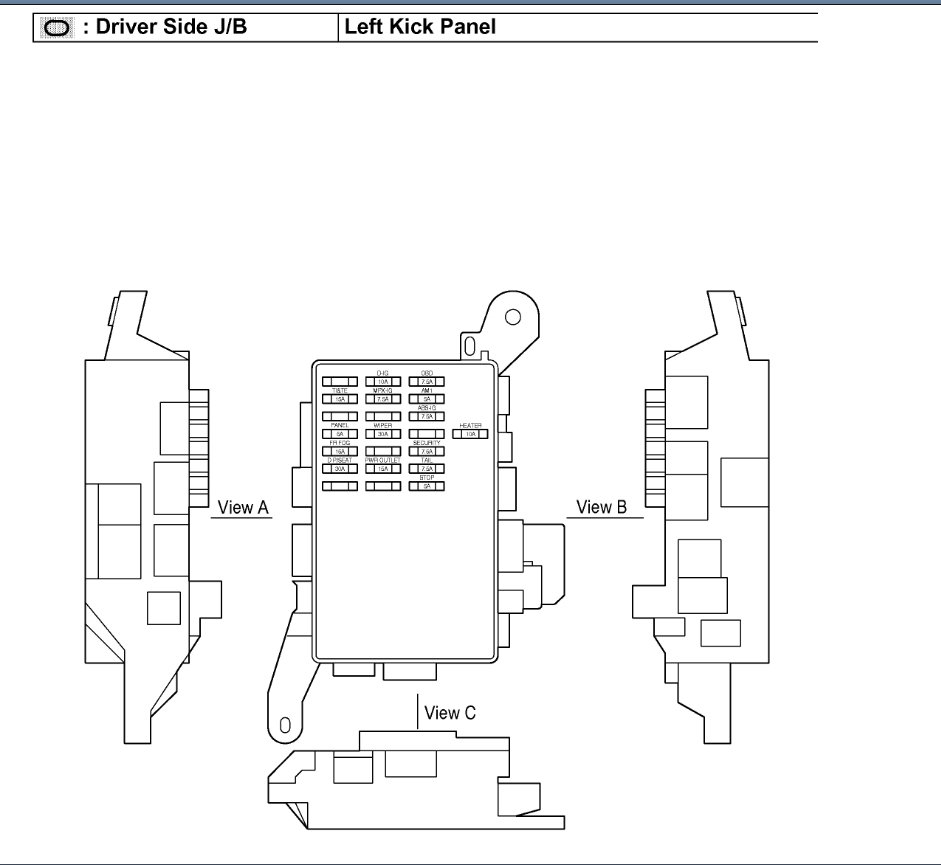

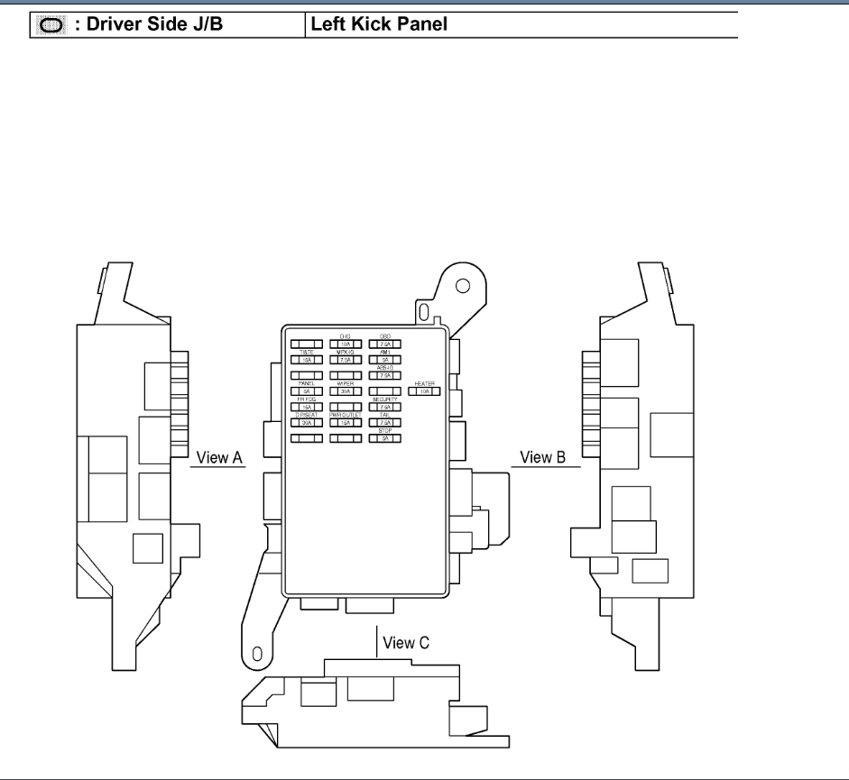

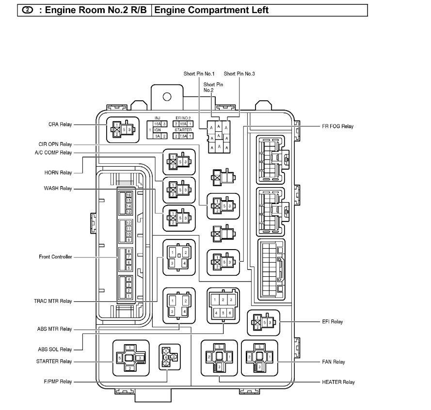

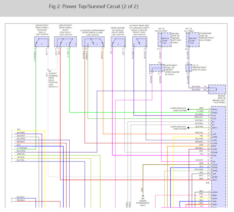

There are five fuses that run the system. here are the convertible top wiring diagrams so you can see how the system works and a guide to help you check for power at the fuses with the fuse locations as well. The fuses you need to check are at the top of the diagrams.
