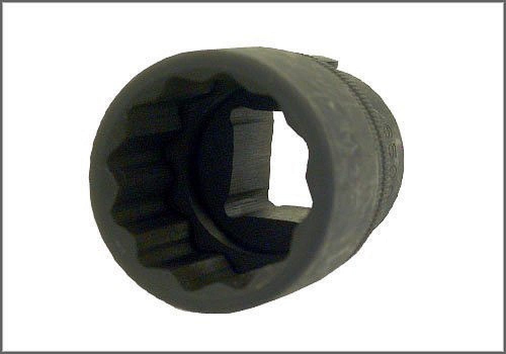

VW/AUDI AXLE NUT SET - AST TOOL # 6500
VW/Audi Axle Nut Set
Picture 1
Picture 2
Picture 3

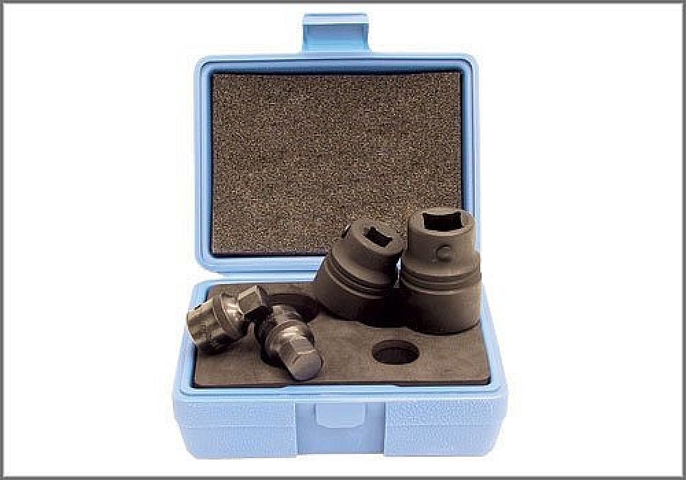

VW/Audi axle nut set. Contains:6500-14, 6500-17, 6500 X-30, and 6500 X-32.

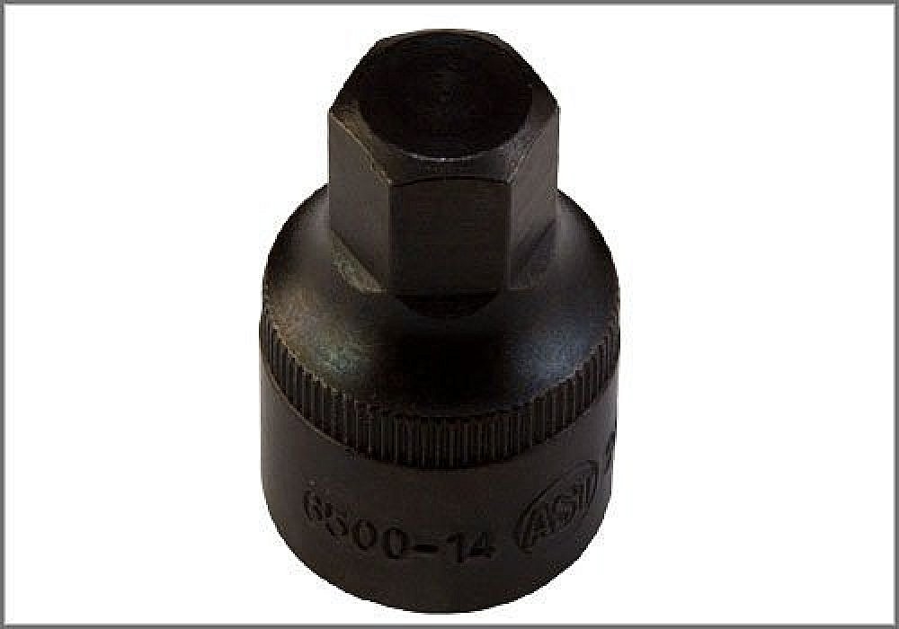

- 14mm allen for VW Passat 1996-2001, Audi A4; front and rear axle bolts (AWD)
- 17mm allen for 1998-2005 VW Passat, 1999-2004 Audi A6, 2002-2005 Audi A4; front and rear axle bolts (AWD)

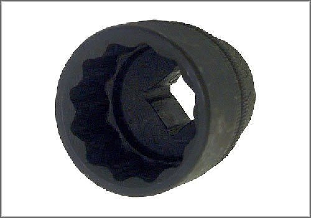

- 30mm 12 point socket for mid 1999-2005 VW Golf, Jetta, Cabrio, and Beetle; front axle nut
- 32mm 12 point socket with a 3/4" drive, VW Touareg; front and rear axle nuts
Contact AST for pricing.

This Kit Contains the Following Tools:
Picture 4

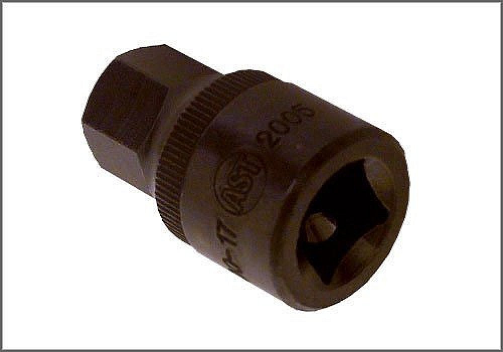

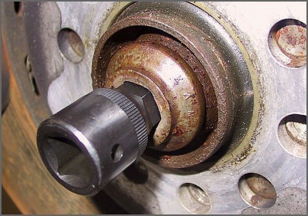

6500-14 - 14mm Allen Socket
Picture 5
6500-17 - 17mm Allen Socket
Picture 6
6500 X-30 - 30mm, 12-Pt. Socket
Picture 7
6500 X-32 - 32mm, 12-Pt. Socket
The tools above are related to removing the axle nut. The inner part which is bolted to the transmission most likely uses what is called a triple square spline type tool. It is similar to a torx type bolt, but has more splines,

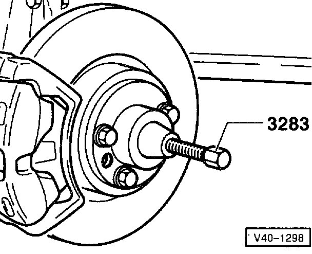

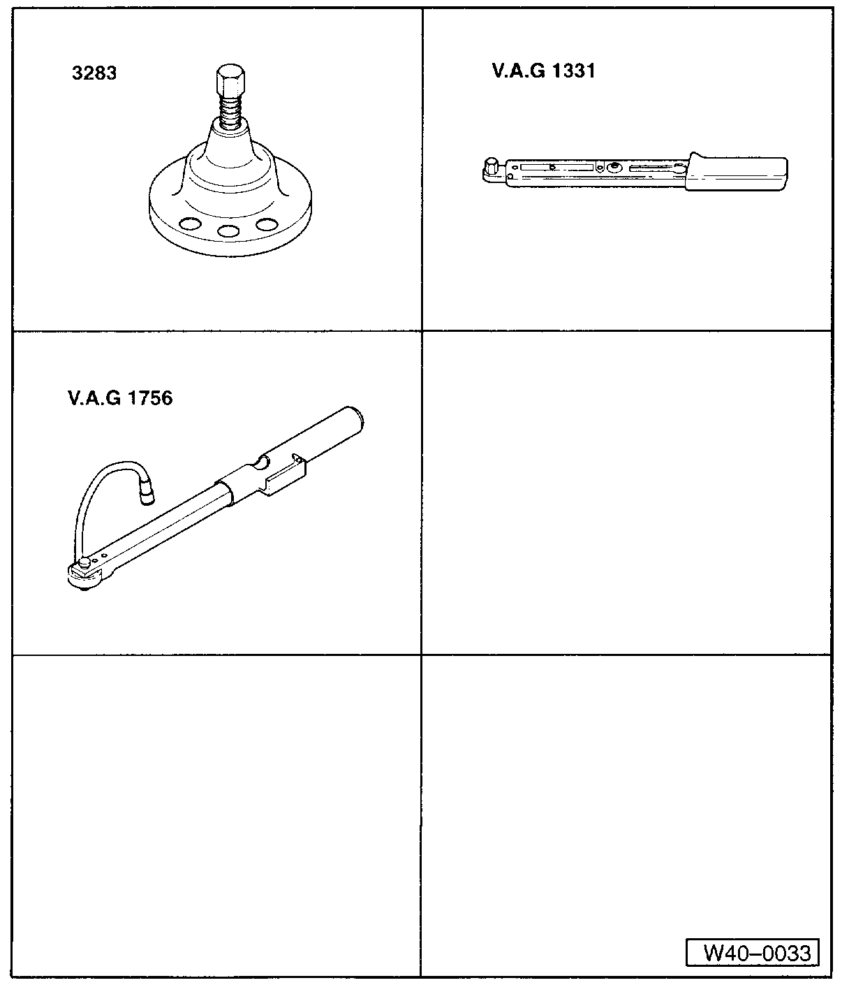

Special tools and equipment
Picture 8
- 3283 hub puller
- VAG1331 torque wrench
- VAG1756 angle measuring wrench

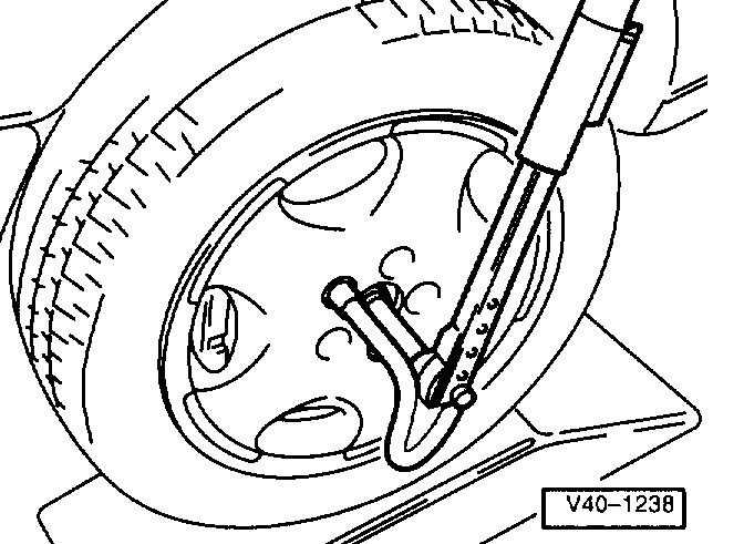

- The wheel bearings must not be loaded when the 12-point nuts are loose.
- If the wheel bearings are loaded by the vehicle's weight, the bearings will be stressed and their service life reduced
- If a vehicle has to be moved after removing the drive axle, first install the outer CV joint and tighten to 50 Nm (37 ft. lbs.) otherwise the wheel bearing will be damaged
- Lift vehicle until load on front axle is relieved.
- Loosen 12-point nut.

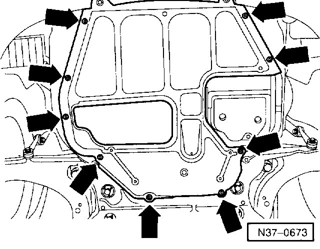

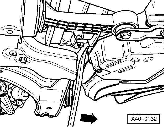

- Remove noise insulation panel (arrows).
Picture 10

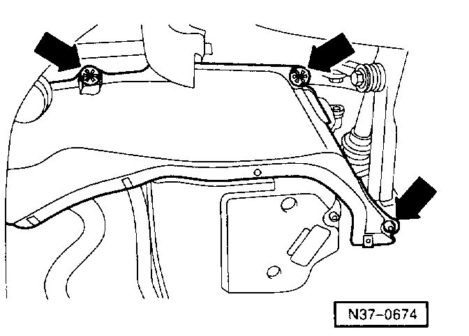

- Remove left-side noise insulation (arrows).

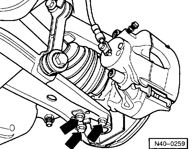

- Disconnect drive axle from transmission drive flange.
- Mark installation position of ball joint bolts on control arm.
Picture 11
- Remove bolts (arrows).
Picture 12
- Press drive axle out.

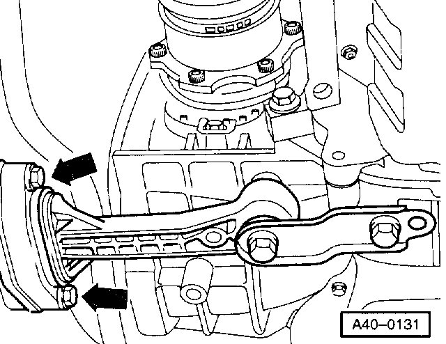

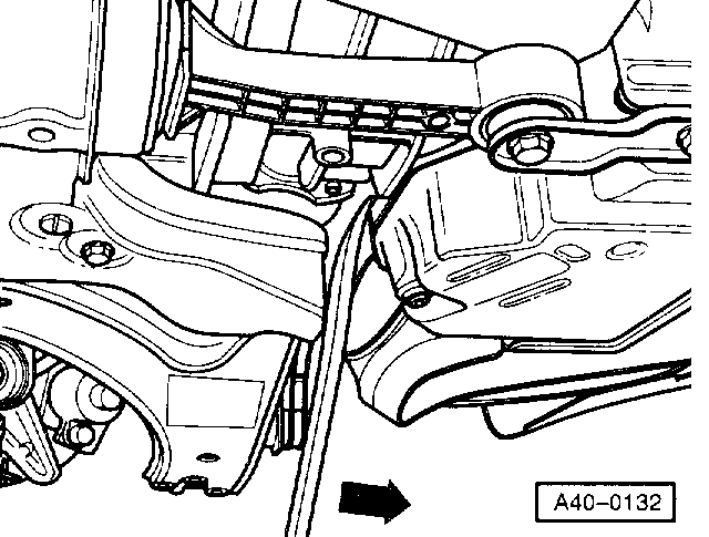

Picture 13
Picture 14
- Push engine/transmission assembly forward (i.e. using lever).
- Remove drive axle.
Note:
- The arrow in the illustration points forward.

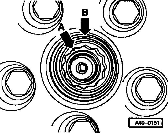

- Mark point on nut with line (arrow -A-).
- Mark 2nd line (arrow -B-) on edge of wheel hub above next point.
The distance between each point is 30°.
- Tighten 12-point nut until both lines align.

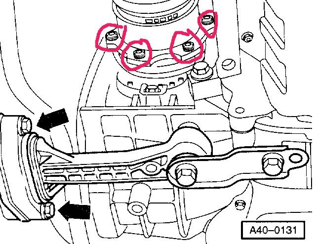

In the top part of picture 13 there are axle screws or whatever they are called. I can't get them out because they are stuck. Any suggestions on how to get it unstuck?
Jan 21, 2019 at 10:45 AM
Most likely, they aren't stuck but just tight. Honestly, I always use an impact gun to remove them. Do you have access to a compressor and impact gun? Is it the triple square bolts?

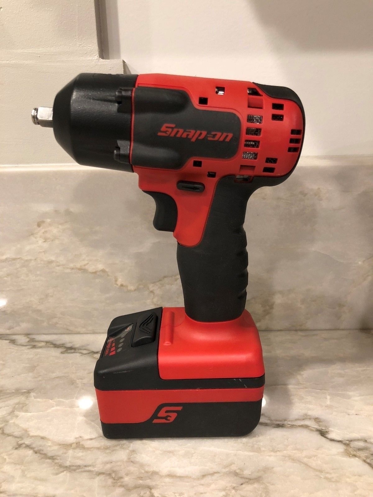

I always use extensions and I have a solid swivel extension that I put the triple square on. With the wheel removed, I go right through the inner fender. You will have to keep turning the axle so you can access one of the bolts at a time. I was taught a long time ago to make the tools do the work, so I usually have about two feet in extensions. LOL I also use a snap on 3/8 impact. Everyone laughed at me when I got it, but it is by far the greatest tool I've ever had. It makes jobs so much easier and faster.
I will tell you that it won't remove the axle bolts. I use an air impact to break them loose, then remove them with the electric impact. I attached a picture of what I am referring to.
Try what I suggested.

Just to be clear you are referring to the axle flange bolts I circled correct? Those should be a M10 triple square unless someone changed them or they rusted. They get a lot of crud in them sometimes. It sounds like they may have been loctited in, red will make them almost welded unless you apply heat to them. I would wrap a damp rag around the parts on both sides of the flange, then heat the rear flange, then give the head a good smack with a hammer and either the socket or a swedish pipe wrench or basin wrench style tool that will grip harder as you push on it, most vice grips don't do that and they don't get a good grip on the head either.
