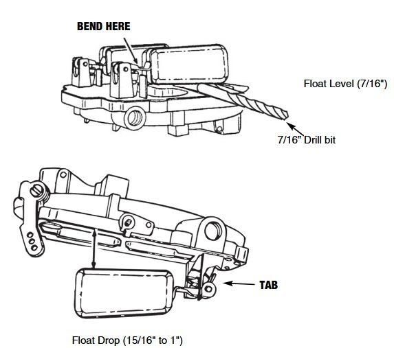

On that carburetor you pull the top cover off of the carburetor. You want the gasket to stay with the top. Then flip the top over and measure the space between the float and the gasket. You want 7/16" between the two. Next you turn the part so the float hangs down and measure the same place and you want to see one inch of float drop.

Hi Steve. You were right on with the float needing to being reset. I did as you said and it stopped spiting out the top. Also, I put the new regulator on and set it at 5#. It was up to 8#. Now I have my car back and I am loving it.
