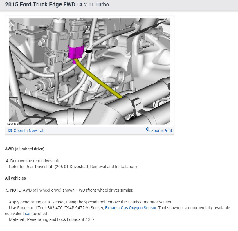

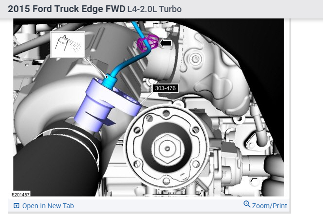

The downstream sensor is located on the upper part of the pipe. You will have to remove the driveshaft to access it.

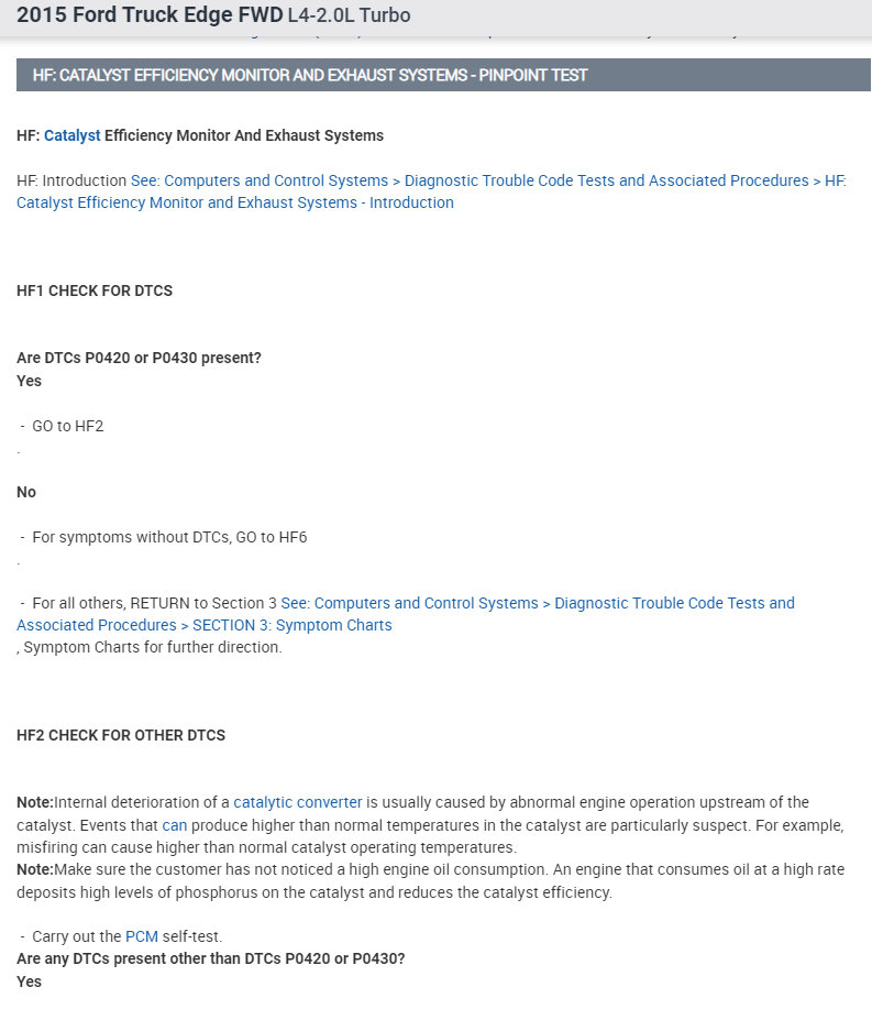

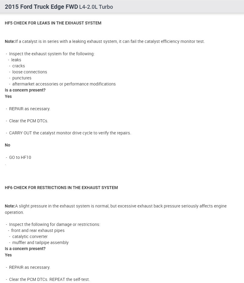

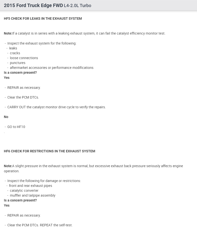

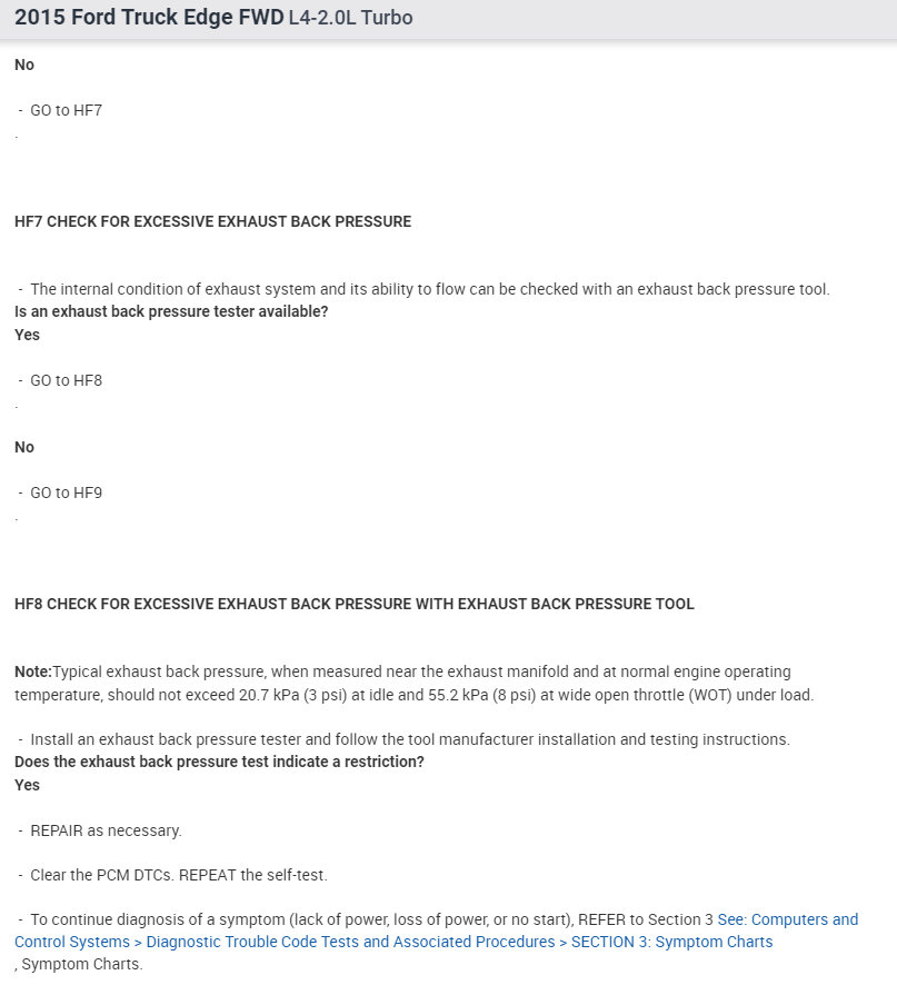

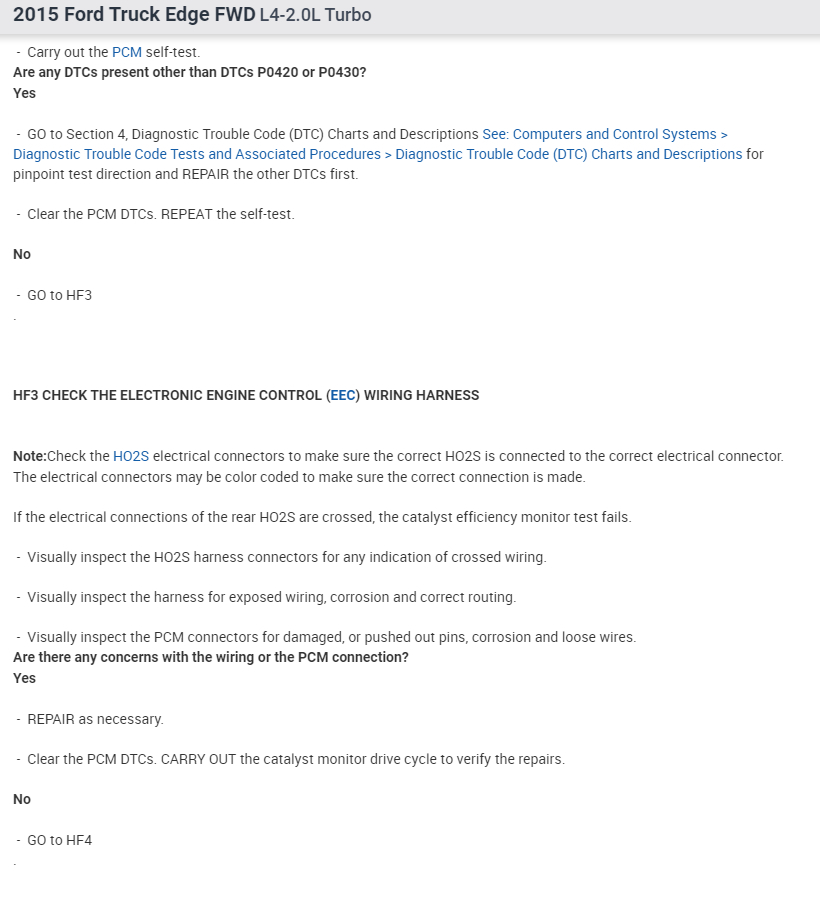

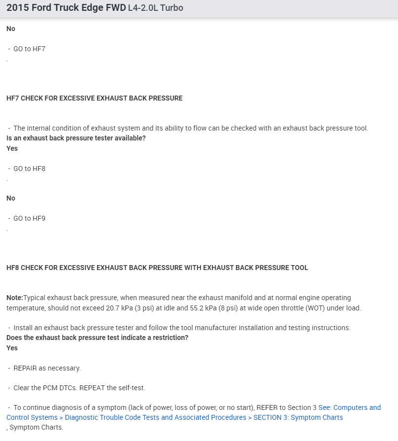

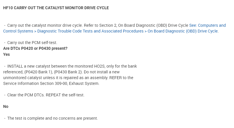

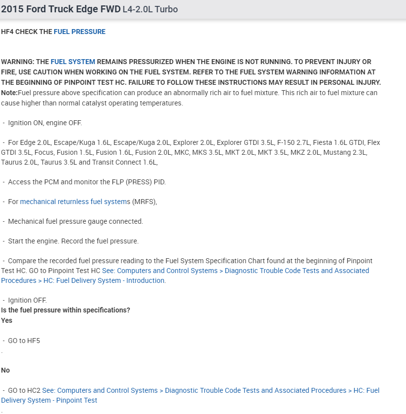

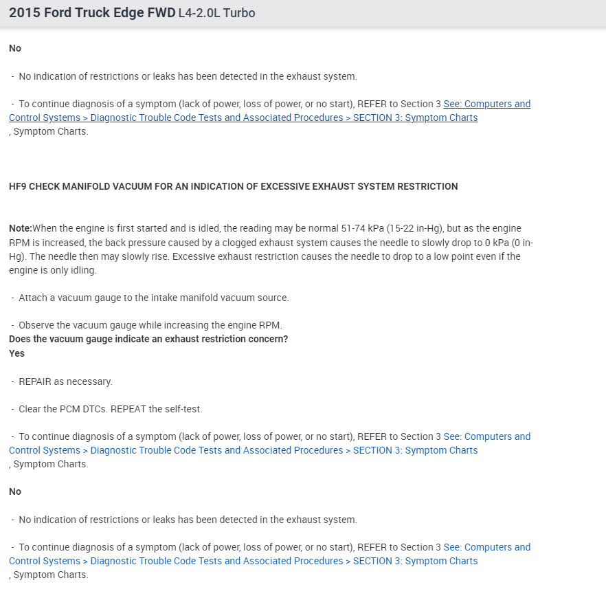

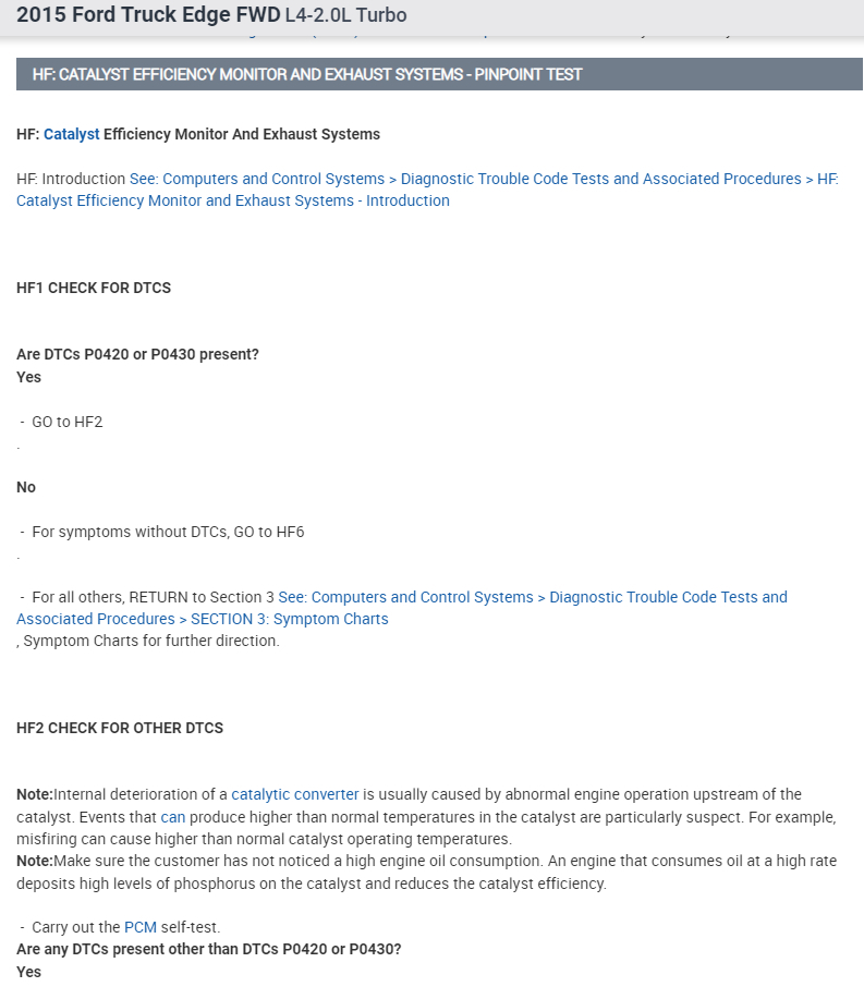

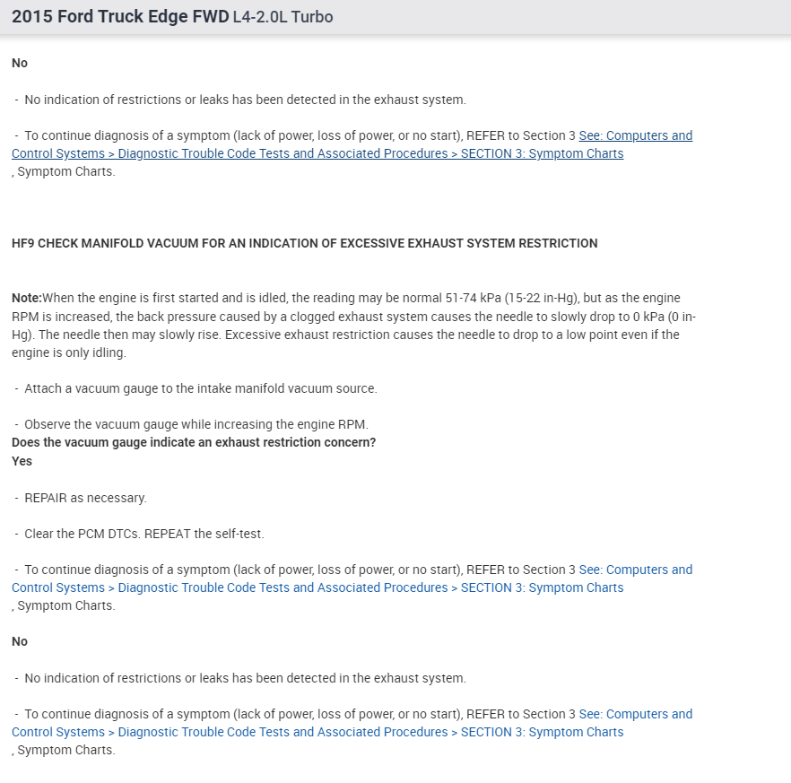

I have attached the diagnostics for the codes below for your reference.

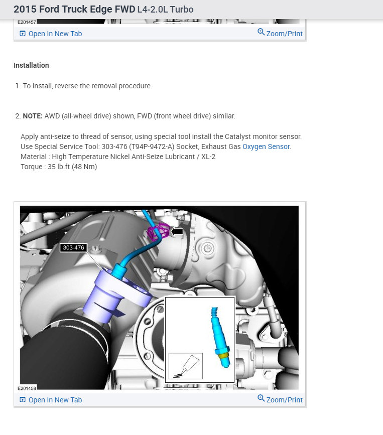

Also attached is the oxygen sensor replacement procedure.
