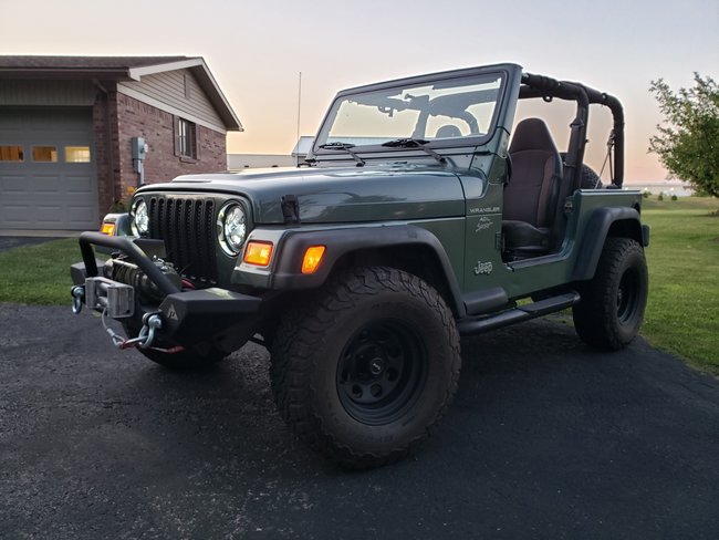

Never posted a pic of your rig?

Sure thing!

Really nice!
Take care of it and will last forever!
