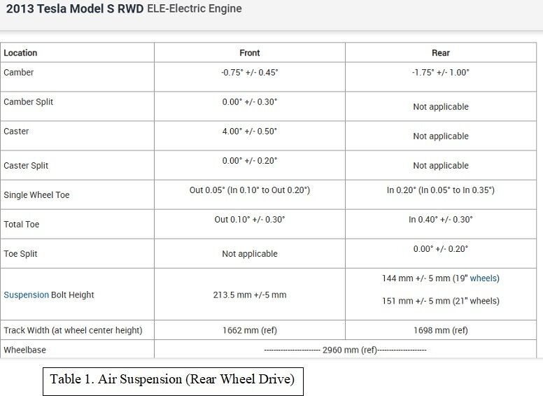

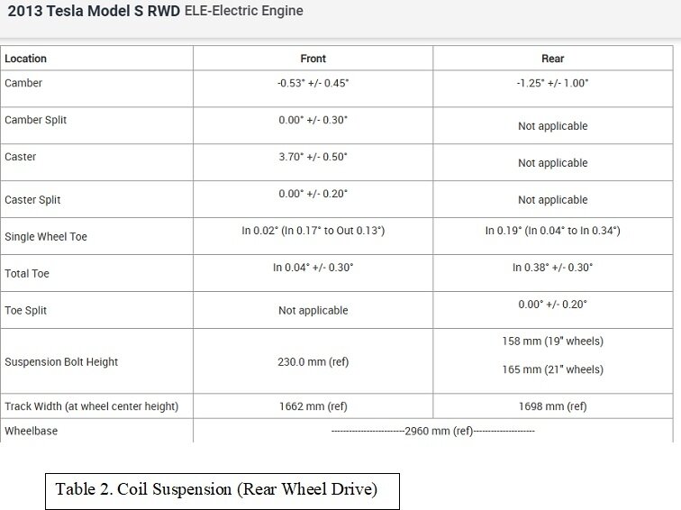

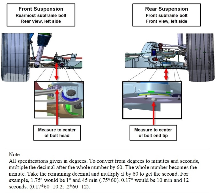

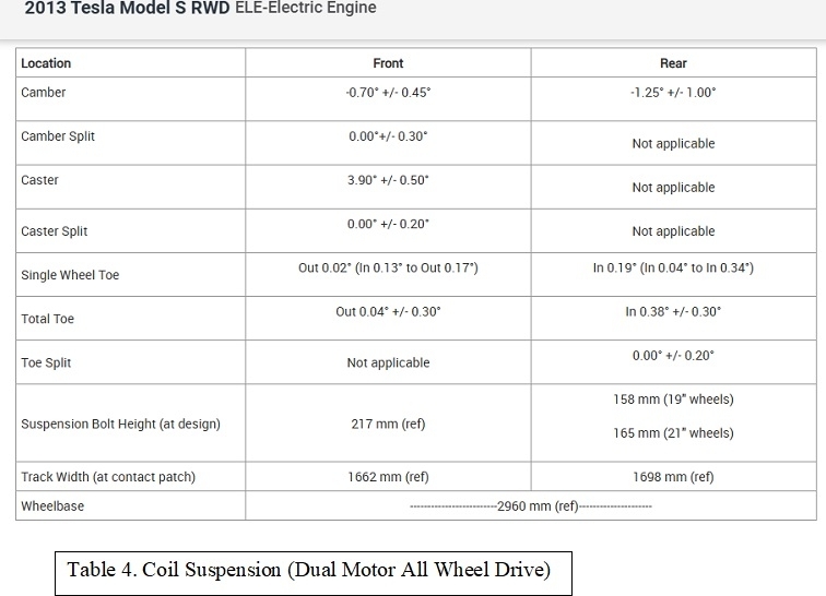

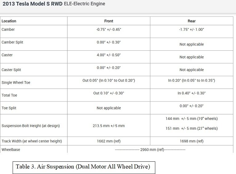

Where I would start is by measuring ride height. The specs are included in these images below. The ride height will take some work to interpret what they're looking for. You might instead consider visiting any tire and alignment shop for the height information. They all have small books that list every model and year, where to take the measurements, and what they should be. It looks to me like what they're asking you to do is the same as Chrysler's method where you take two readings per corner, then subtract one from the other to get the value. They do that indirect method because it eliminates the variable for different size tires. It's not important how high the car is off the ground. The readings we're after refer to the angle of the control arms, and the related geometric angles.
Measuring ride height is just the first preliminary step in the pre-alignment inspection. If chassis ride height is okay, it's okay to continue with the regular alignment check. All alignment computers have the capability of making printouts of the results. Sometimes you have to ask for that, but you must ask before the equipment is removed from the car, otherwise that data is lost. If you can get a copy that shows the "Before" and "After" readings, and post it in your reply, I can interpret the numbers for you.

Gotta start over. I overlooked one of the tables.
