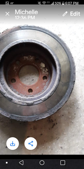

Well, I think I found the culprit. I was having the brake pads changed today front and rear and the passenger side rotor had a gouge in it on the inside and the drivers side pads were out on backwards like inside out. Never trust anything anyone says when buying used is what I've learned.
Apr 16, 2021 at 3:10 PM
Wow, good find.
Looks like you need to do some brake work.
